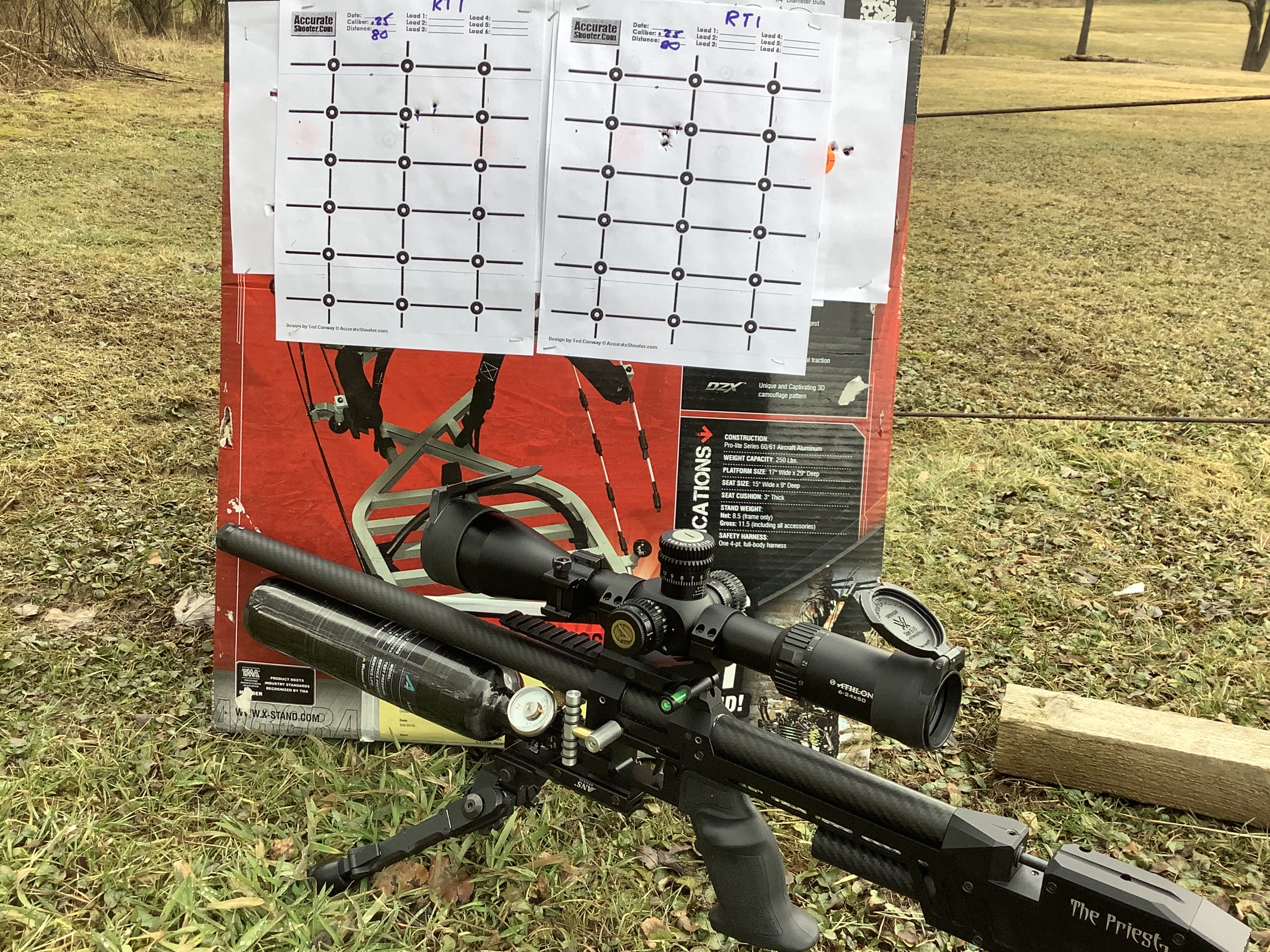

I highly doubt that a 20” 15mm solid barrel is going to give you harmonic problems in .177. But way back when they introduced the Priest ll, I bought one and immediately built a slug barrel for it. It was a .25. I drilled my receiver or block to accept grub screws to secure my shroud. They eventually did this when they introduced the Prophet. Just make sure you don’t drill through where the orings are. That will insure you don’t have an issue there. Not sure if I still have any pictures from then but I’ll check.
Found a pic. It’s a good thing to do no matter what. Then you know your shroud is not floating on those silly orings.
