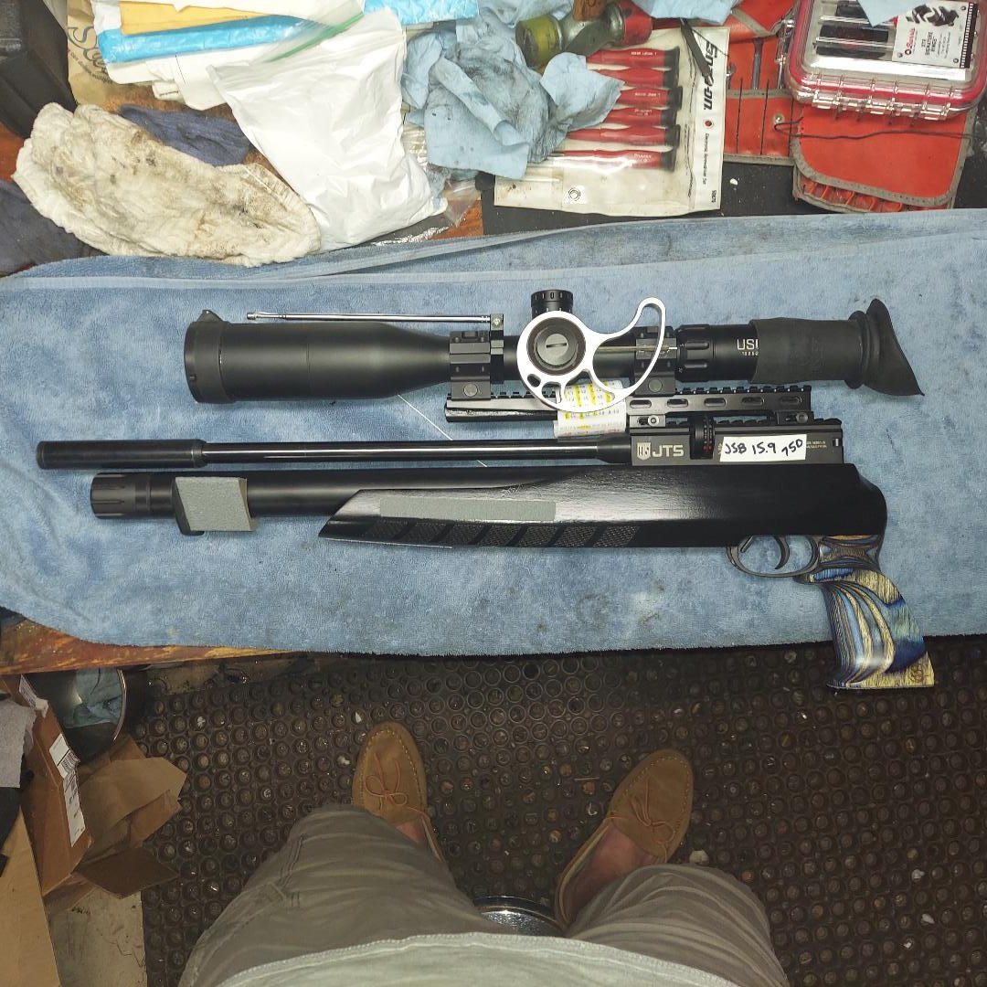

Pic #1 with stock barrel / shroud

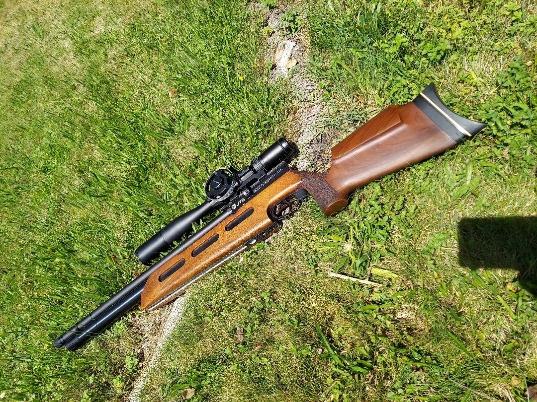

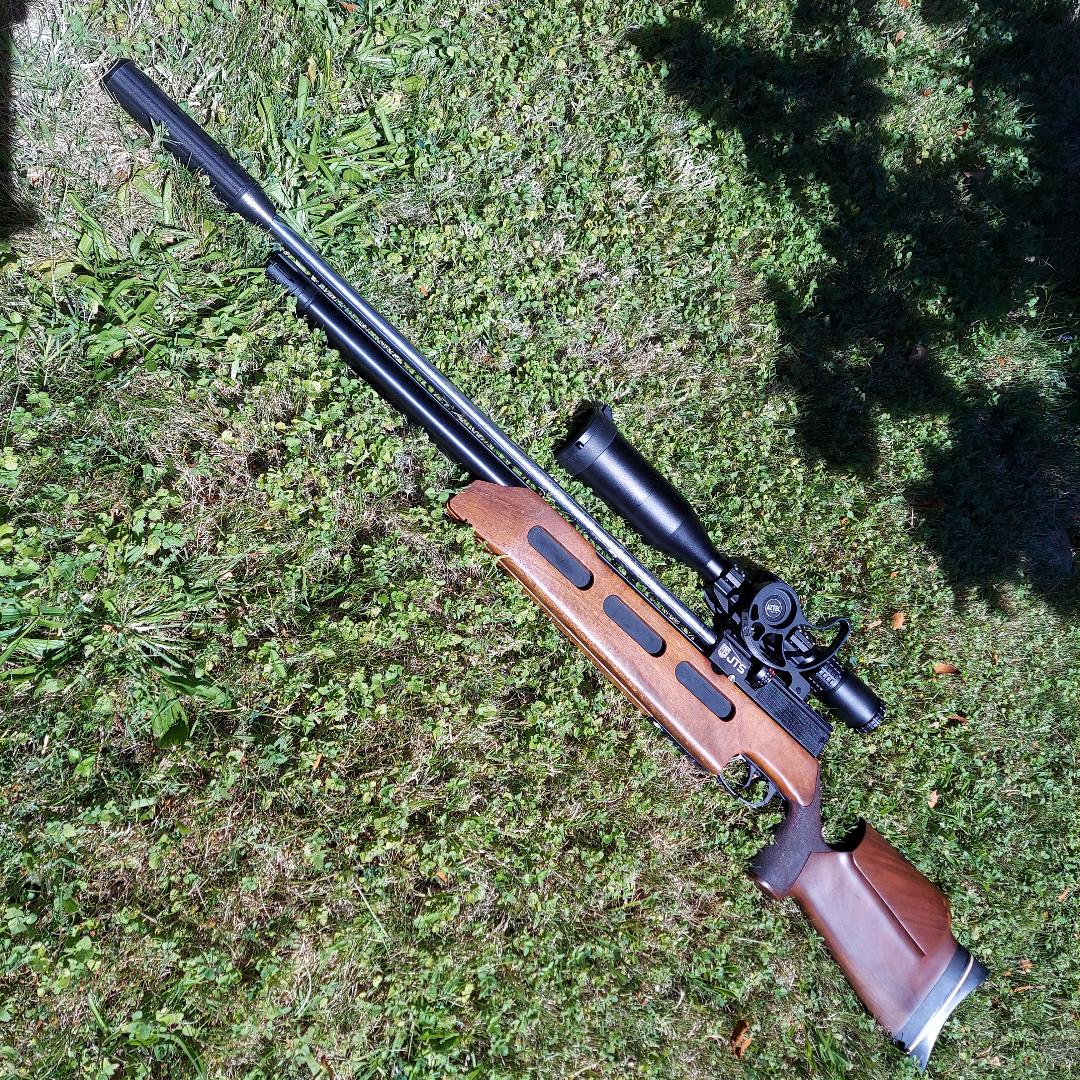

Pic #2 with new barrel & ldc fitted.
