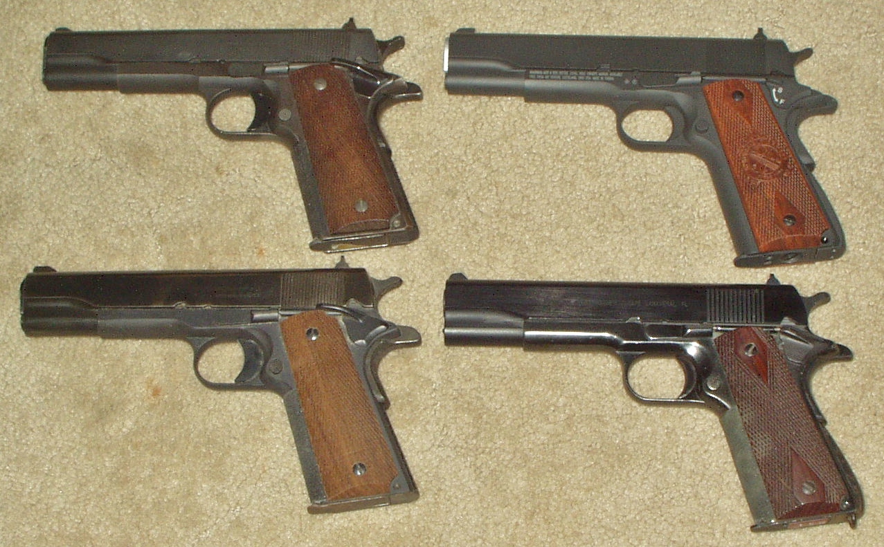

I went on a binge last year and bought a LOT of these guns, including the Springfield Mil-Spec 1911, P.38, Luger, CZ75, PPK, Smith & Wesson M29 (and the Springfield M1 carbine). After "accuracy" testing them all, I found they all perform about the same--I use 6" paper plates for targets, and all of these guns will keep all their shots in the "flat" portion of the plate, which is about 3.5", at 7-8 yards or so. After shooting a full CO2 cartridge worth of BBs at a target, I'll typically have a big "rat hole" of maybe an inch or a little more, with maybe 8 to 12 outliers distributed around the 3.5" plate flat. (I get 60 shots with the 1911, CZ75, and P.38, about 52-54 with the Luger, 90 with the M29, more than 80 with the PPK, and 45 with the M1 carbine.)
The key to finding happiness with these guns is to come up with a program that's "possible, but still challenging." They are just about perfect for rapid draw-and-shoot or point-and-shoot exercises with the 6" plates on a full-size silhouette at 7 yards. The idea is to get all your shots on the 3.5" plate flat as quickly as possible. You're building valuable "muscle memory" with every point-and-shoot drill.
The 1911 Mil-Spec is my favorite of all the pistols. It has sights and trigger almost identical to my "house gun" 1911. The triggers on the others aren't that authentic.
The only photo of targets I have loaded up on the puter right now are for the S&W M29, but will give you a rough idea of the accuracy of these guns.
Will be glad to answer any specific questions you have about any of them.
