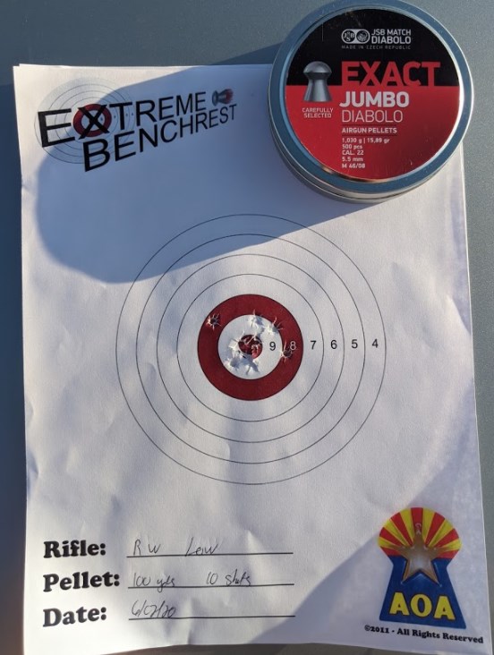

I've shot them at paper out to 100 yards at a starting fpe of 28-29.
They didn't do so well. The wind was really grabbing them, much more noticeably than the regular JSB 15.89s. They also seems to take a lot longer to get there, like they're stripping fps FAST.
Here is the comparison, shot back to back so very similar wind conditions.
And it wasn't a bad pellet/barrel combination b/c the Hades did nice little bugholes at 55 and under yards.
