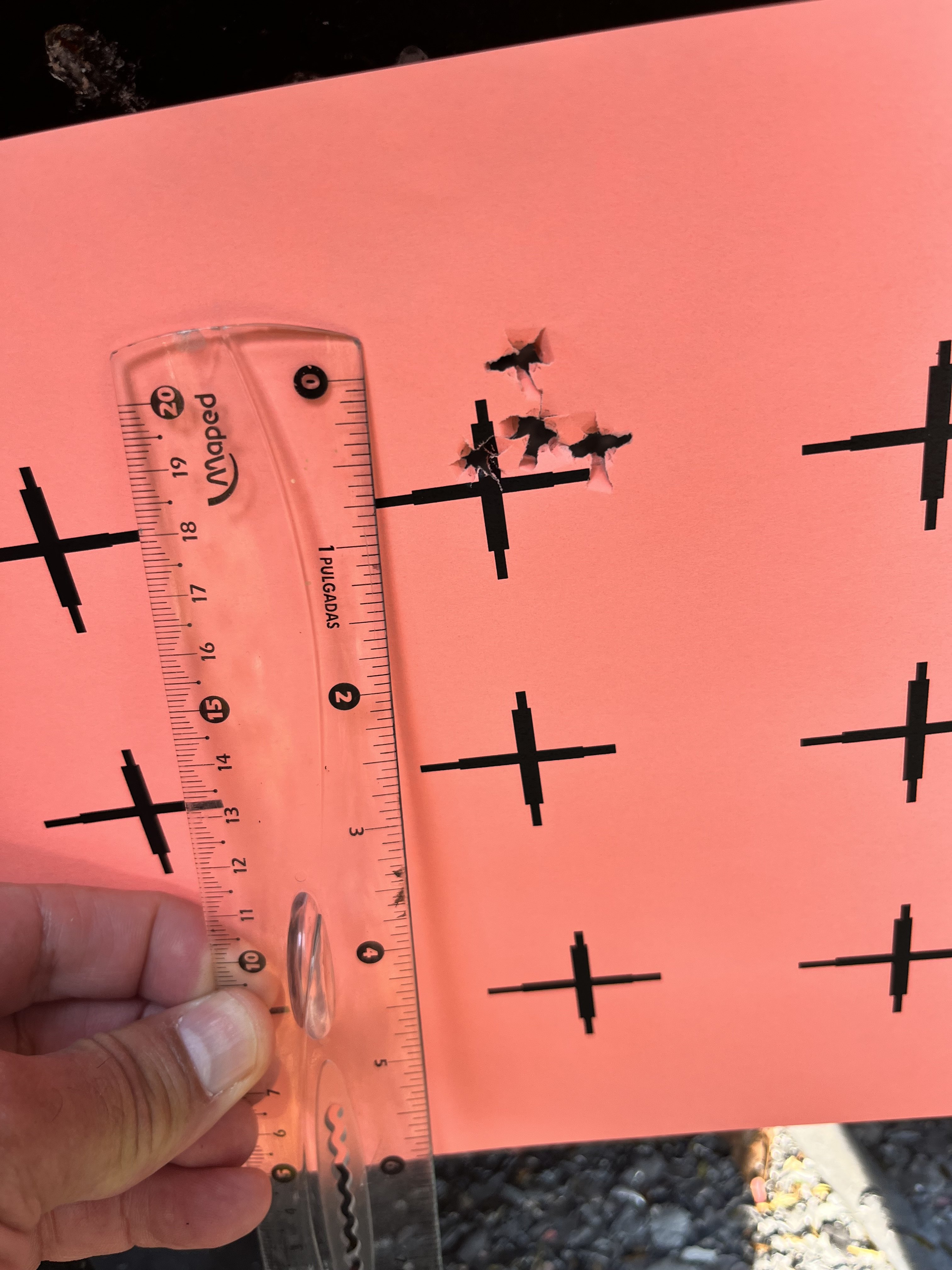

Daystate rifles, Airgun Technology rilfes, Sidewinder rifles, FX rifles, Brocock Ghost, can easily make you make groups the size of a ten cents coin at 50 yards an a quarter at 90 yards.
Of course there could be other rifles that can achieve that.
In my experience .30 Cal can deal much better with wind. But without wind my Revere an my Vulcan 3 in .177 can easily achieve those groups at that distance.
You need to learn how to pull the trigger. You do not need a bipod, just a rest and a comfortable chair that help you to have your right elbow risen (if you are right handed).
Not too difficult to improve, just practice. I am not saying you will defeat champions of this forum, but for sure you will notice improvement on your groups.
Look at this group at 88 yards. This is where I am in my shooting now:
