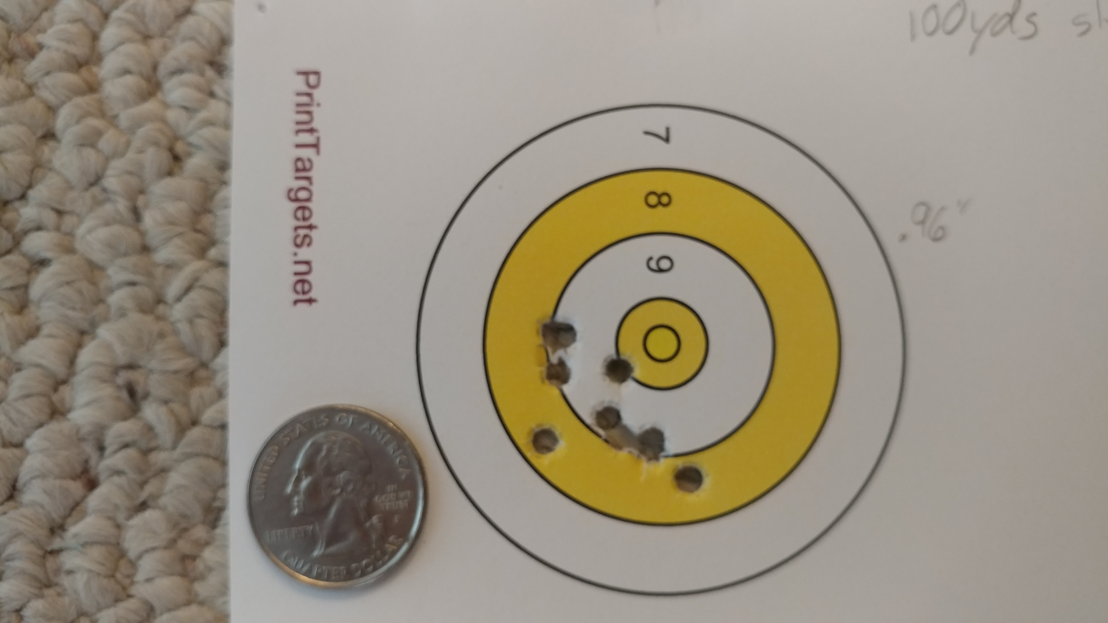

How accurate do you think this is for 100 yards in almost calm conditions?

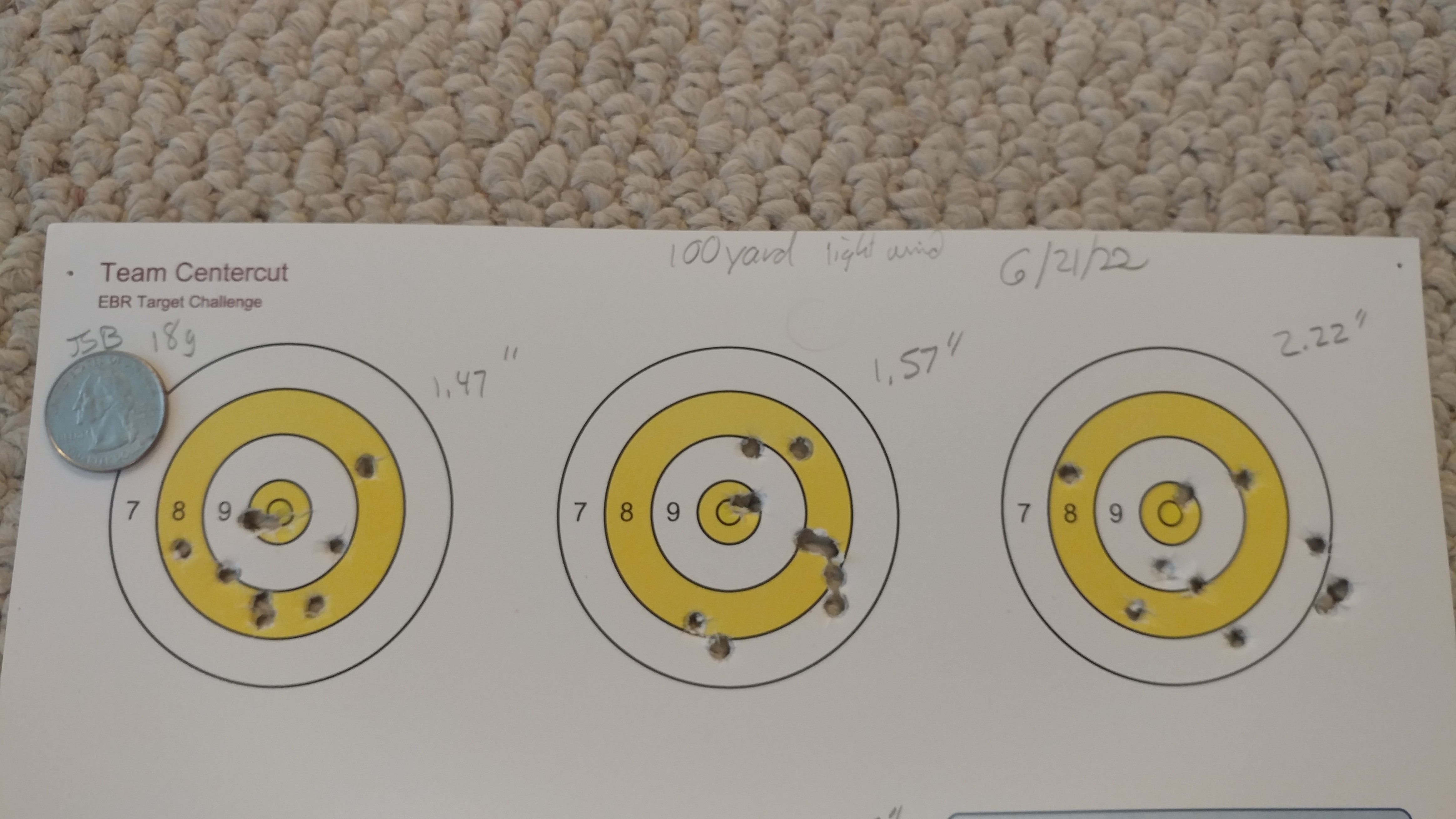

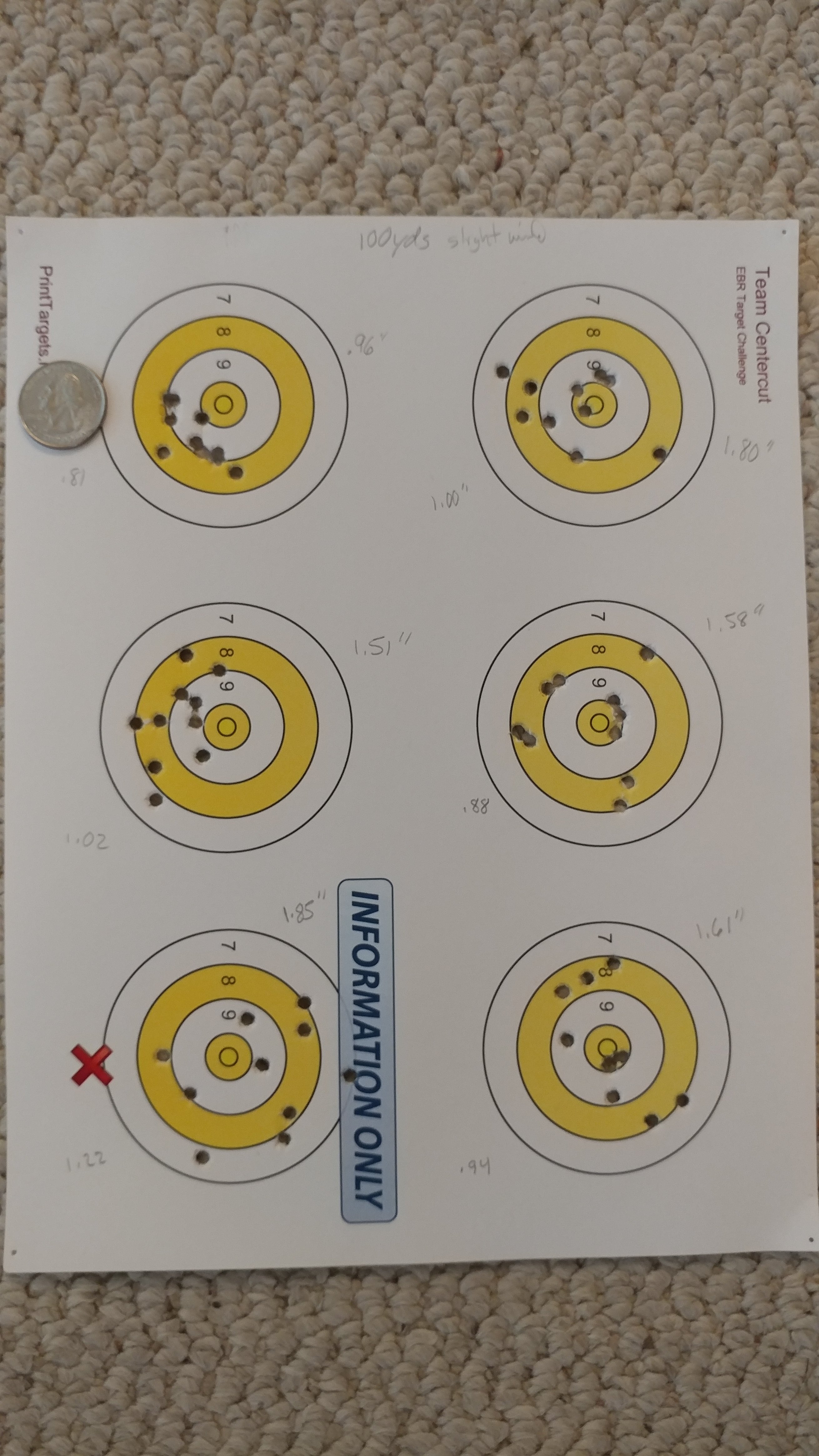

I shot this target today in very slight breeze(almost calm). 10 shots at 100 yards:
The numbers to the right of each target are c-t-c group sizes for those 10 shots at that target. Numbers to the left of each target is distances from POA(center of the bull) to center of outermost hole. To me, it seems like this represents 100 yard accuracy(under these specific conditions) of a little over 2"(1.02" away from POA); meaning that I could reasonably expect to hit a 2.04" target most of the time, under these conditions. Would that be correct?

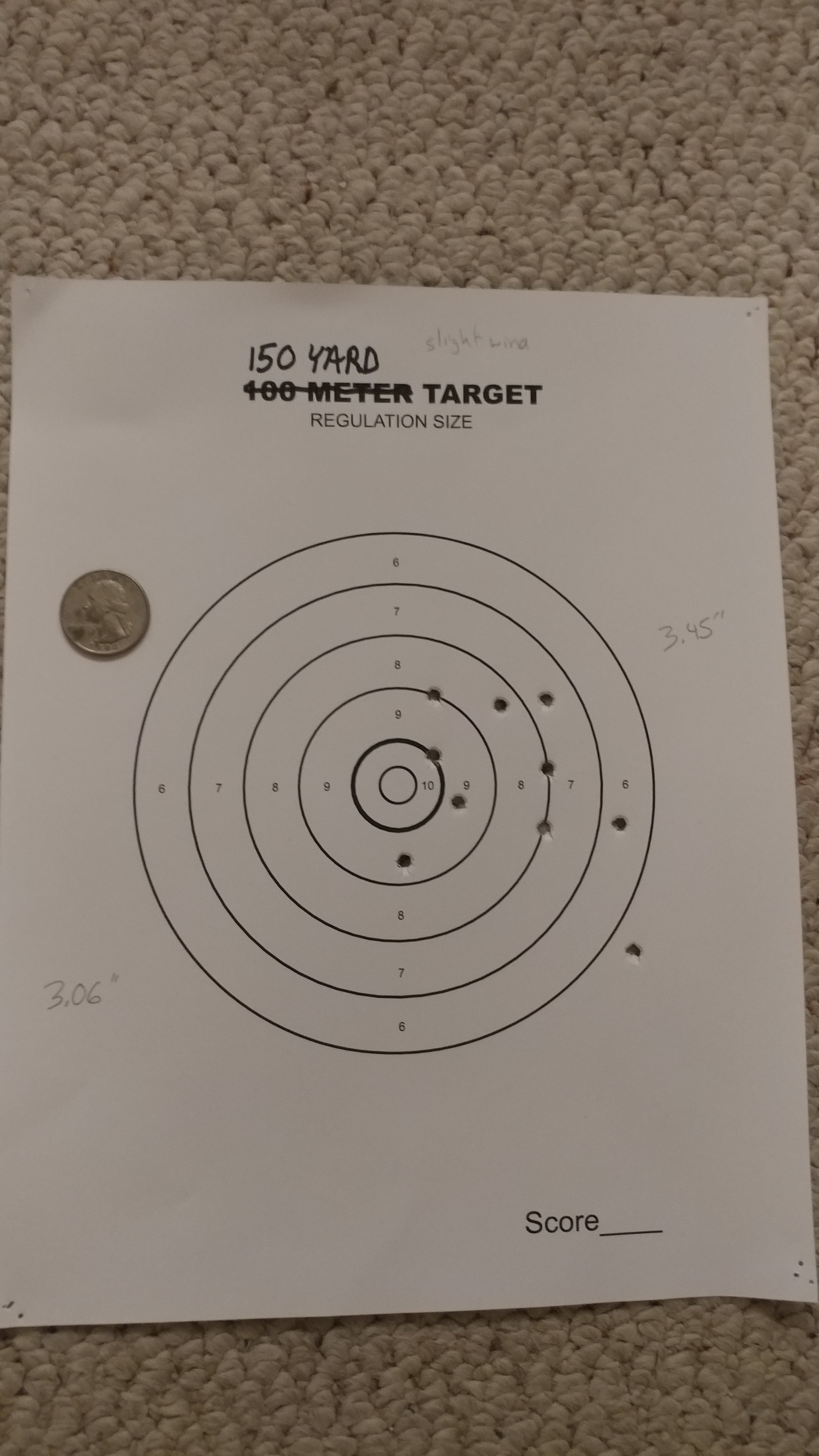

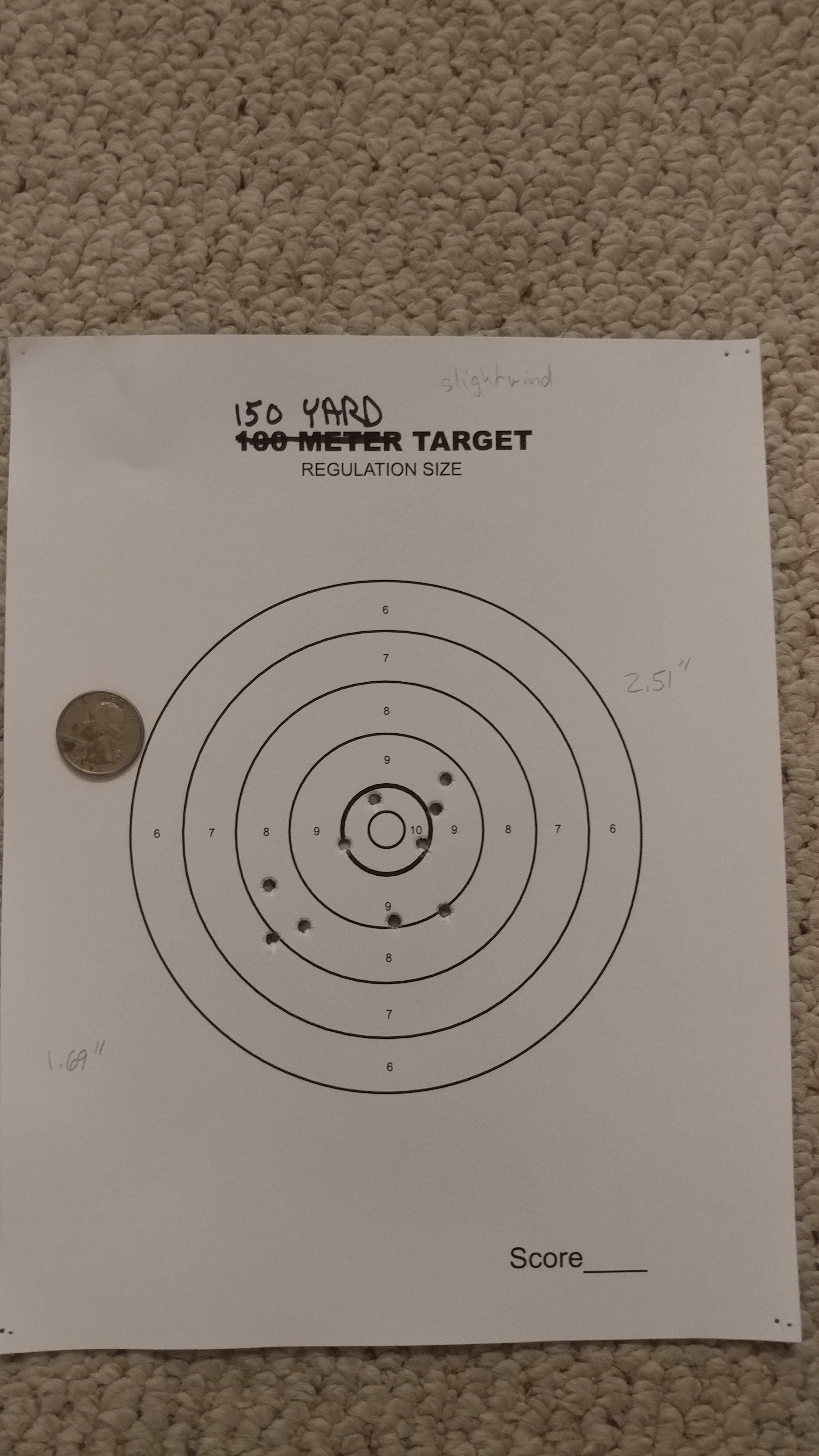

I just shot these 2 at 150 yards. Even though I have shot smaller groups at 150 yards the consistent accuracy isn't there. Small sample size, but judging from the size of the groups and distance away from POA on these 2 targets, I'd be doing good to be able to hit a 6" gong most of the time at 150 yards in those conditions. Things seem to fall apart somewhere between 125 and 150 yards(probably run outta BC).
I don't see the slug weight or speed in your post. I had a Crown in .22 and it wasn't able to get 25.39 Knockouts to go fast enough with a 600mm barrel and they wouldn't stabilize and the groups were similar to yours. Max FPS was only 893 with hammer spring & port maxed and reg at 150. Your 18.1 pellet group should be much tighter and it may be that they are running too fast. Around 850-875 would be ideal for those pellets and they should easily cluster under an inch at 100 yds. Just my experience with the rifle I had, your setup may be much different.

A couple thoughts....
First off, you're shooting 10 shot groups. Not often to see anybody sharing 10 shot groups at 100 yards, with slugs or pellets. So, your groups are already statistically going to be larger than all the cherrypickers showing up with their 100 yard sub-moa 5 shot group and trying to act like that is just the norm for their rig.
So does everybody agree that this is NOT a 100 yard sub-MOA gun/scope/ammo combo, even though it DID shoot 1 ten shot group that was sub-MOA at 100 yards?
And would you agree that this IS a 100 yard 2 MOA gun/scope/ammo under these conditions?
Yes, I agree there. There was mathematical discussion shared on here a few weeks ago, I think it was linked by Utah airguns, but was originally by Bryan Litz, It basically explains the statistics behind what you said (that I just quoted) and what Mike Nisch also alluded to a few comments ago.
I started this thread over a year ago, questioning the trend towards slugs and the FACT that the slug shooters weren't shooting better scores at 100 yard Xtreme Field Target. https://www.airgunnation.com/threads/the-trend-towards-slugs.923817/
Well, it's been roughly 18 months since that post, with many monthly matches, and we still aren't seeing slugs outshoot the high BC pellets. Part of that is the fact that folks rarely show up to shoot slugs, but part of that is also the fact that folks are rarely brave enough to show up to shoot slugs. I wonder why? ;)
I've said it before, I'm not anti-slug and would love to see a big leap in external ballistics capabilities for the airgun shooting hobby, But I have not seen the huge benefits of slugs that seems to be such a prevalent claim on the airgun forums these days. On paper, yes, slugs should be better. But you still gotta hit what you're aiming at for it to count.
So, back to the original question.....I think your 100 yard slug groups in calm conditions are not better than what most guys are CLAMING, but are likely MUCH, MUCH, MUCH better than what most guys are actually shooting. And if somebody wants to fight the "slugs are better" argument, please start with showing us 5 or 6, 10 shot groups at 100 yards like the OP did.
