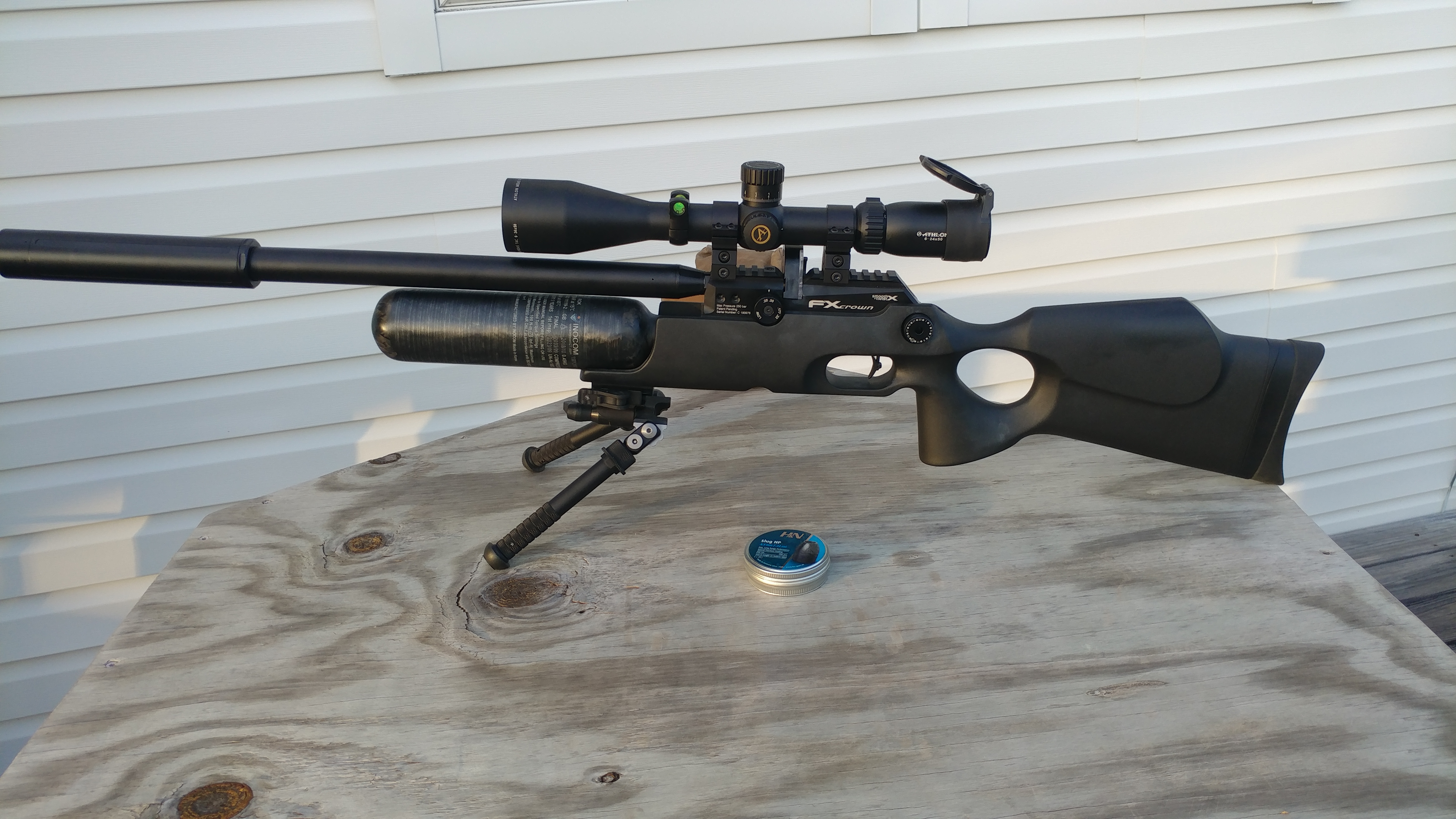

100 yards NSA 24.8 .218 1015 fps
Fx maverick 700mm .22 superior liner

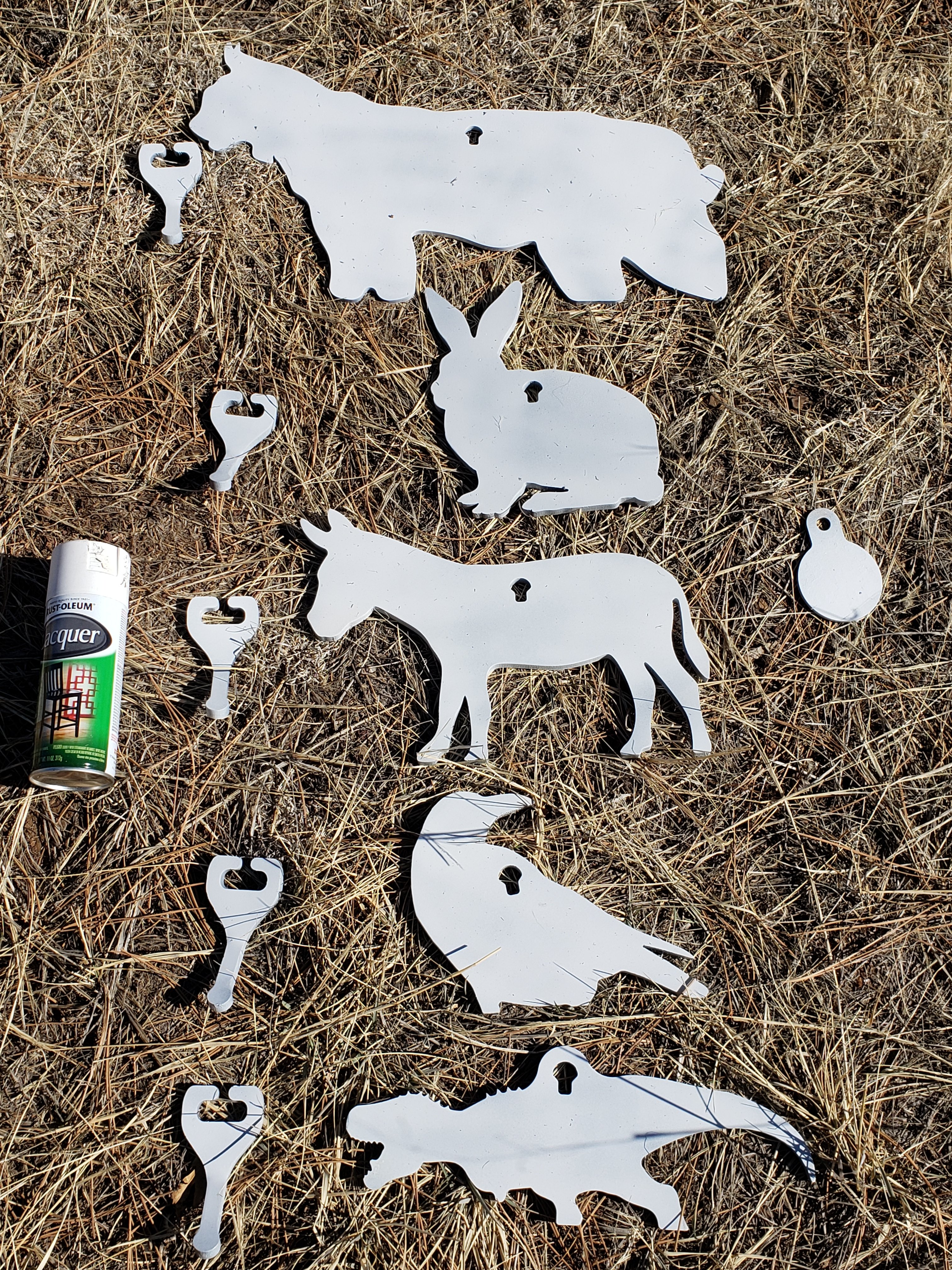

Last Wednesday I was concentrating mostly on a 200Y steel donkey using the same HPX and slugs. It's almost 5" from belly to back and about 12" wide. The wind was blowing but was pretty consistent. Out of around 40+ shots I missed it maybe 5-7 times, not sure exactly but it wasn't much.
If I were using 25.4gr RDM's I would have hit it only a few times.
The T-rex at 125Y and the crow at 150Y were easy to hit so I ding em a few times then move out further.
2 weeks ago I was shooting at a steel coyote at 250Y that isn't in this photo and its about the same size as this bobcat. I hit it 80-85% of the time. I used to have the donkey at 250Y but it was too hard to hit consistently. Literally a few inches makes a big difference out there using my gun and slugs. If I shot pellets at 250Y it'd be luck if I connected.

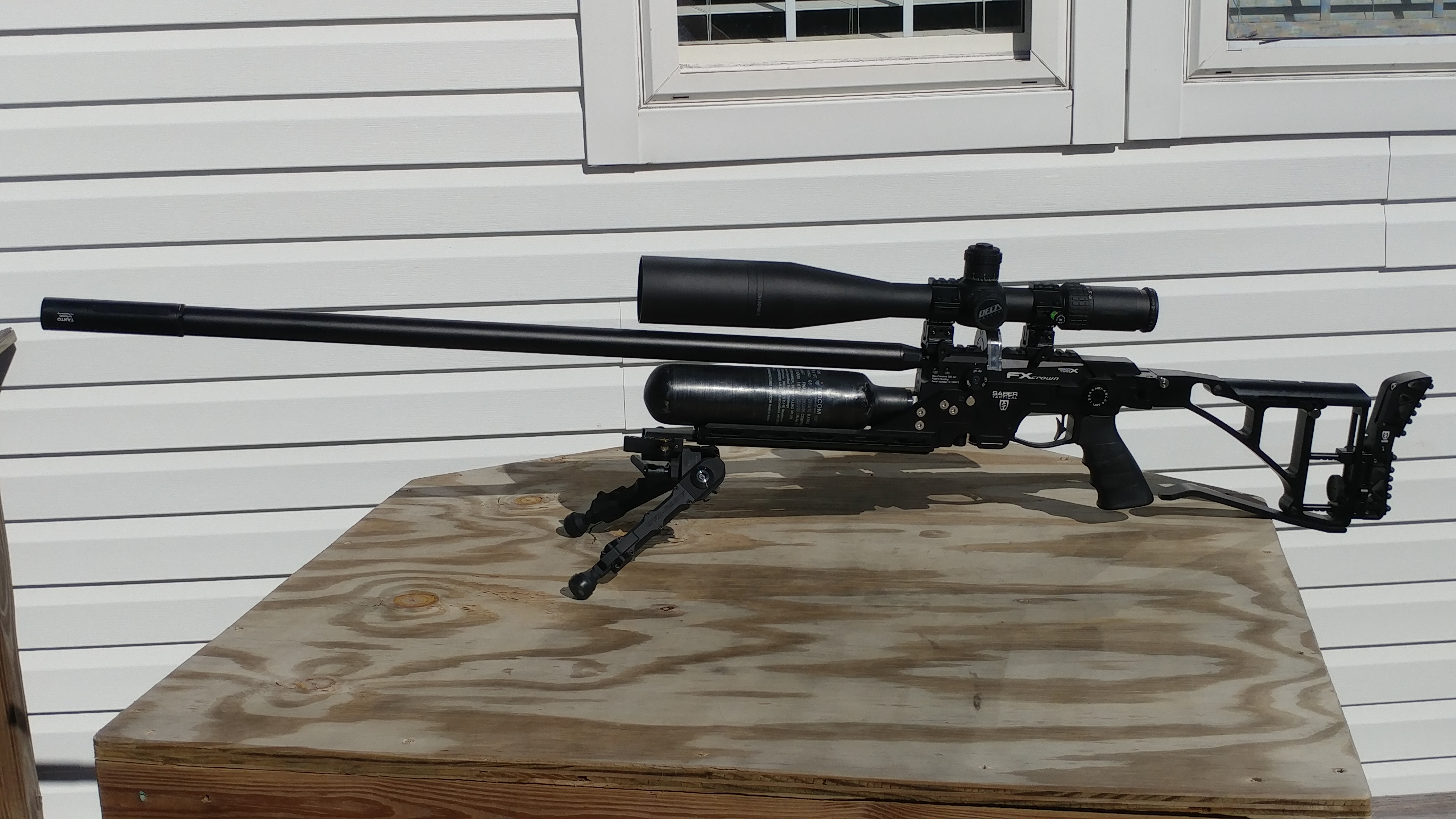

I have a couple of Crowns(see attached pics).
Crown#1- MK2 w/700mm in ST chassis shoots MRDs @975fps. Good performance for 50 and 100 yard targets in moderate winds( 0 to 8 mph), but is long, cumbersome, and I only have a few tins of MRDs that shoot relatively well. It also shoots KOs at 968fps, and it the most accurate Crown I have from 135 to 250 yards(closer than that, not so much).
More to follow...
Reactions: Centercut

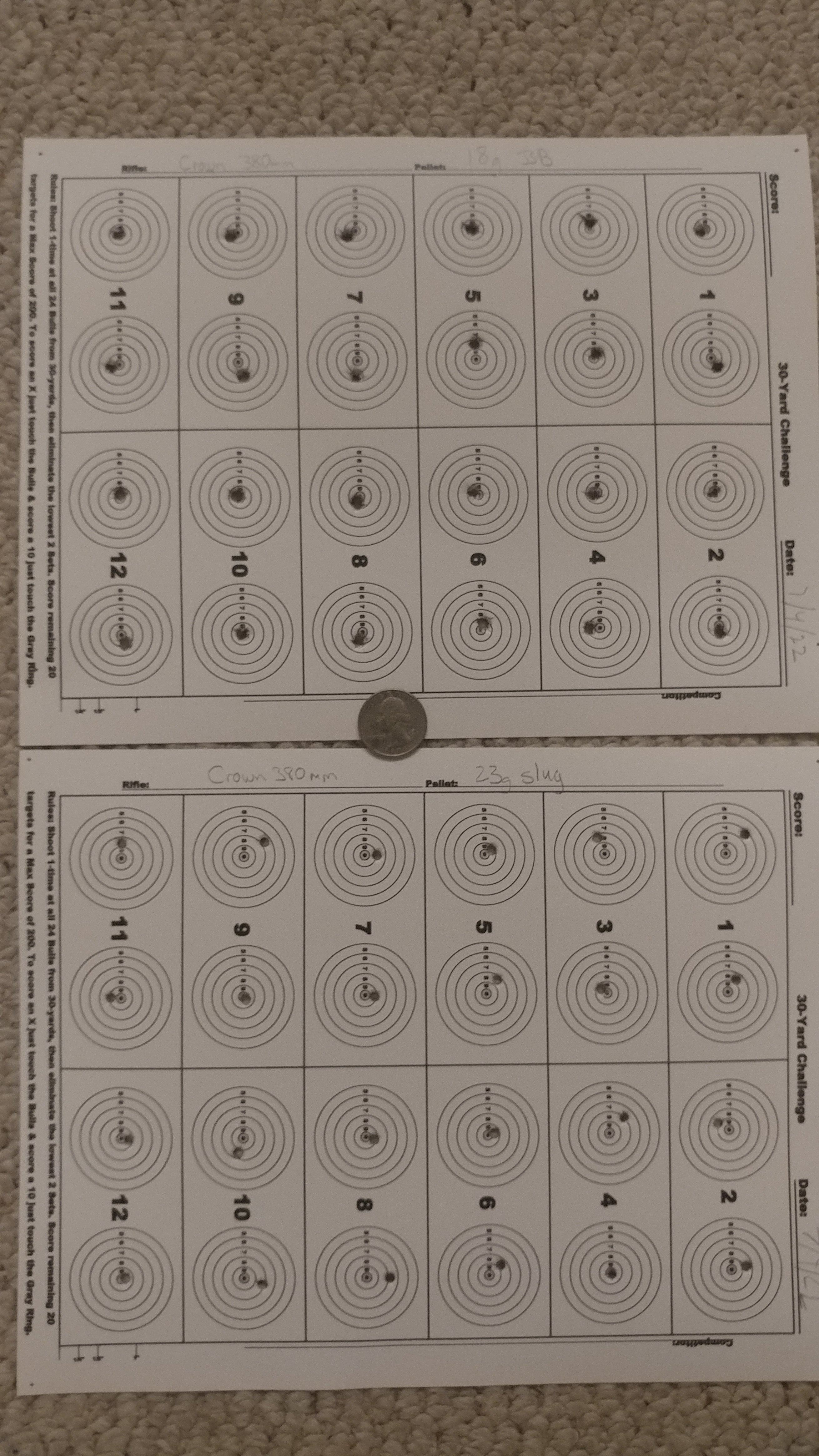

Crown #2- MK1 w/380mm shooting H&N 21g slugs @ 873fps. It is my most consistent rig(no reg creep, Athlon scope clicks are exactly on the dot) and my most consistently accurate from 25 to 125yards in light winds(0 to 4mph). I have tested it's consistency every month for over a year.
It also shoots JSB 18g @ 875fps(I have to lower hammerspring wheel) very precisely from 10 to 85 yards in slight wind(0-3mph).
Which brings us to the target I posted was shot by ...
Crown#3- Mk2 in ST chassis w/380mm(or 500mm) barrel that I'm trying turn into something in between the 1st two Crowns that could be used as longer range(or in windier conditions) target gun or for PRS style shooting. The target was H&N 23g slugs at 890 fps.
I was also wondering what is a reasonable expectation of accuracy, assuming the single target I provided was representative of many others like it(which it was). I've read and heard about "MOA guns" and that "if ya wanna be competitive, ya gotta start with an MOA gun". From my experience so far(which is very limited), learning what the wind does at the place where you are shooting, AND being able to find which tools(wind flags, strings, sighters, etc...) give you the best information about what the wind is doing to your projectile down range in real time seems like a FAR bigger variable than the absolute accuracy of the gun. However, I feel like a higher BC(while not giving up TOO much precision) will allow for more error on a wind call, which is what I'm moving towards.
"Why doesn't this guy just get an Impact and start shooting 40g slugs and be done with it"? Fair enough question, but I don't care for bullpups, or ALL the rig-a-ma-rolls that come with owning(and working on) an Impact. Plus I have .22 powderburners for that level of shooting(which do a FAR better job, imo).

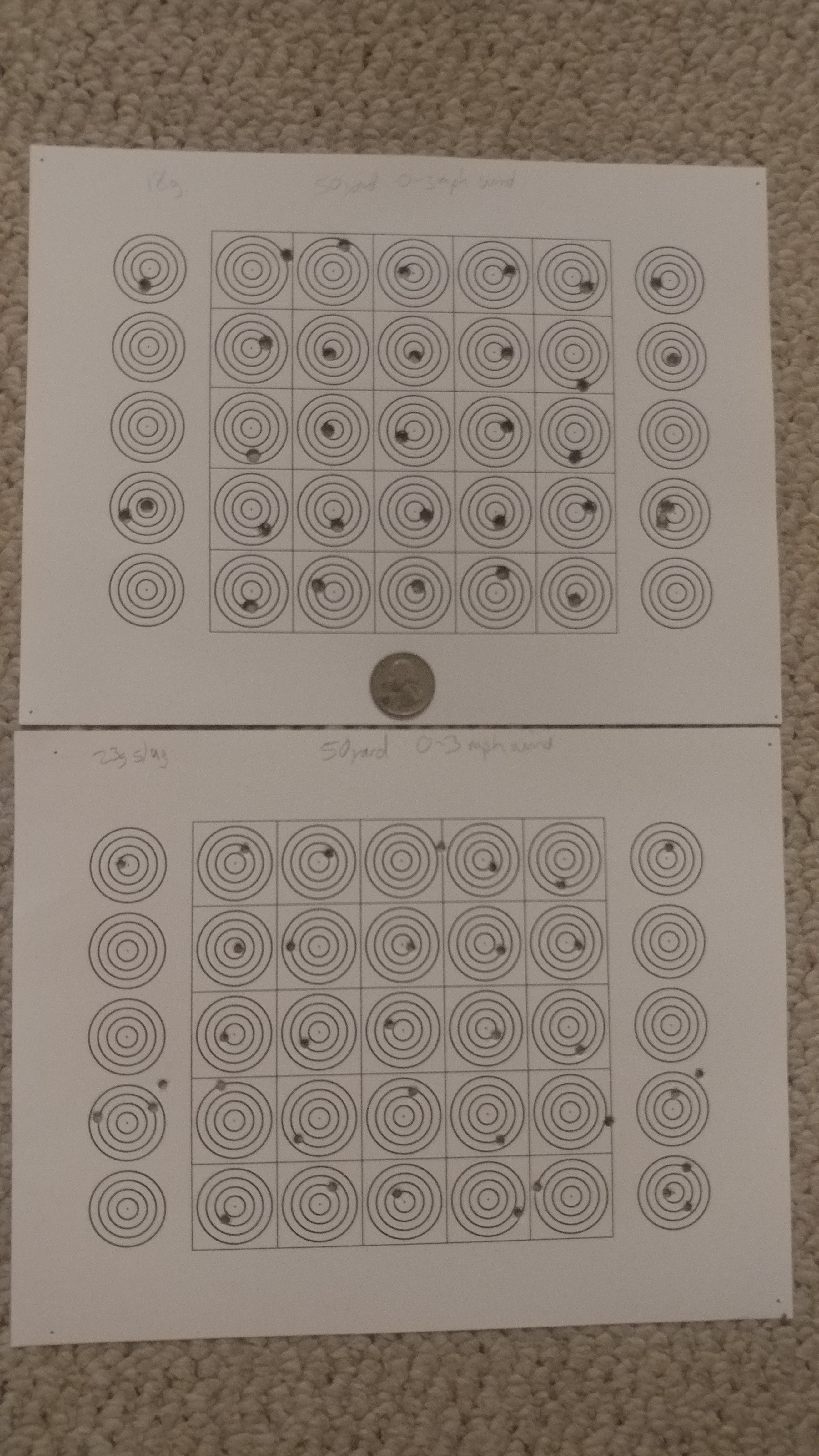

I shot a few "pellet vs slug" comparison targets at 30, 50, and 75 yards in light wind. These are pretty representative of results of comparisons I've done in the past, in light wind. I didn't score them, but pellets seemed a lot easier to get closer to the bull more often than the slugs at 30 and 50. It kind of felt like they started "equalling out" on the 75 yard target, but I would still give the nod to the pellet.
