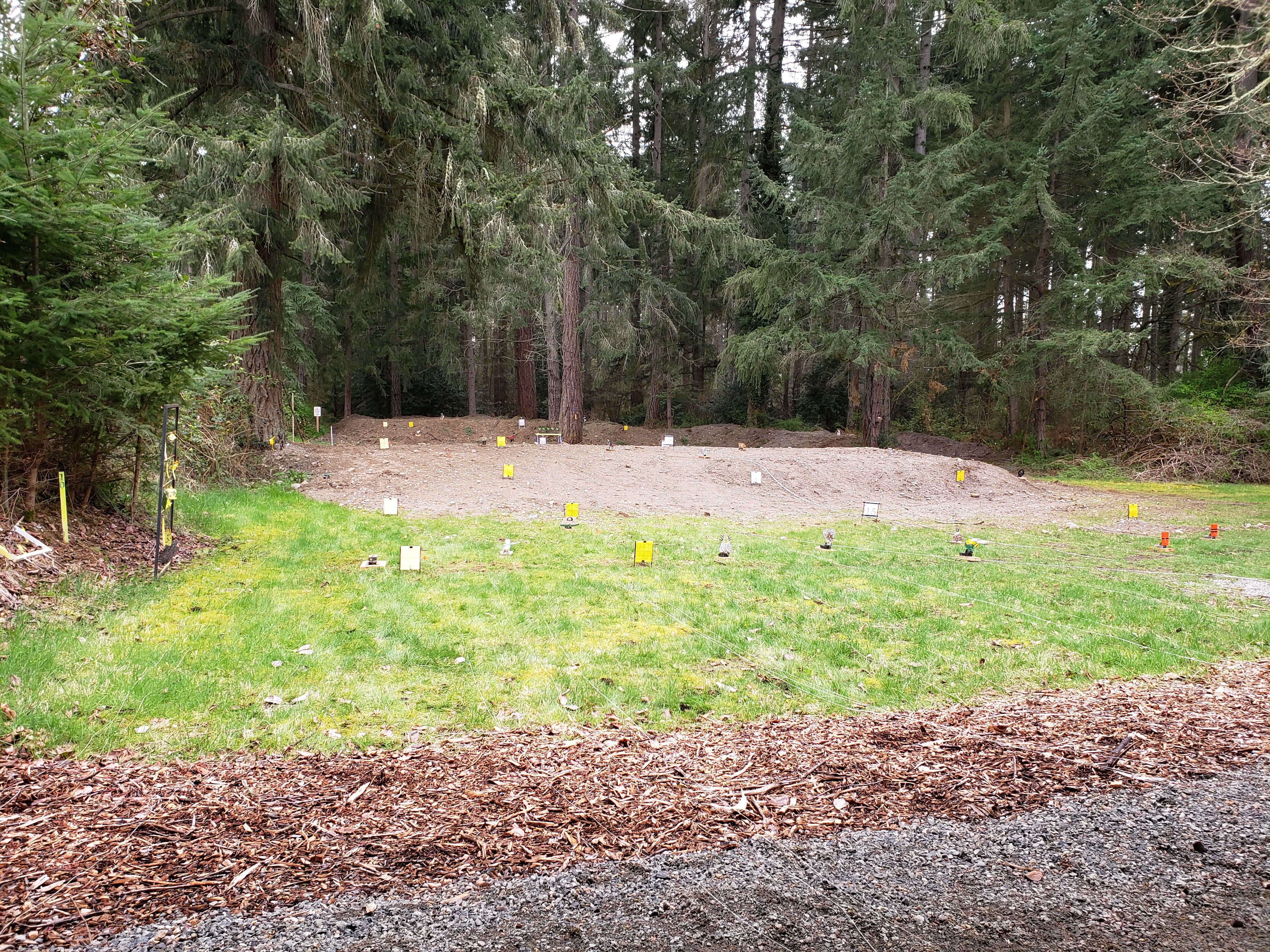

Us MD's would do no such thing as hide the wee ones ( 3/8" ) from the shooters !!!
We place right up front and even show you where to aim ... Lol
Those 50-55 shots we even make sure you stay focused on the task not shooting the small hole but the large one ... Lol

Oh , let me confirm, those 3/8" targets were on the course today! And placed at 10 1/2 yards, or 11 1/2 yards. It made for a great challenge.

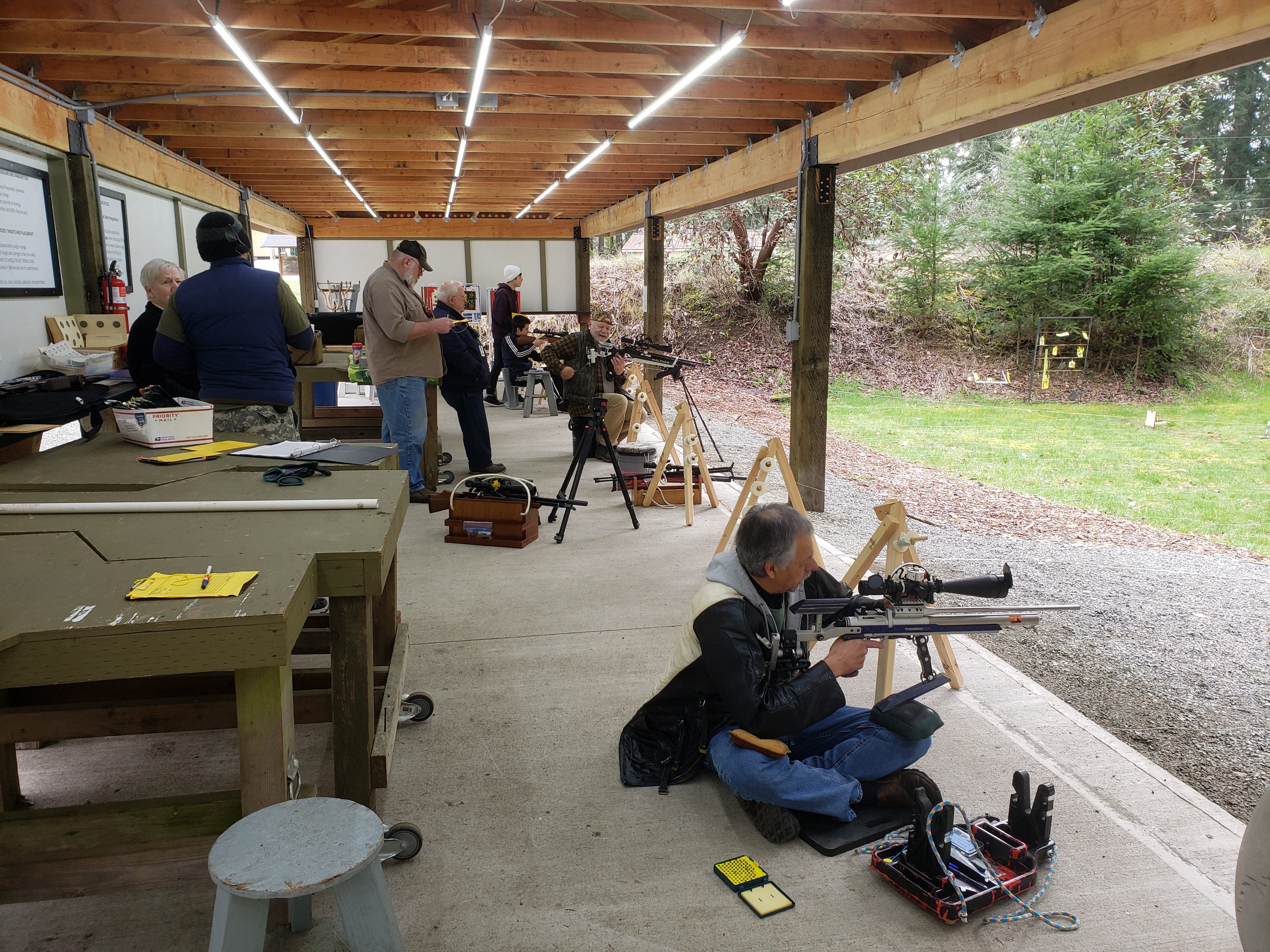

I am thinking back to this Saturdays match( especially about the missed shots!) And I'm pretty sure there was a 1/4" target in the mix. Possibly a rattle snake or wasp nest target. The match was shot on the airgun range from under cover as the Tacoma weather just could make up its mind. This picture is grainy, but gives a general idea of the match layout at TRRC. Hopefully next months match has better weather and gets everybody out on the course in the woods. And maybe Bob(the OP) will be ready to shoot!
