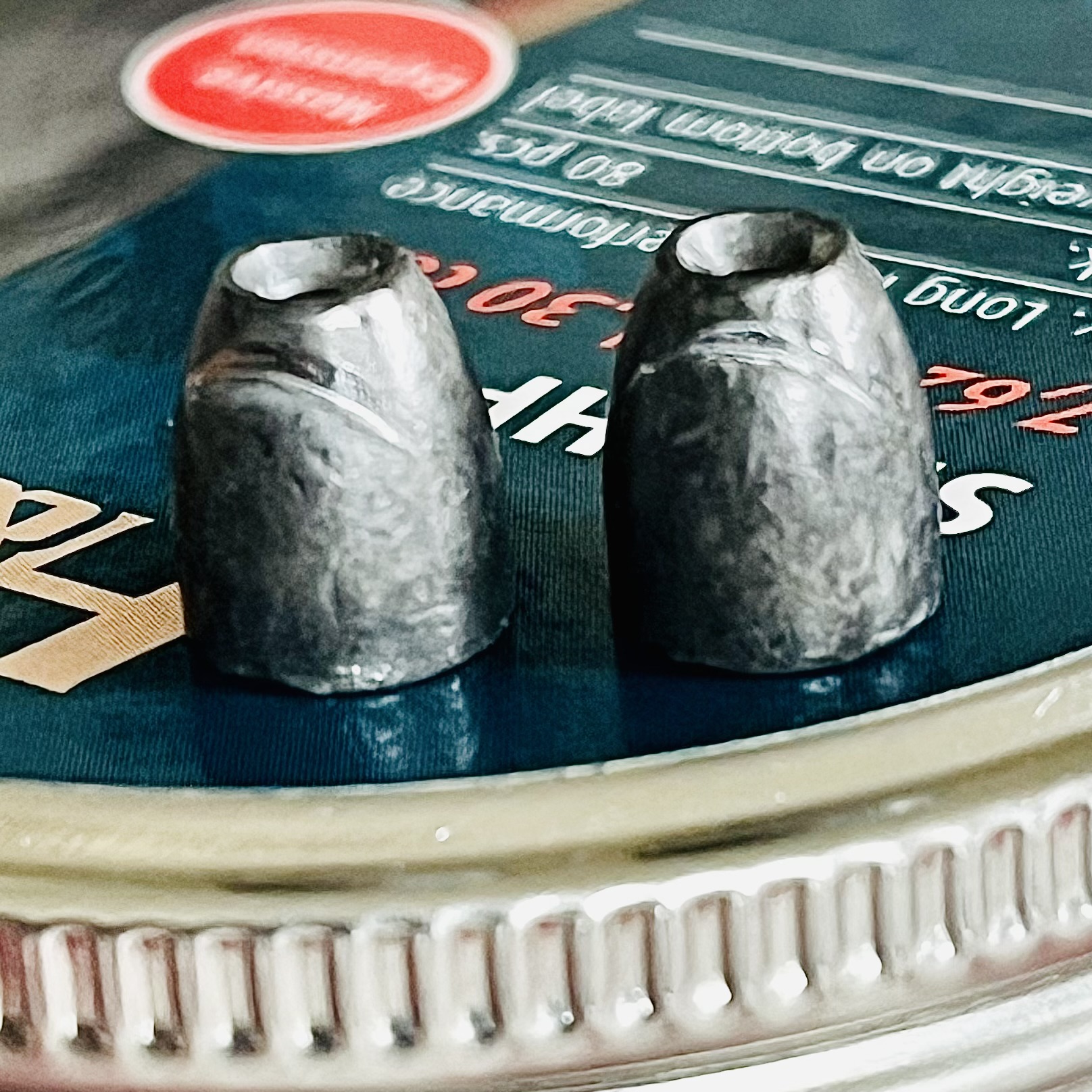

Are those slugs falling into a hugely cut transfer port? Doesn't seem like there would be that much in the barrel for them to get a curved indention like that.
I can only comment on the 30 cal. But when it was happening to me years ago I thought I needed a new breech section that had a "bridge" over the transfer port hole because it looked like gravity was just tipping the nose of the slug down into the hole. I never bought the "bridge" type breech section. It turns out that the bridge thing is (in my opinion) just a band-aid to make up for the fact that FX didn't deburr the transfer port hole edges and complimented that with a cheek rest that kept the magazine from seating. The smiley faces on Golani's slugs are a clear indication of the size of the stock round transfer port hole on that 30 cal. I made some smiley-faced slugs just like Golani's before I solved my jamming issues. After my fix, all slugs chamber smoothly and have for years.
