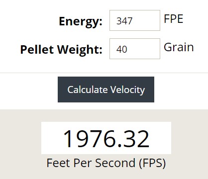

So then it would be: 0.049*4350*39/24=347
So a .25 cal shot with 4350 psi from a 39" barrel has an output of 347 foot pounds of energy to push the projectile with.
I found a FPE to FPS calculator on airgundepot.
It's probably not the correct way to calculate as I'm guessing the above math calculates the force pushing the projectile and not the fpe of the projectile?
