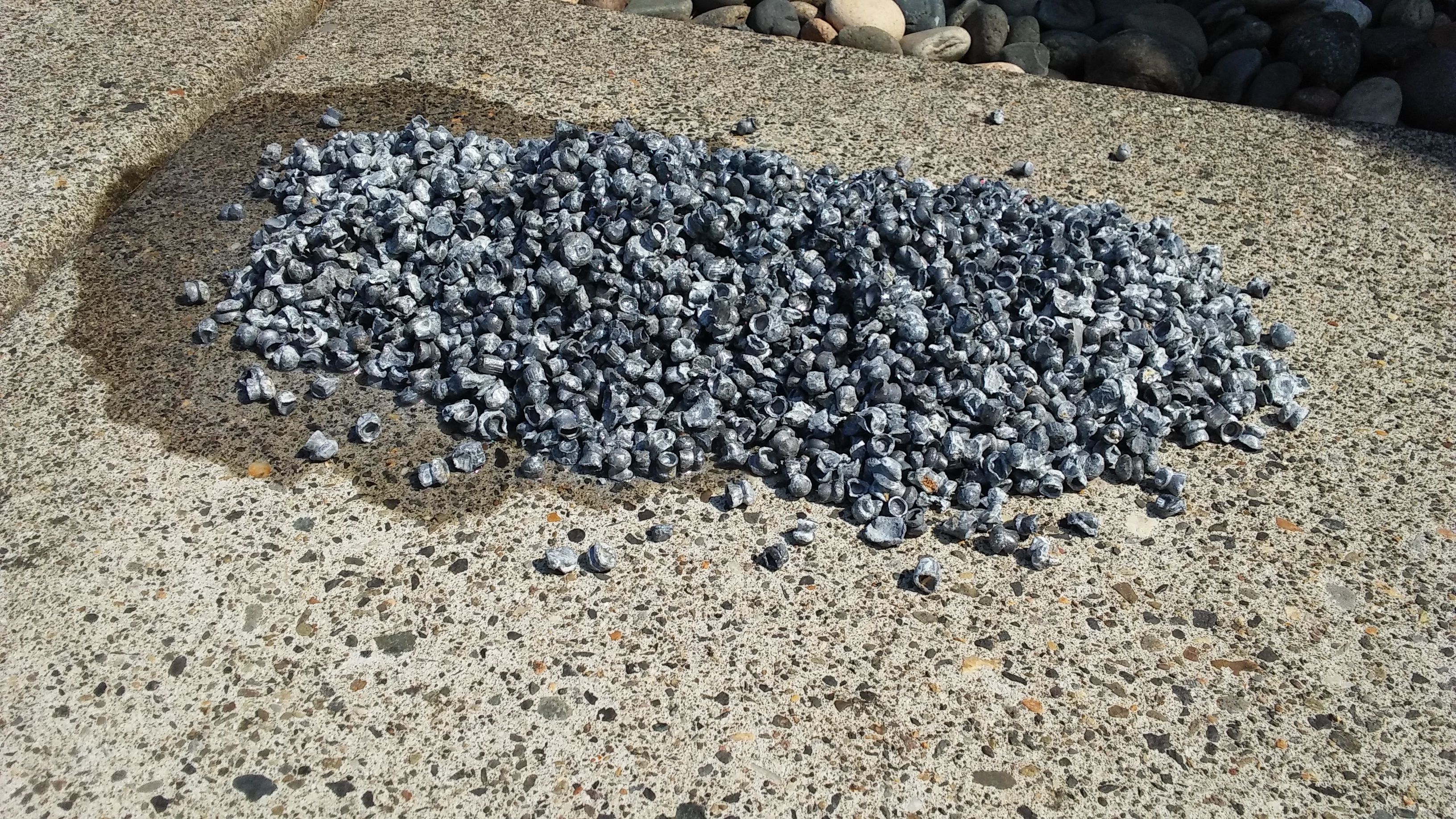

Dump the pellet trap on your back porch or garage floor or other smooth concrete surface. Then go get your leaf blower. The blower will move the mulch MUCH more readily than the pellets so blow the mulch away from the pellets and you can reuse it. I melt down the pellets into 1 lb lead bars I plan to use to cast my own pellets later. You could probably also just bag it and sell it to a metals recycler. Or the recycling center near me has a metal bin you could throw the pellets into. Key thing is the leaf blower will separate things very rapidly and easily for you.

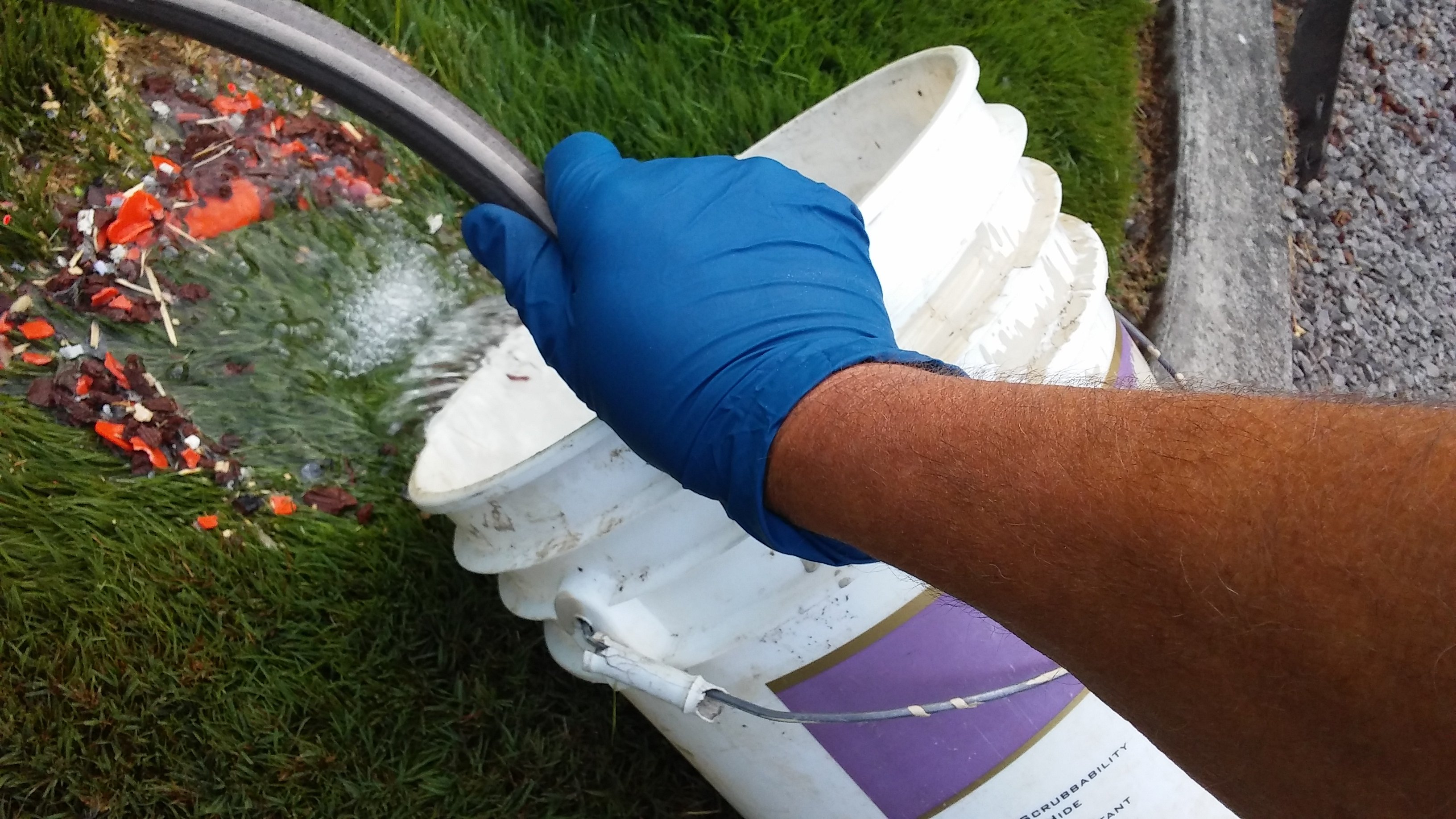

fill a 5 gal bucket 1/4 full with mulch - then lay it on it's side about 1/2" to 1" off the ground - then with a hose shoot water in to the bucket - the mulch will be forced out and lead stays at the bottom very friggun simple
I have a big plastic storage box I use for a tagert. Holds 3 bags of rubber mulch. Conveniently the box actually is the same size as the bag so I can just put three bags stacked and the cover it. I hadn't cleaned it for about 2 years and finally realized it was near 150 lbs in weight. I tried to separate it, but the task became overwhelming due to how much lead was in there - and all the carboard and paper bits and pieces. I tried the water thing in a bucket and ended up with a sludge mix. Ended up just throwing it all in the garbage and getting two more bags of mulch - the back third one didn't have any entries even with shooting some pretty high fpe stuff into from time to time.
