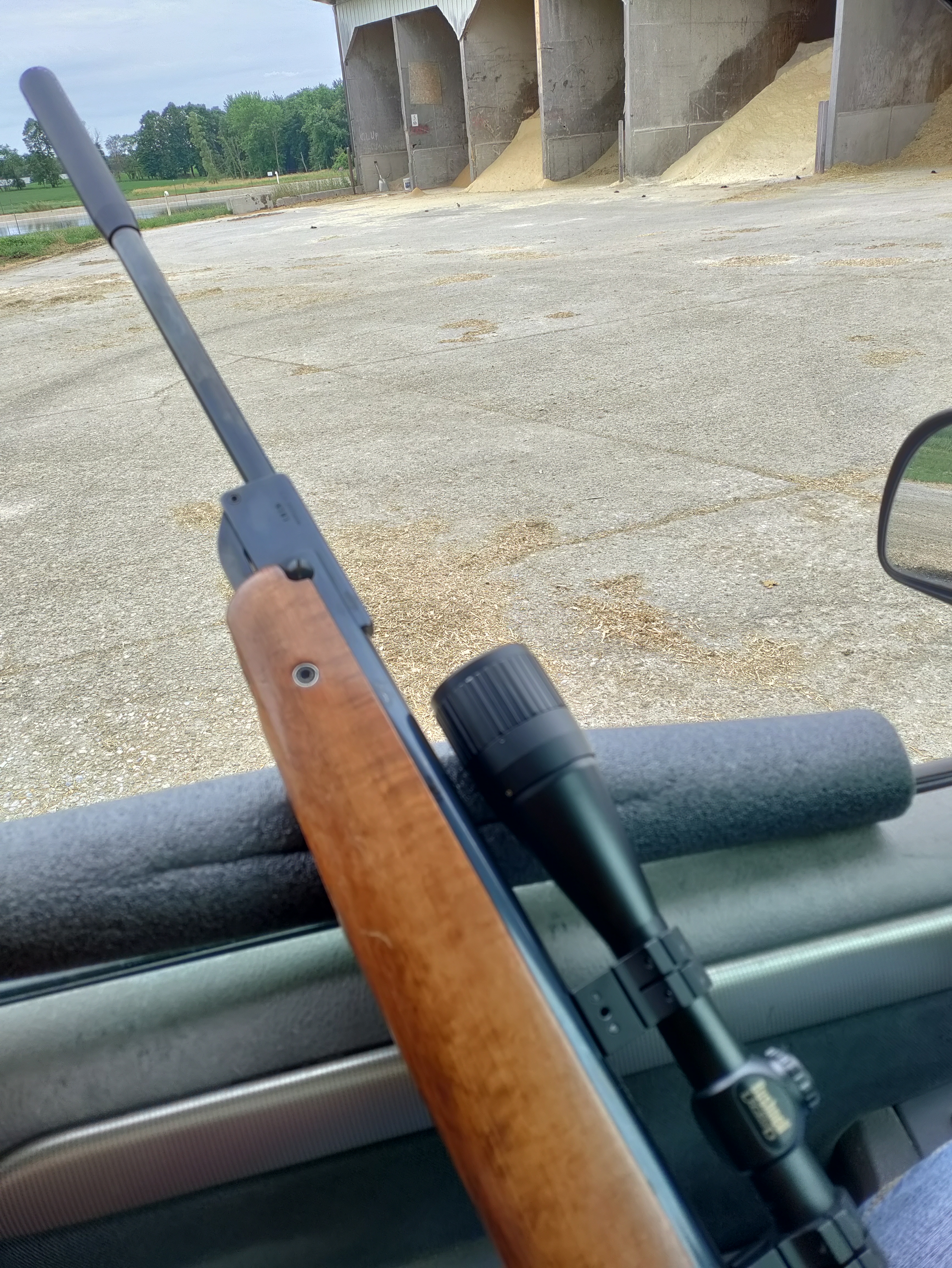

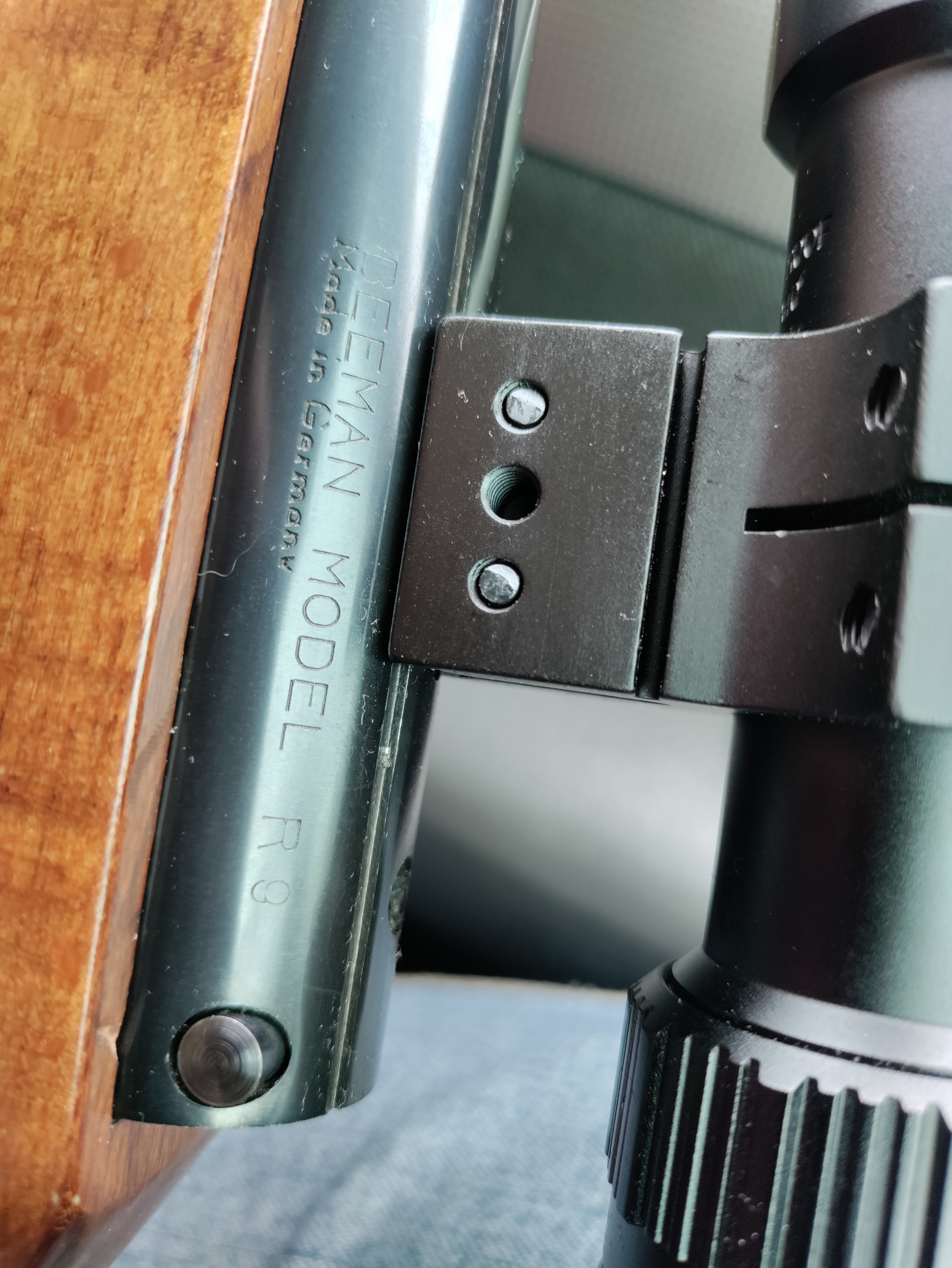

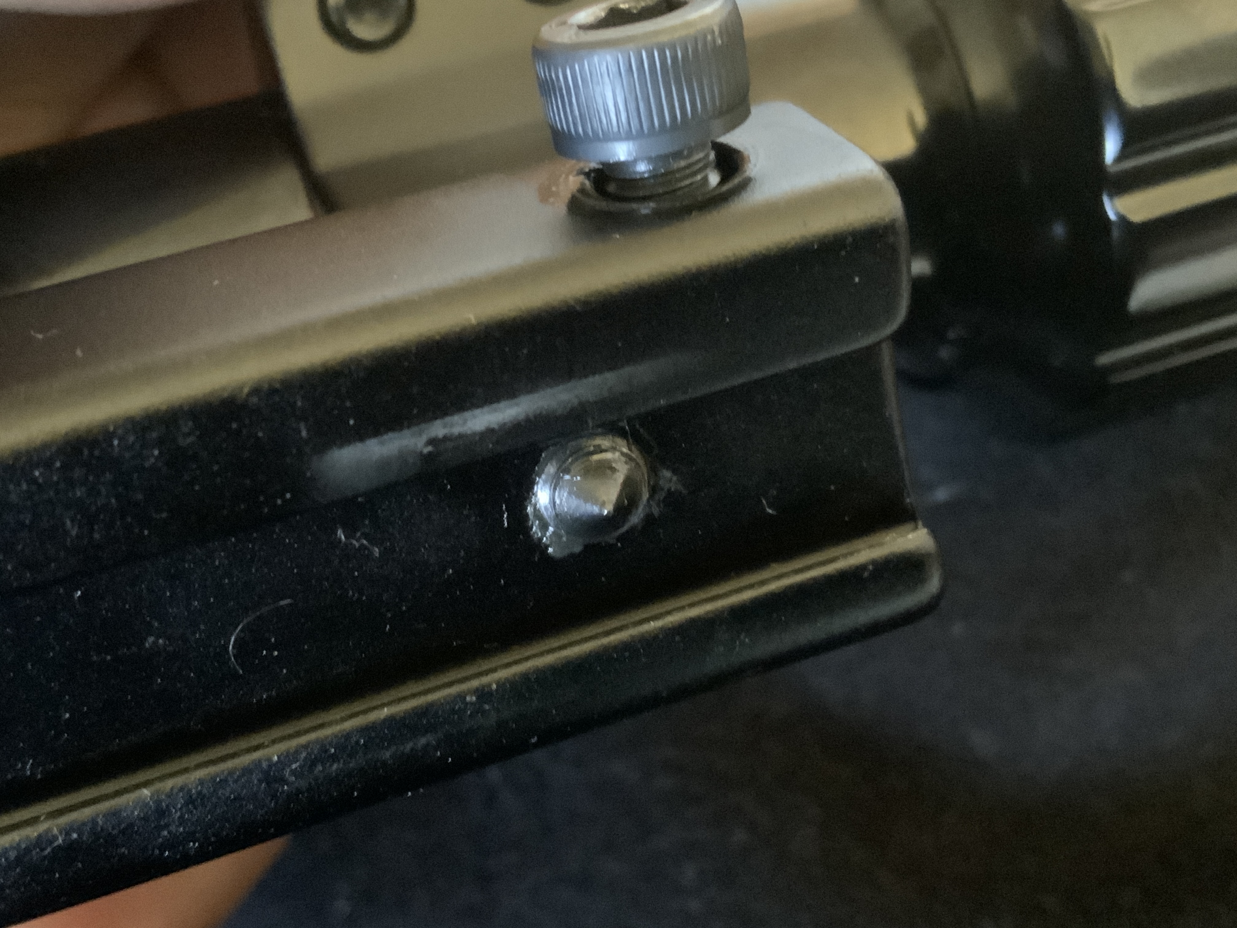

Bad mounts? I’m using Hawke 1 piece mounts. 4-12x40 Bushnell scope. It hurts my soul to see this. So the question here is what are the best mounts for magnum springers?

HW95Flatten out the pointy bit of the stop pin so that it can't ramp up the side maybe? What gun is this?

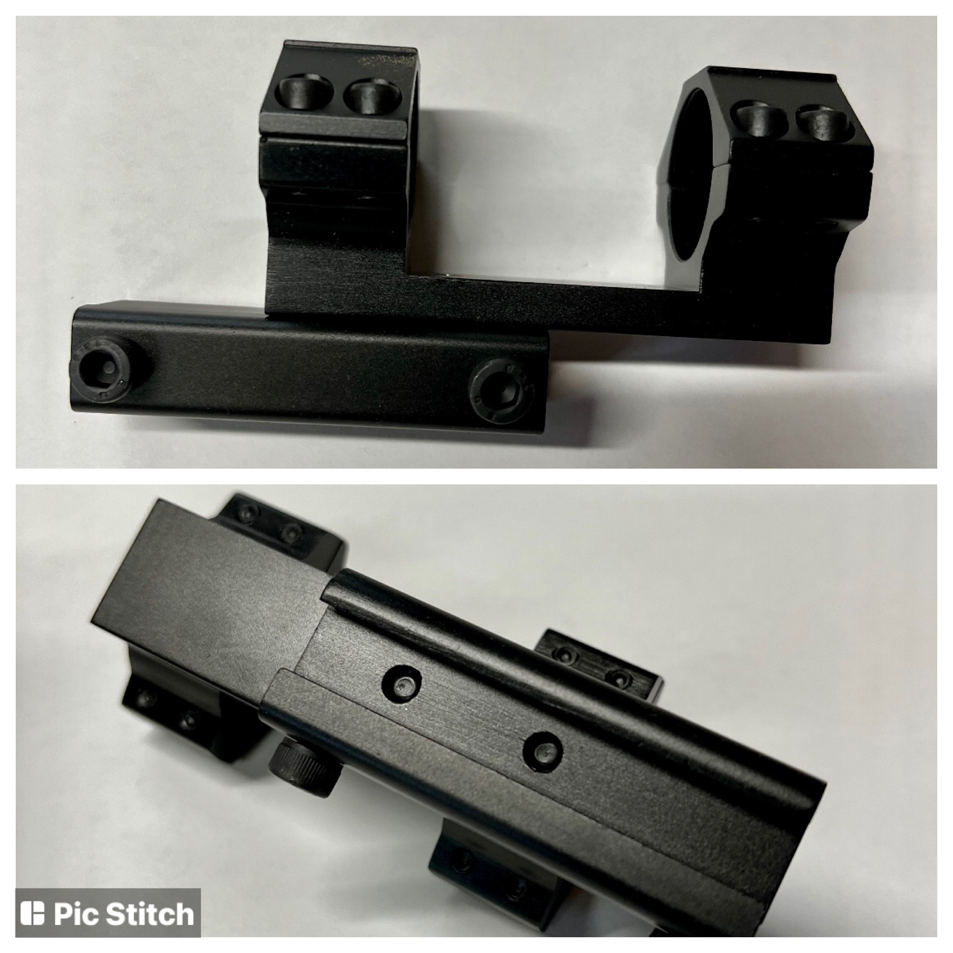

Yeah man, sorry for the damage it caused. It seems like that is just a poor design for a stop pin. I use the UTG one piece mounts pretty exclusively and have never had that issue on any of my HWs. Luckily they are pretty cheap.HW95
Which model is the 2 pin UTG you have?I am so sorry for you. What a terrible design for a stop pin. There is very little room on the the new build Weihrauch’s with the internal metal sleeve. When starting to tighten the mounting screws just barely snug them. Then check the stop pin by tightening to light pressure making certain it is in the hole by sliding the mount back and forth in the hole. Then bring the mount rearward to the hole and tighten to quite snug. Then tighten the mounting screws. Degrease all parts and use a drop of Loctite. The one piece mount I use is the UTG. It has two stop pins that match the Weihrauch‘s spacing.
So off topic here but I'm drooling over that stock and would love to know who made itI use Hawke mounts on most of my rifles and as already mentioned, I take a small file and file that point off. All it does is make the mount try to slide out of the hole as you've already found.
Also can't argue the BKL double strap rings since they're what I bought when I upgraded the stock on my own HW95 and wanted silver rings to go along with the silver in the adjustable cheek rest and butt pad that came on the new stock.
It looks like it's a stock from Craftsman Vit.So off topic here but I'm drooling over that stock and would love to know who made it
It is but I sent Sqwirl a PM to try and not disrupt the threadIt looks like it's a stock from Craftsman Vit.
