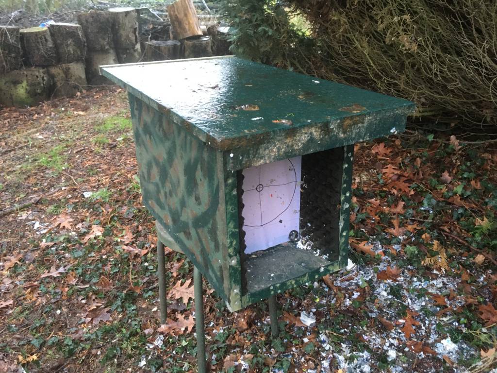

I built this one from 3/4" plywood , with a removable lid. About 24"long , front is 12"X14". I put a metal frame 5" from the aperture to put a A4 sheet of paper kept in place with magnets.The inside walls are covered with accoustic foam. Behind the target there is a sheet of rubber foam and some plastic bags filled with sand , enough to stop a .30 pellet at 50 yards.
However , it seems that most of the noise is coming from the pellet hitting the target paper , and I struggle to fix this problem and make the system quieter.
Some kinds of paper are quieter than others , but still not perfect to my taste.

Aldea6- that there is one of the coolest traps I’ve seen. I gotta say it’s in the top three! I can tell you put a lot of thought into the design and fabrication.
Sounds like you’ve done everything right towards noise reduction. Think of that impact at the target, and look around the direct sides. There’s nothing around the sides of the target front to deflect or muffle the sound. Maybe build a three sided enclosure out of wood, a top and two sides, and give it a clearance of 8” from your immediate trap. Make it about 2’ long and just set it a few inches behind your traps front, say 5”, so a whole 19” of this enclosure goes past the target.
Being 3 sided it’ll be easy to lift up out of the way for target changes. Even line it with 1” insulation board if you want to further quiet it down
Reactions: aldea6

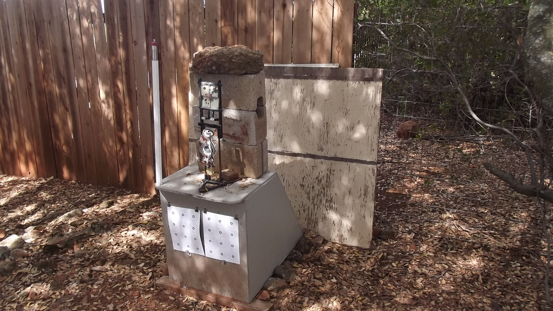

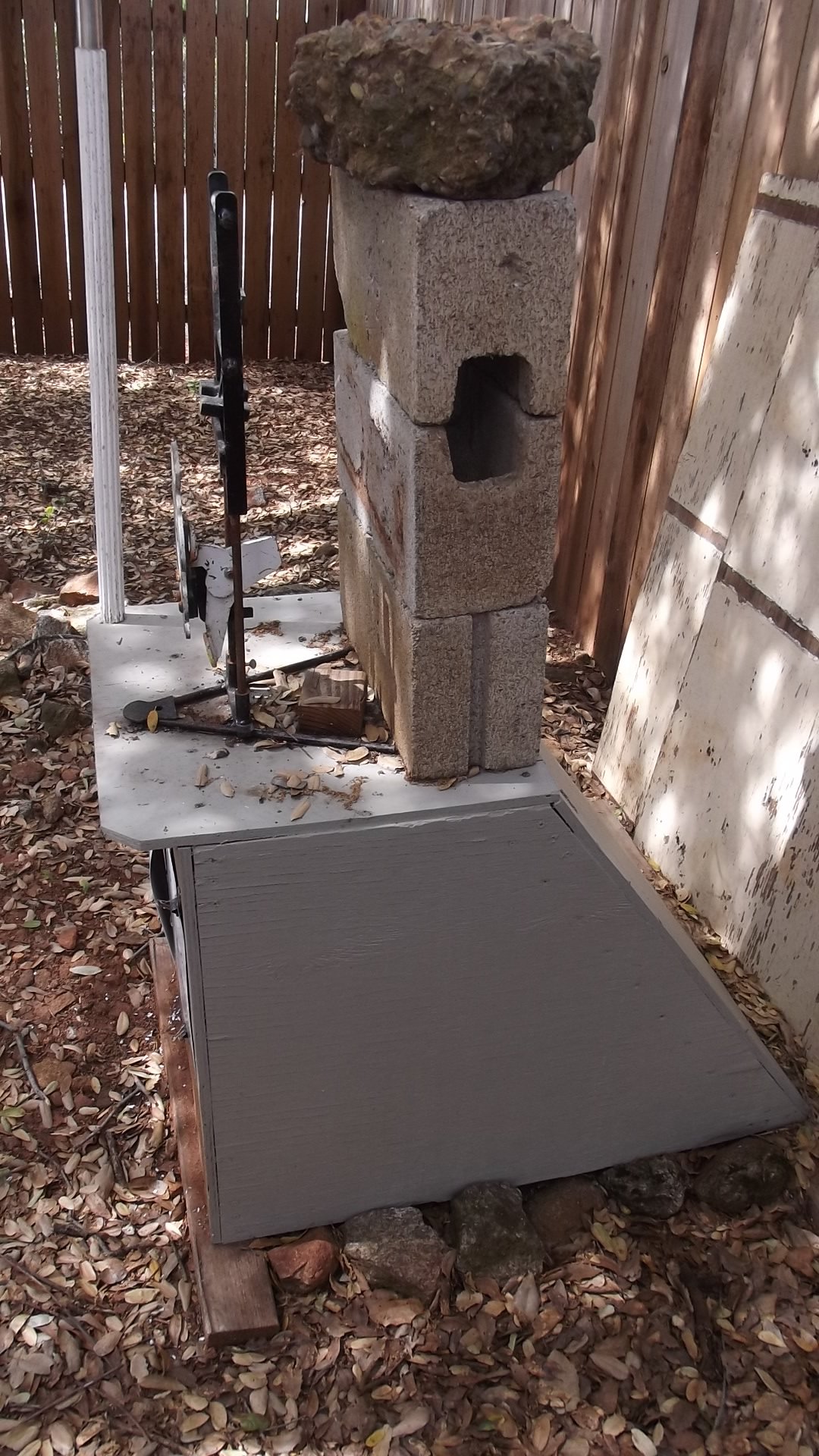

Emptied out three of my mulch bucket target holders today as part of upkeep. I have two out of the five I made currently in use but those will fill up before too long and the 1/2” thick anti fatigue mat I was using to hold the mulch secure is getting shot up, so I like to have two to three at the ready.
Here’s a pic of the shot up mat-
And the pellets that were in it-
I finally took advantage of the cleaned out mulch and redid a couple of buckets with new steel shrouds. Heavier than the originals at 16ga(originals were 22ga) and bolted up the protective 1/4” plate frame on the face. You can see in the pic what happens to 22ga sheet metal when hit with high velocity pellets. With that heavier shroud and the plate bolted to the face, it’s like a bumble bee into a car windshield which is traveling at freeway speeds.
Lastly, on this second gen version I allowed for the buckets natural taper when designing so this version my targets are facing me straight on and not angled down-
Since rubber mulch is reusable in this application, my only needed consumable is the rubber pad insert. Through a connection from one of my ex students who runs the sheet metal shop I used to work at, a new duct liner came out in the last few years. Thick closed cell neoprene vs the old style insulation that got glued and pinned to the insides of the ducts. This type of liner is ideal for clean rooms and hospitals as no lung clogging insulation gets in the airstream. With its natural sound deadening trait, it’s also very ideal in ductwork installed in theaters, court rooms, etc.
He told me he’s got tons of scraps at 1” and 2” thick, so he’s bringing me some to see what works best.
You all seeking the best sound proofing materials along with all weather and anti rot properties, this material is what you want. Go to a local commercial HVAC shop and see if they’ll give you the scraps.
If the 2” pad works that’ll last a long time I’m thinking.
As soon as I have some in my hands and have shot thru it I’ll post a thread or maybe reply back on this one.
Sure wish that was around in my work life. I’ve sucked in my fair share of fiberglass dust in the 35 years of working around it.

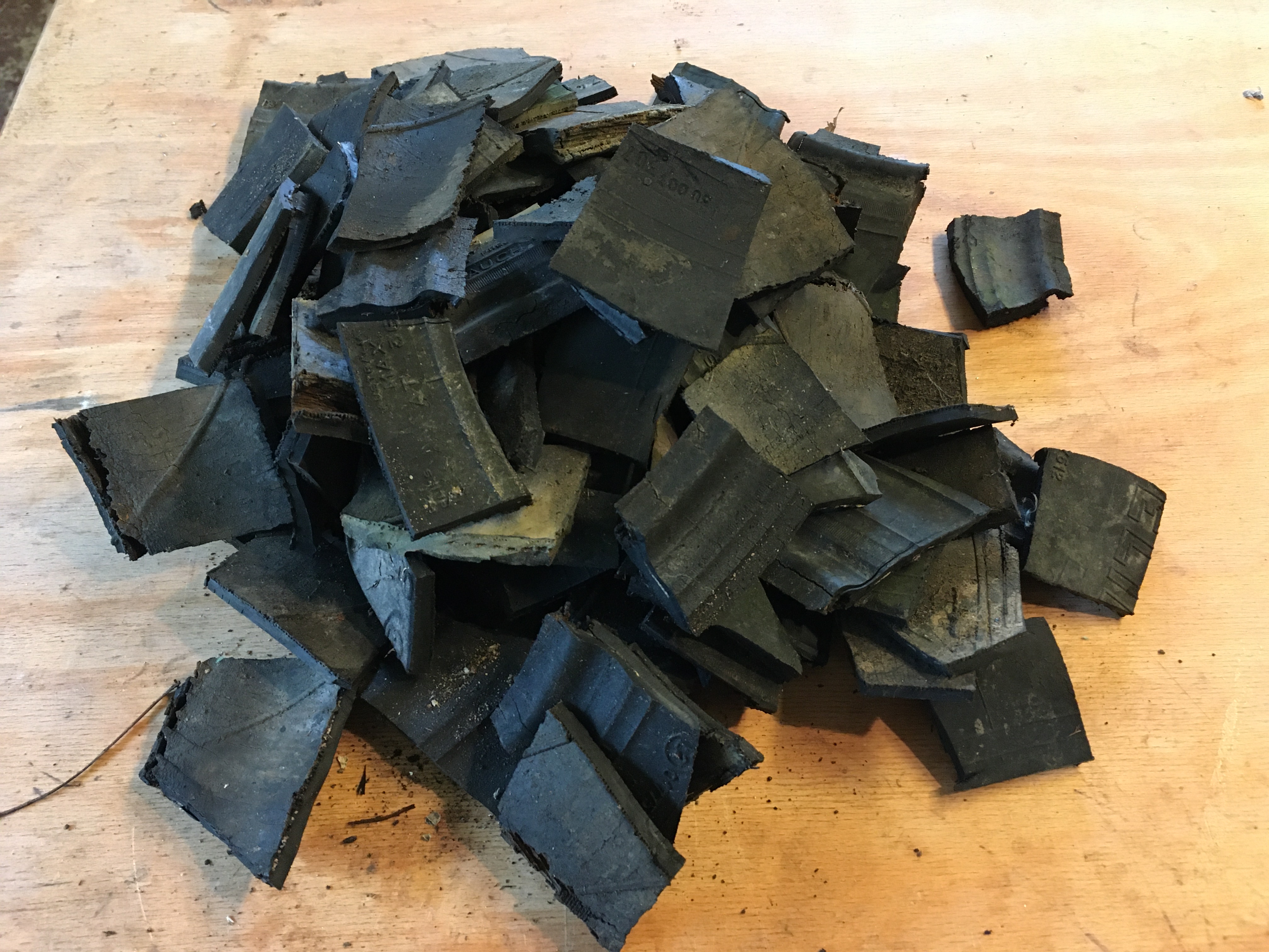

Well , as rubber mulch is not available where I live , I decided to make my own ! So I cut the flanks of some tyres into pieces and put them in my backstop ; seems to work , but I need some more to get better results , and rubber is not that easy to cut but with the right saw and a good machete to chop , it's easy.
I 'm not sure about the size of the rubber pieces , maybe smaller would be better.
The target paper is still noisy ; a kind of soft cardboard should be quieter , I think . Some experiments to go .....
