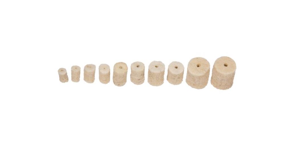

If the barrel is mounted I use these pellets from Tipton. Twist the cleaning pellet while you push the patchworm point thru the hole. I generally put on a single patch first then the felt, slide it down to the stop on the patch worm, add a small amount of Ballistol to the leading edge of the felt and pull it thru.
After that sets for 5 minutes I repeat the process and wait another 5 minutes then I run one dry felt on the patchworm by itself and follow up with several patches. I might repeat the process if I'm still getting a lot of dirty patches.
If the barrel has been removed I have a cleaning rod and omit the felt pellets.

Cleaning pellets are worthless, pull through isn't much better imo.

The only reason that instruction would be included is to save the rifle from damage by the most incompetent owners, who might attempt cleaning in an improper manner. As for scientific evidence, how about looking down a fouled bore after shooting these through it? If there is lead fouling present, it will still be there.
