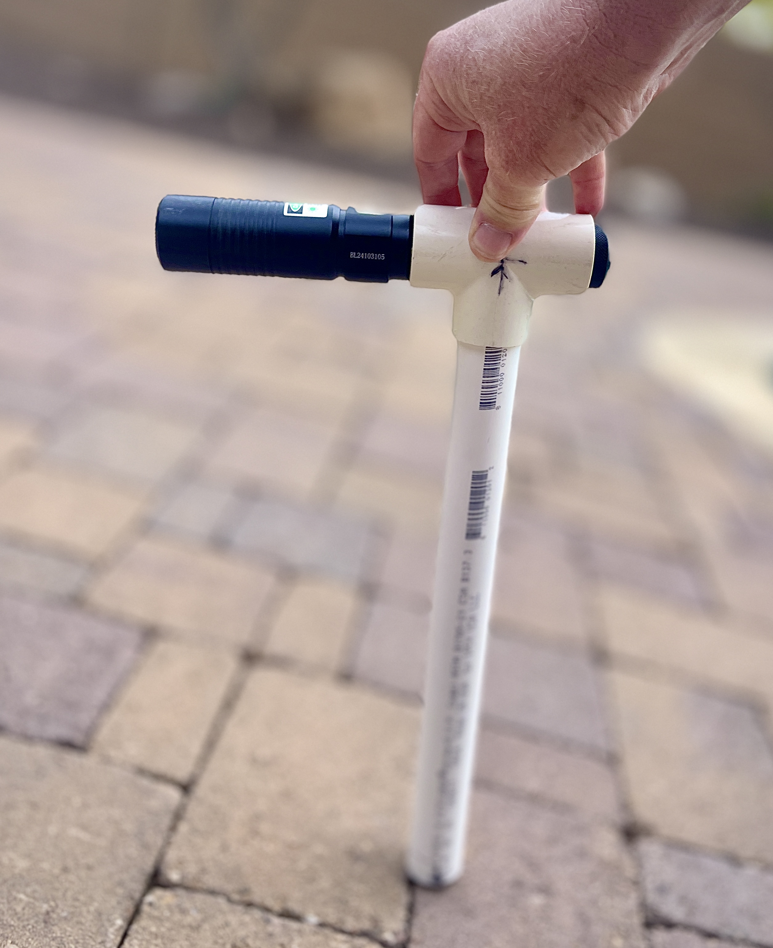

Recently, I discussed this with some fellow shooters over a beer, and we talked about the many ways we could find a solution. So, I'm sharing this little gadget that I made for our club, and someone asked me to share and post it. So, I've taken a laser pointer, wedged it inside a PVC T-connector, and cut the pipe so that the laser is 15" inches off the ground. Although the AAFTA rules have changed from the measurable distance of 15", to "from any position", 15 inches is the posted standard we use to ensure a clear path to the KZ. This tool lets us clearly see any weeds or ground features that may obscure the KZ by highlighting it with the beam. Simple, yet highly effective, without the need to get down on your knees for every lane.
We use a 200 ma green laser.

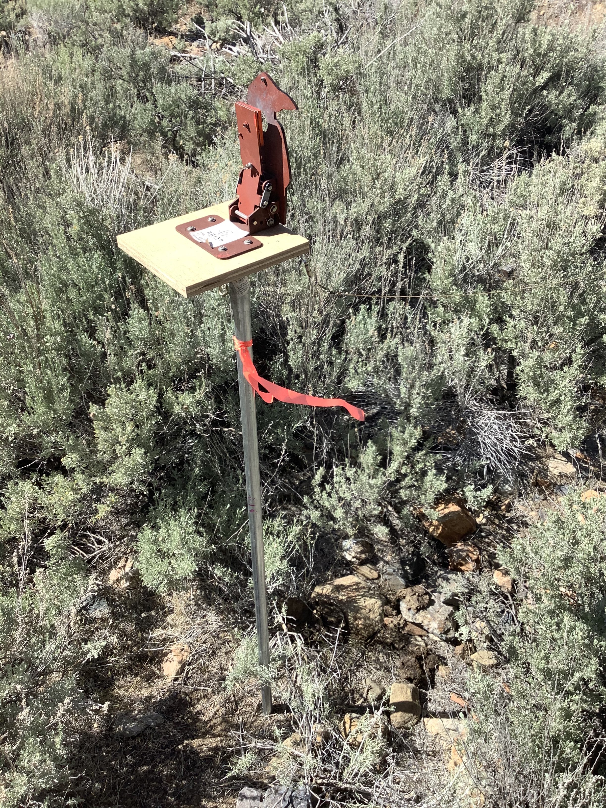

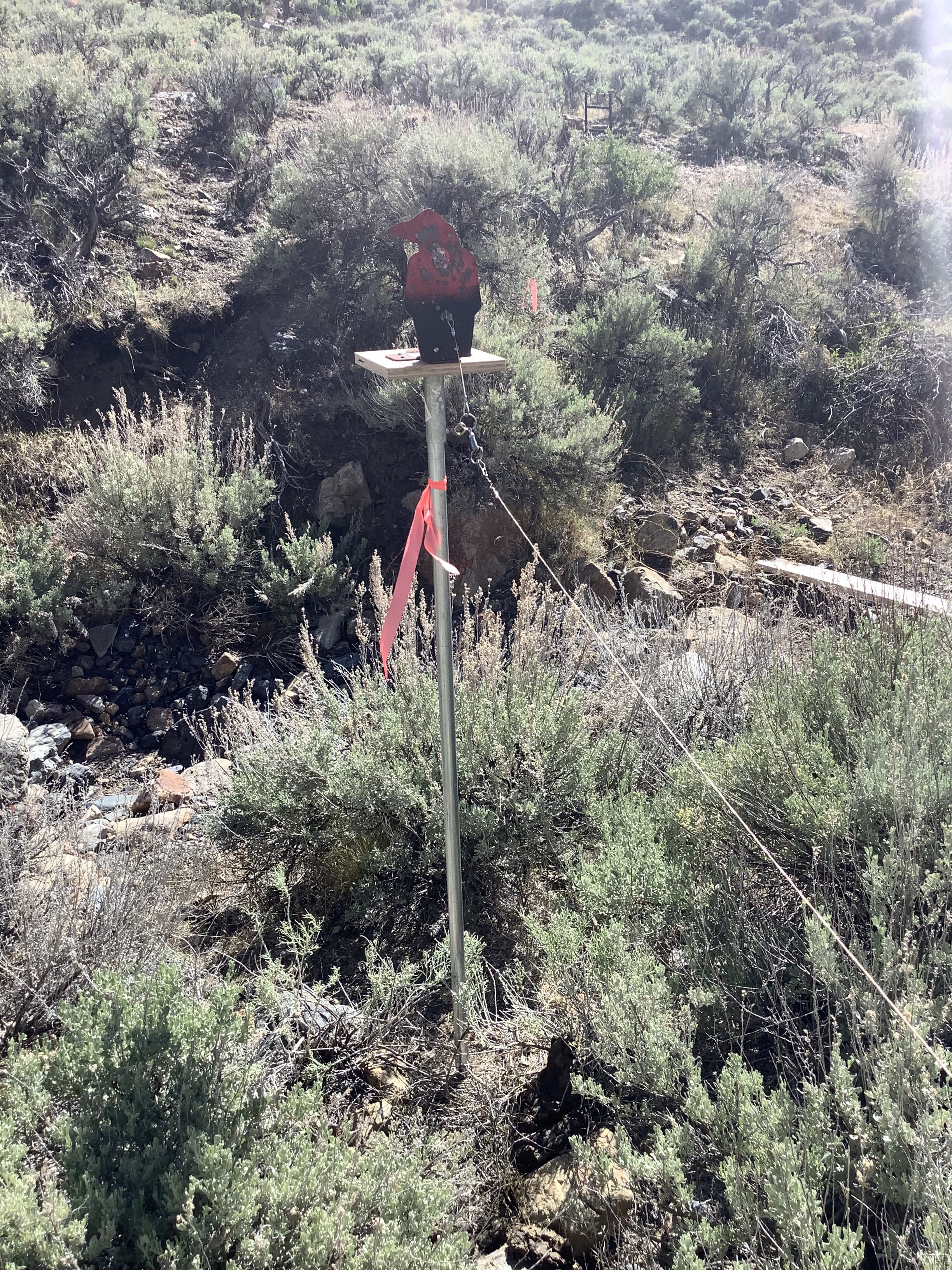

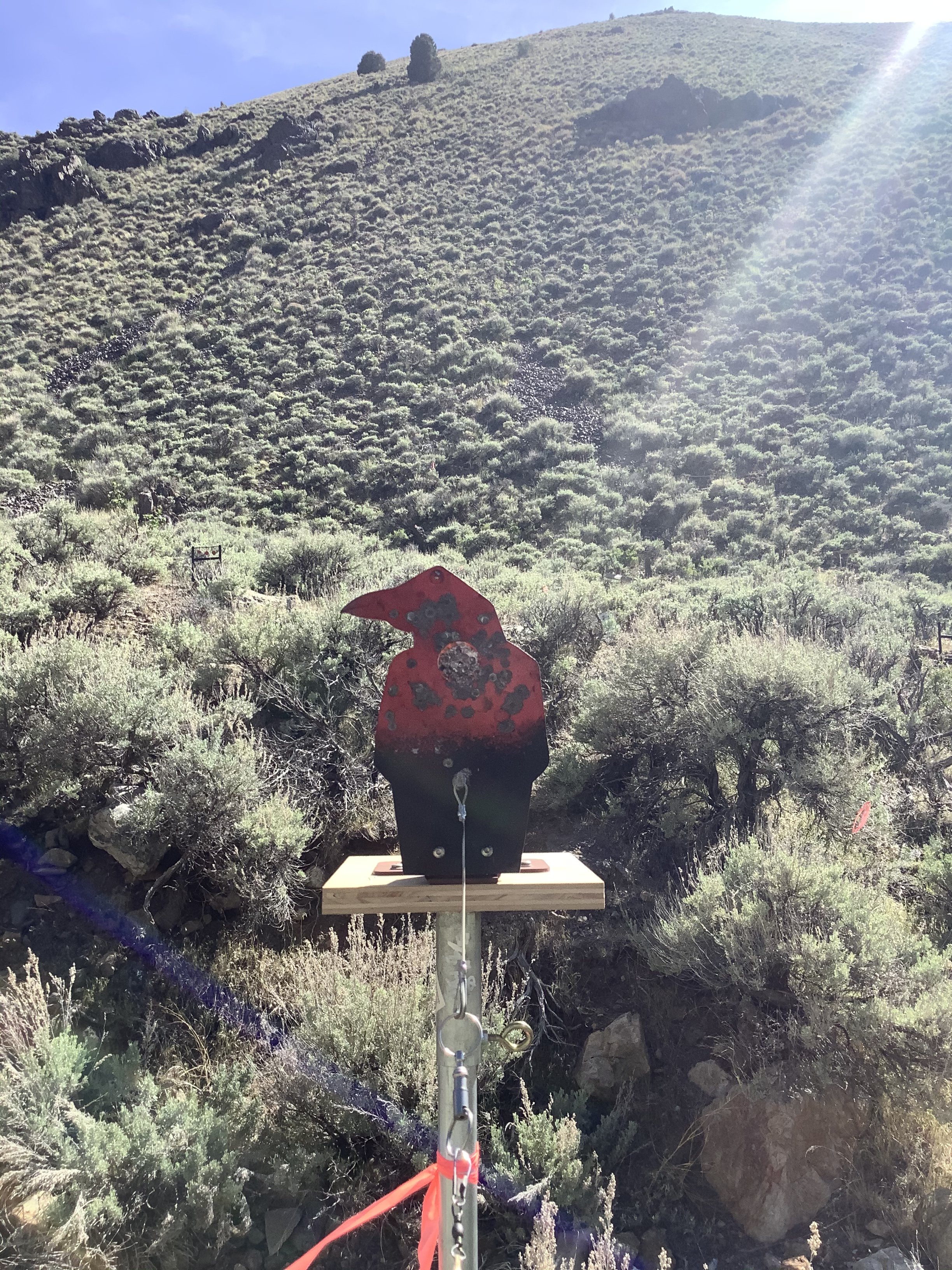

Garrett, have you tried the pole mounting technique we introduced at Nevada? We invert canopy feet and use a 1" EMT on a 3/4" concrete forming stake driven into the ground. You can mount targets up at 6' and at the end of the day they break down quick. It would take two full days to ground mount the rifle and pistol courses, we can set both up in around six hours now. The added benefit is you can swivel the targets to a new box for day two and add/subtract yards in the process. We leave the poles out all year and re-drive the stakes in during the week of match prep (cows graze in the valley and occasionally knock over the poles).
