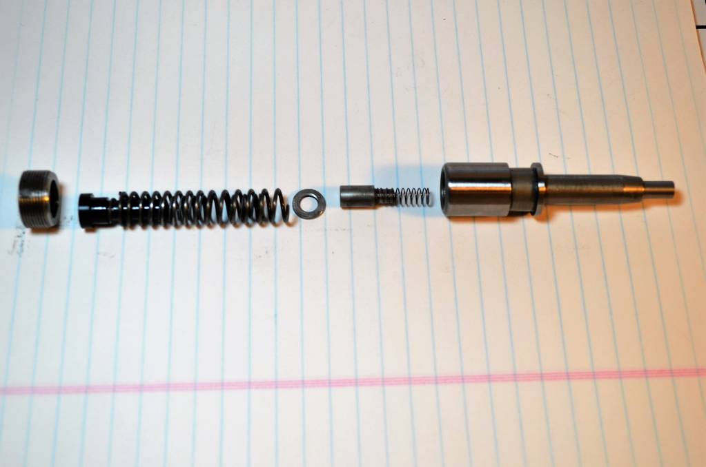

To the OP, if a good cleaning doesn't solve your accuracy problem, it is very possible that the hammer assembly needs cleaning and lightly lubing. A dirty hammer assembly in the RAW can cause this exact result. The maker recommended to me a light lubrication with synthetic oil.
I never had a leading problem with my poly barrel. I cleaned it with a couple of patches moistened with Ballistol, then dry patches. Usually no more than 3 each. I tried lubed vs dry patches. No differenct IMO. Ditch the wax. Oh, if you haven't cleaned the hammer, do so. Sometimes it gets greasy which affects the uniformity of it's travel. Lube it with a very light coat of a very light oil.
Here's the assembly sequence:
