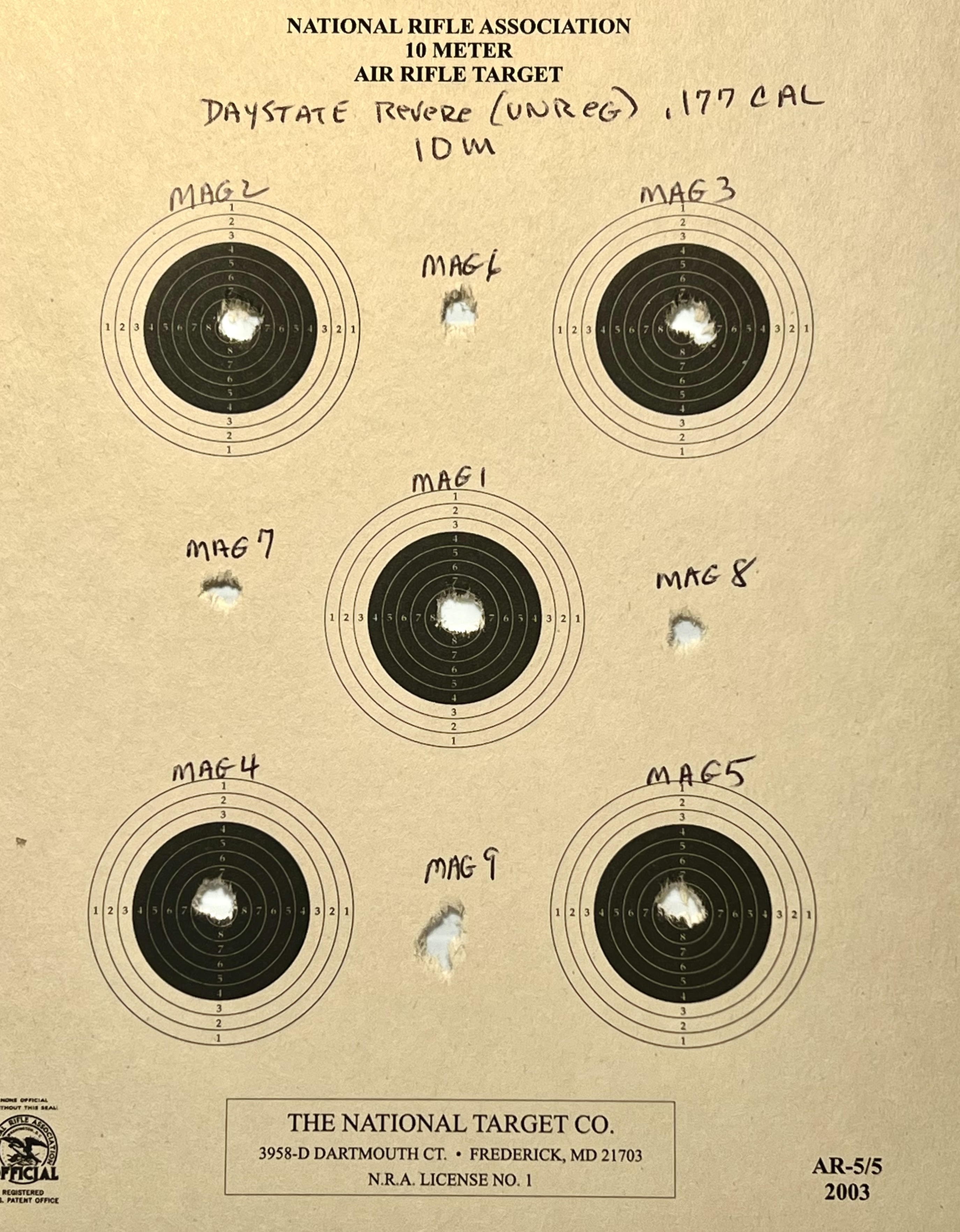

Here's what I did with my Revere .177 cal unregulated rifle. I filled the gun to max capacity of 250 bar and it cooled a bit to 240 while setting up for the test. I ran 13 shot magazines over the chrono and recorded the pressure reading after the end of each magazine. I also shot each magazine in one target at 10M to see where the POI dropped off. It was during the 9th magazine that the shots started to drop off which was around 825 fps with 10.3 gr AA pellets. For general plinking, I think over 100 useable shots are there. If you want to be a little more in control, then I would shoot it from 200 down to 130 bar giving you a nice flat velocity curve around 900 fps.
