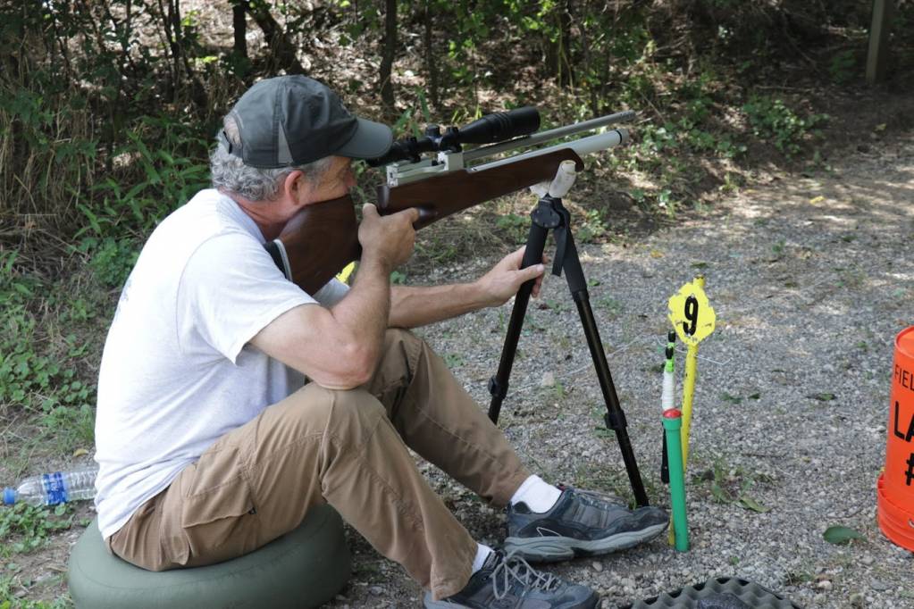

Tri chair and sticks ... tho try shooting SIDEWAYS across your lap. Bipod along side left knee and butt stock on the right thigh as near to kneecap as you can manage. Scope mounted way forward so you can lean in and get a good sight picture NOT having to lean to right so far as too upset stability. * this would still be a legal "HUNTER" position.
Ideally set the LOP so the butt pad rests up against your elbow / upper arms corner. Shooting off hand you can now shoot rifle more bull pup like being sideways to your chest held in tight and left elbow on side of ribs or hip.

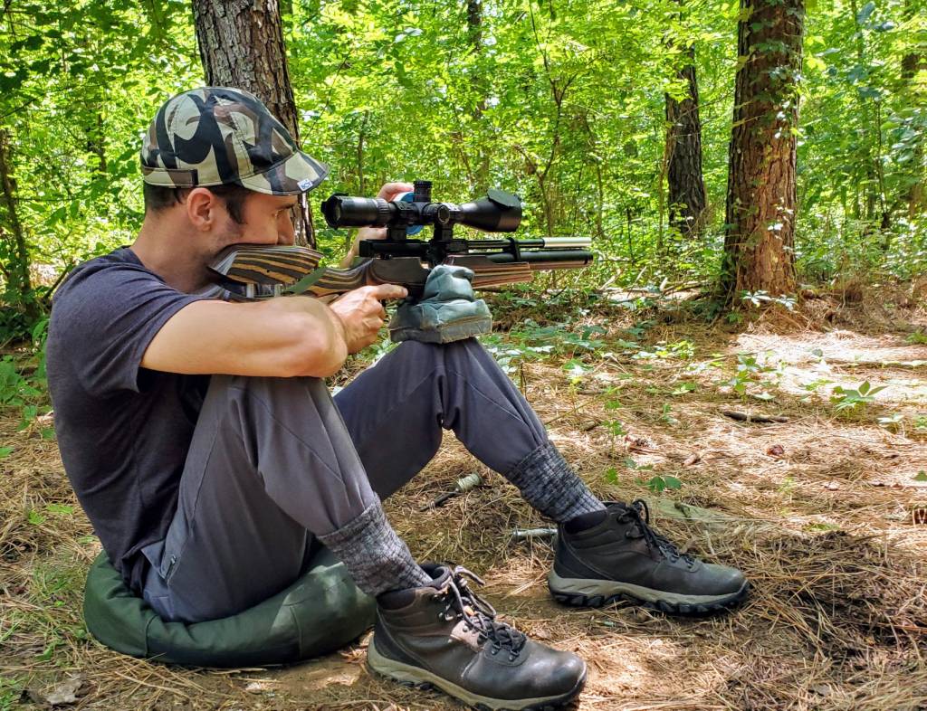

I'm not good at it, but shoot FT with my springers pretty often. I shoot Hunter class, but can't shoot for beans off of sticks.
The only piece of advice I feel that I can offer, is don't try to shoot like Hector. That's what's best for HIM, so that's how he shoots. Find what works for YOU.
I basically just wad up in a ball on the ground, resting the gun on a small rear bench bag, with my right knee tucked inside my right elbow, and the butt held steady between my chest and thigh. I can hold very steady this way. With a hamster or kneepad it would likely be even better. But I like the softness and how the gun sinks in to the little bag.
This is the only pic I have of myself, luckily my buddy Danny snapped it at some point lol. Excuse the PCP, just pretend it's my 77K 😁
Oh and if you don't tuck your britches legs into your socks, that might be your problem. Everybody knows it's the key to accuracy! Or not getting ticks, I get it mixed up........

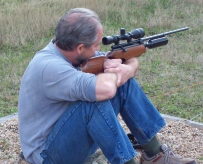

My wife shot extremely well off her knee with a little pad to protect her knee. She was VERY still. We worked at our positions a long time but I could never relax enough with it on my knee. I wrap my arm around my knee some and shoot over my arm.... maybe facing 75 degrees from the target. I've seen a few do this general style and if you check out WFTF, you'll see a good number shooting over their arm. For me, it's the most still, and very versatile. Most use shooting jackets for additional support.

I never tried to emulate anyone else's position when I got into FT. Rather, I let my body do the talking, that talking heavily emphasizing COMFORTABLE and NATURAL. It worked! I'm often complimented with "you make it look so easy".

It's pretty much all been said here, but IMHO the most important is finding the position that allows your particular body type to relax and be comfortable while the rifle is pointing at the target.
Last year I shot two days with world champion Jack Harris at the PA Cup. I studied his position carefully and it is what I would consider perfect: spread out like a tripod with a low wide base, gun resting on hand on the side of left knee (hard to describe but provides both horizontal and vertical support). I wasted no time trying the position... easy enough to replicate but the problem is that my gun is pointing at the ground about an inch above my big toe, LOL. With my shorter legs and longer torso I'd need about a foot long knee riser, defeating the whole purpose. So after much experimentation I shoot in a ball more like Ron and Chase above instead of spreading out, it works pretty well for *me*.
BTW, Jack cleaned the course Sunday and won the Cup.
