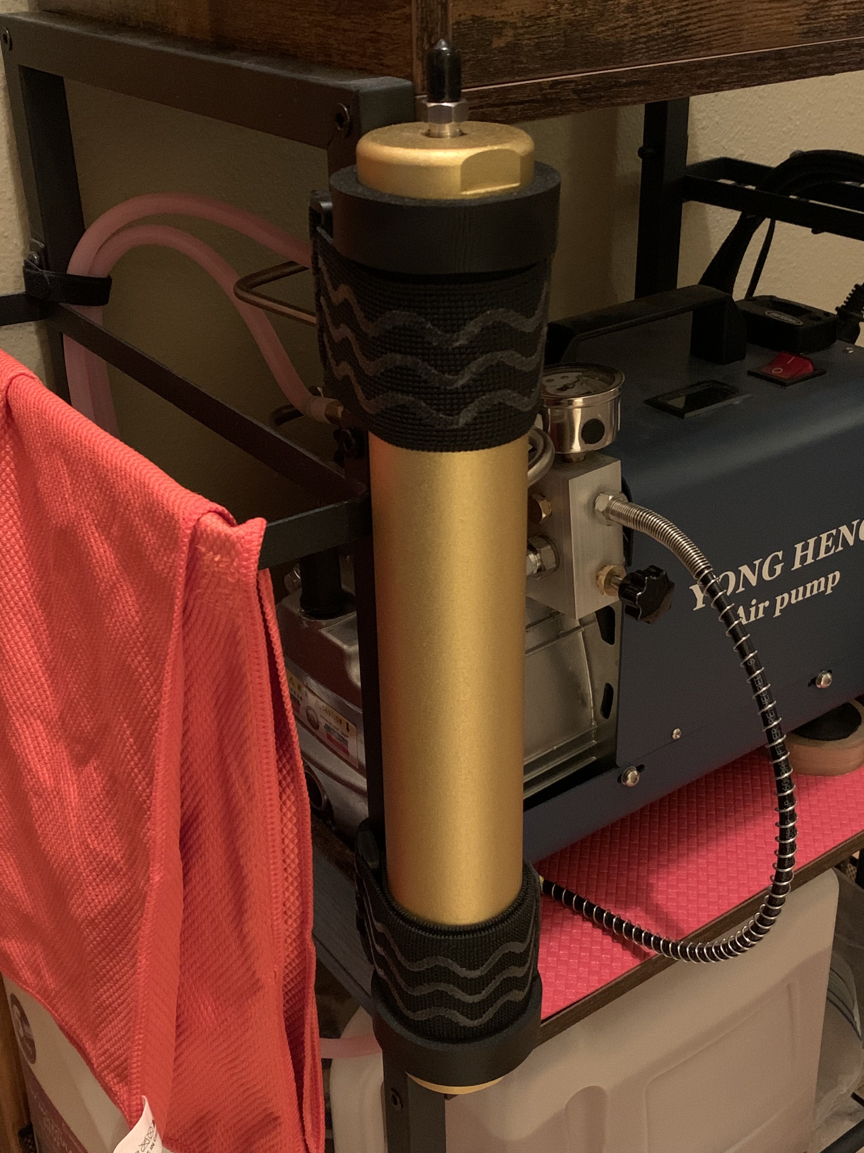

I have a one way valve on the output of my extra filter filled with color change dessicant. It came with an extra cartridge so I filled it up and put it in a zip lock bag. The extra cartridge changed color quickly (weeks) but not the cartridge protected by the valve. The other end of that line is at the vent of the YH which I leave open. But still the dessicant stays good for months. I guess there is nearly zero flow past the vent, down the line, through the YH filter and into the dessicant.
You don't need flow for moisture to move down the line - it will do so via simple osmosis. This can be made worse by the likely presence of liquid water in the line at or near the compressor evaporating and then the vapor moves down the line into the desiccant.
While you are getting a satisfactory service life from your filters, it will probably be extended further if you seperate it from the compressor and cap it with a good seal after use (maybe a deadhead?).
