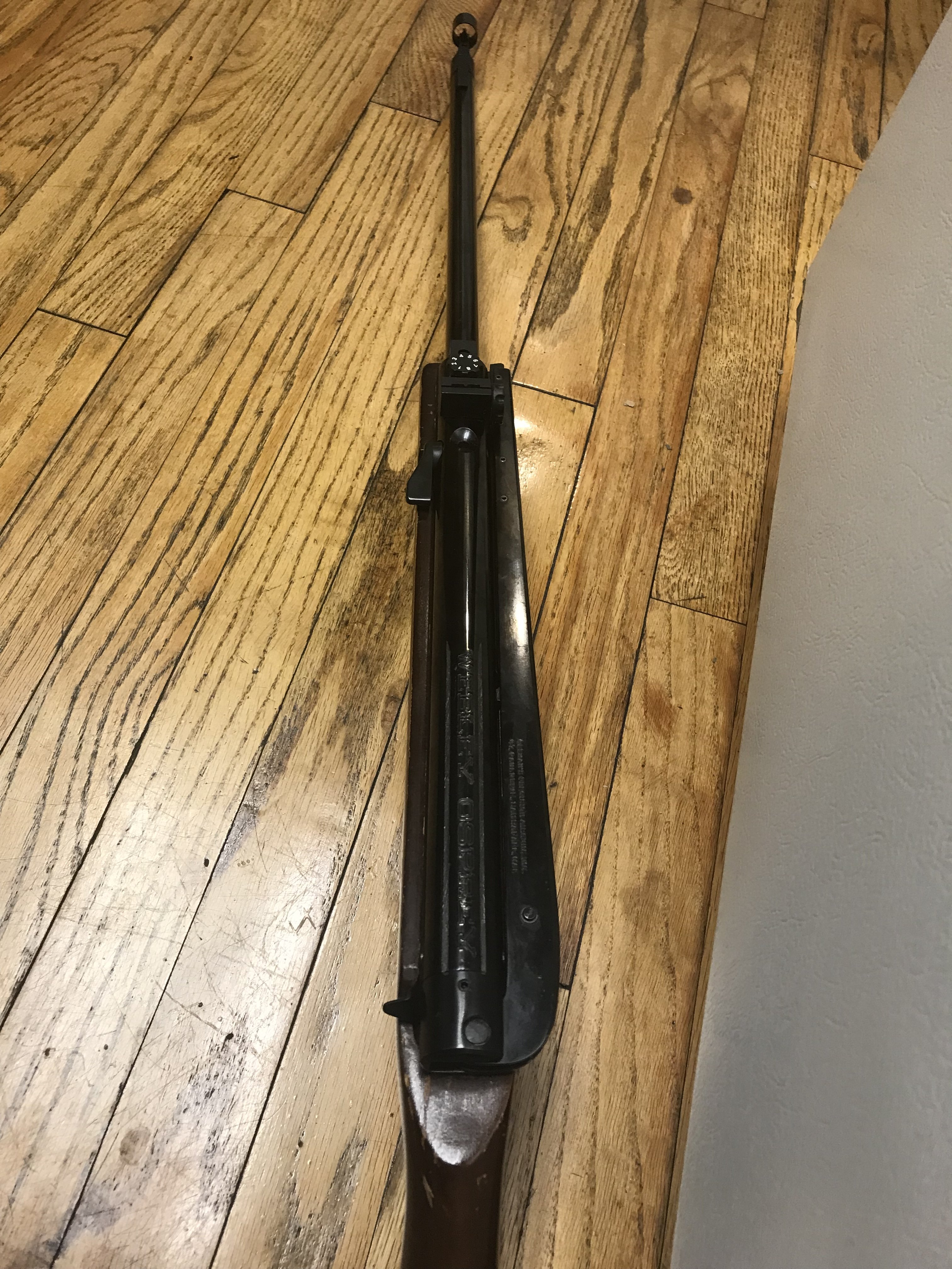

How do you know if a spring is bad have an old Webley Osprey break barrel and what grease or oil to use
I just got a webley osprey looks to be 1970s or early 80s and the spring makes a loud noise. Are some of the old springers just more noisy than modern break barrels or does the spring need to be replaced or lubricated? It is shooting hard and seems to be accurate from close range but have not taken many shots because of the spring noise. Also what is the best grease or oil for the springs on break barrels?

You can also apply some "Tune in a Tube" lubricant on to the spring through the cocking arm channel. A thorough tear down and reline would be best, and most springers are easy to do. You may need a spring compressor, but sometimes you can muscle it together. Check out various Youtube videos for springer repair. Look for Webley specific, but other makes and models will give you the gist of it.
You may look in the cocking slot of the receiver and see it broken . Or you remove the spring and clean and inspect it like for a collapsed look . Maybe not so stright . That old it be worth s good tare down clean inspect and go fresh lube if it all seems to check out anyway.. probably just basic moly paste from a air gun shop or a place that sell tune kits and all.. i aint hip on that tar stuff.. some like it ..

As noted above, the Osprey did not have an OEM spring guide, so twangy is normal! But there are modern tunes to help.
As an aside...the term "break barrel" refers only to guns that use the barrel as the cocking lever. The Osprey is not a break barrel, but has a fixed-barrel, tap-loading action cocked by a separate sidelever.
