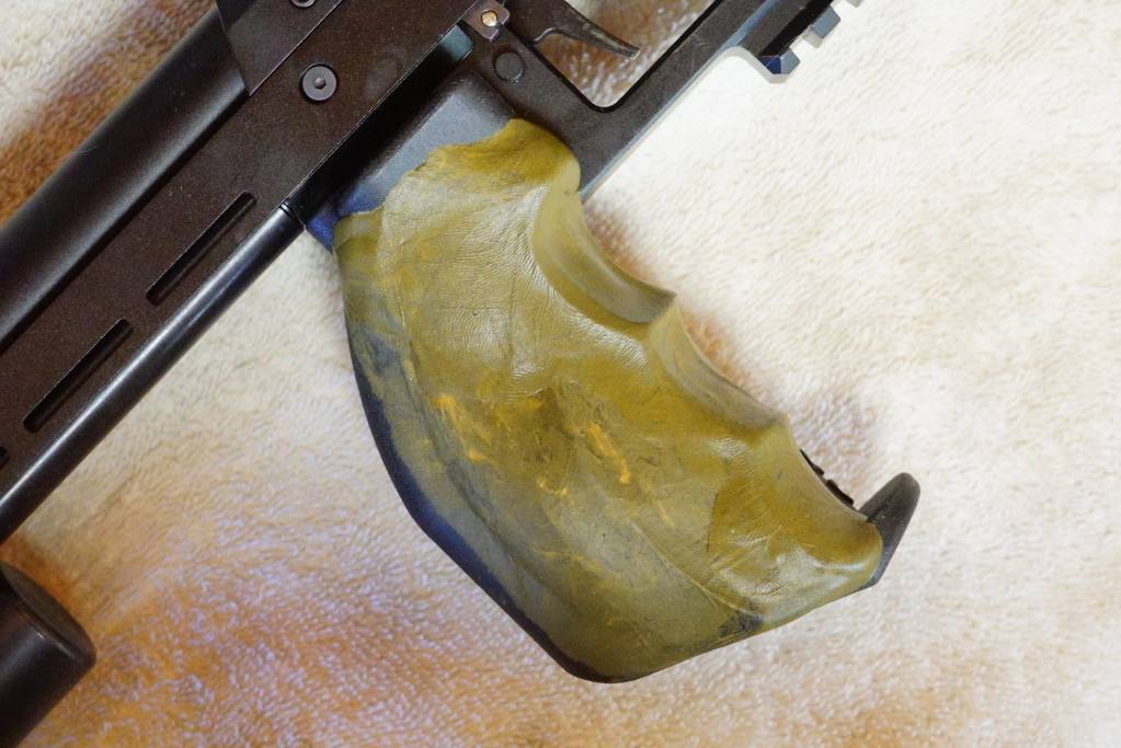

And yes, I've made "molded" to MY hand, grips for a couple of my rifles, so I fully...understand the "fit" part of it, which, yes, makes the hand position the "same" every time that you put your hand on the grip.
I've also modified "target" grips to better "fit, my" hand (my 6004 FAS being one of them !). I have a bit larger hands than most, and most grips are way too "tight" if that word fits. I've modified about 1/2 of the grips on my guns, to better fit ...me.
BUT...all this said...I "still" like the ASP grip..! Admittedly, I did add a piece of the Talon grip panel to the palm side of my ASP's grip panel to enlarge it a tiny bit, and give it a better, less slick feel.
