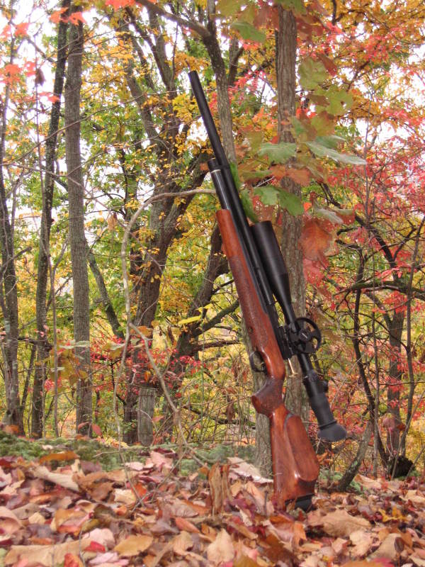

A .177 Squirrel whacking Machine
Thumb reached the side wheel while holding it on target for range then holdover. Great to 60 yards, all clean head shots. This picture was taken while squirrel hunting (need to "use" a tree & leaned it against a bush on "Walnut Ridge".
Love A/O scopes though knowing bracketing just makes sense.
