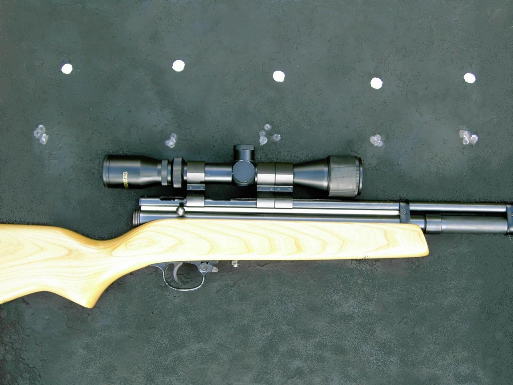

In it's best effort of five consecutive five-shot groups at 50 yards, my Sears & Roebuck variant of a 1960s-vintage Crosman 180 .22 Co2 rifle averaged .54" center-to-center groups with 14.3 grain JSBs at only 650 FPS and 12.5 foot-pounds. For perspective, that equals the best accuracy I've achieved with such impressive PCP rifles as my current RAW TM1000 field-target rig, an HW100 with two AAFTA Grand Prix titles to its credit, a .20 caliber Beeman/Theoben Rapid 7, and (multiple) FX Tarantulas. Only one Tarantula consistently produced better group size averages (actually .43-.44"). FWIW, the scope used on that Sears 180 to achieve such impressive 50 yard groups was just a 2-7X.

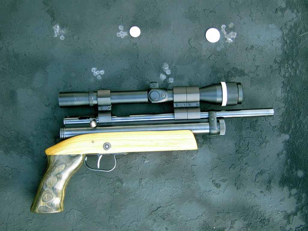

Made from an even earlier 1950's vintage Crosman 180, in a session of five consecutive five-shot groups at 50 yards my first rifle-to-pistol conversion averaged .74" c-t-c with 14.3 JSBs at only 530 FPS and 9 foot-pounds. BTW, that was done with a 7/8" tube, 4X scope!

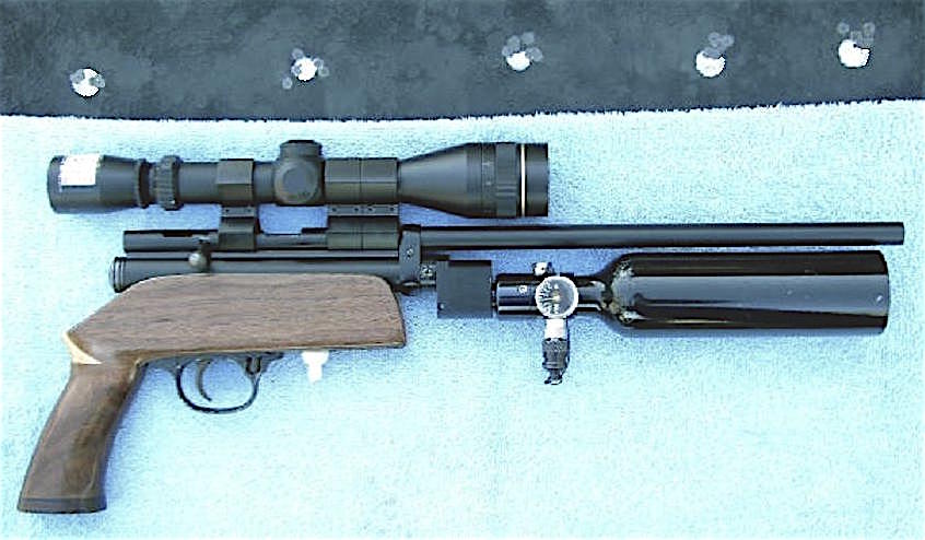

And lastly, on two separate sessions of five consecutive five-shot groups at 50 yards my 1960s-vintage Crosman 187 rifle-to-pistol conversion field-target pistol achieved group-size averages of .66" and .67". For perspective on that, only an Allen Zasadny modified Steyr LP-1 pistol bettered that accuracy (twice, by only 1/10") by averaging .56" c-t-c groups at 50 yards. The best single group achieved with both the AZ Steyr and the Crosman 187 measured .34" c-t-c, meaning all shots in those groups would have hit a thumb-tack and the groups could easily be covered by a dime (see photo below).

The pertinent points (to this thread) I'm getting at are, 1)- The groups presented and pictured here were shot with STOCK Crosman barrels; in the case of the pistols, those barrels chopped and re-crowned by a shade-tree gunsmith, 2) Obviously Crosman has been producing barrels accurate enough to rival todays best airgun barrels for over a half-century, 3) It would be quite a remarkable achievement for them to improve on that now, 4) At least in an economically-feasible barrel for their current airgun models, and 5) Wouldn't it be cool if they DID?
