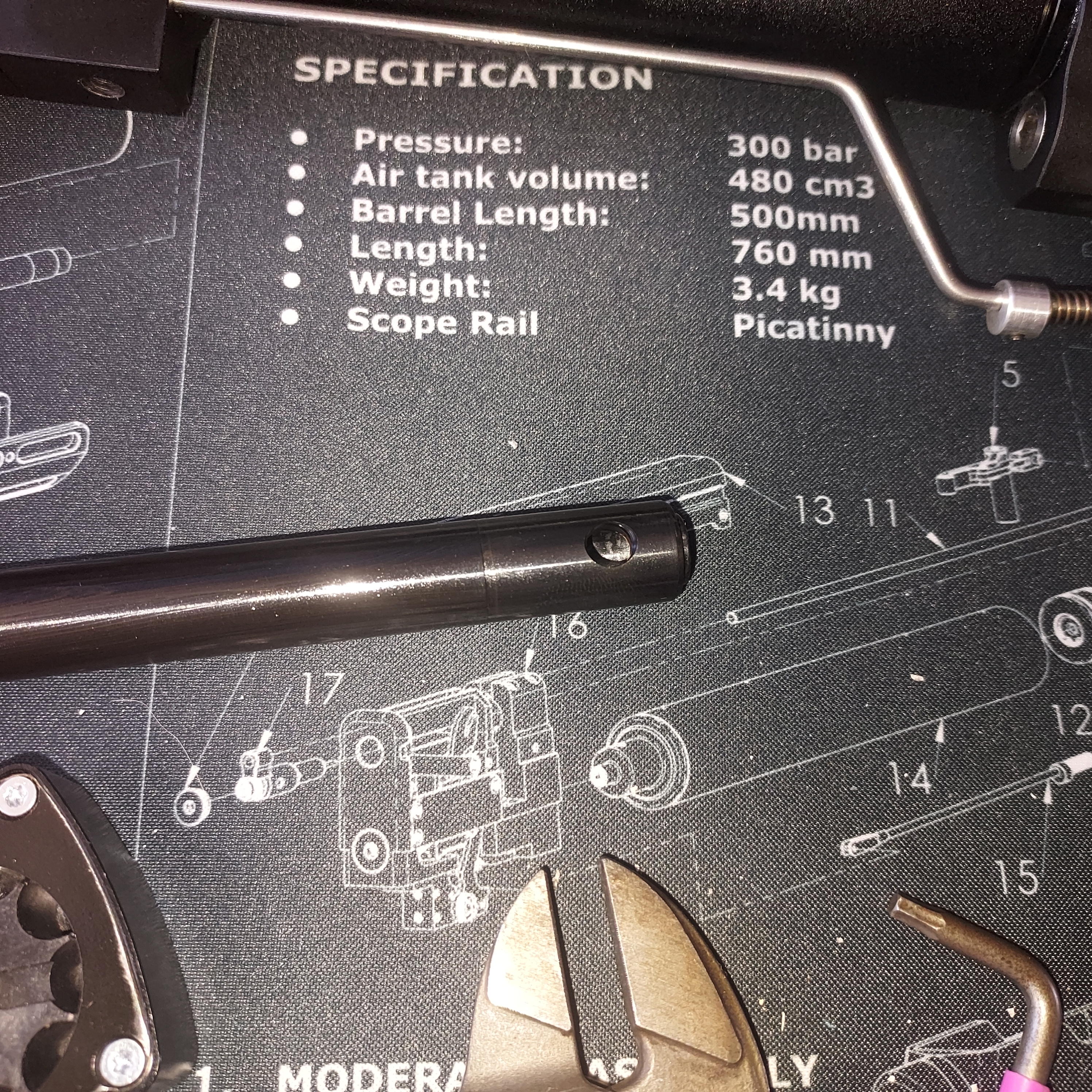

I recently got a .30cal Uragan 2 CF.
Today I took it apart and added an African air ordnance power upgrade kit.
When I was looking at the transfer port, it is just a single oval port.
Is it just the .22 & 25cal that have the bridged transfer port?

I've enclosed a pic of the transfer port from the .30 cal in case any one is interested.
Seems that way! Perhaps your reg pressure is higher than I expected. Certainly higher than my friend's.
These balanced valves are almost 'all or nothing' but when you are on the verge they can get into a sort of partial valve lock. Happens on the prophet 2 if the HST is a fraction below what's needed.
Up to you I guess - with a very high pressure the kit components may well be okay, since the hammer impact will be somewhat cushioned by the increased opening force required as well as the more quickly increasing pressure in the balance chamber 🤷‍♂️
If it does eventually cause issues, the replacement of that oring is really simple too.
