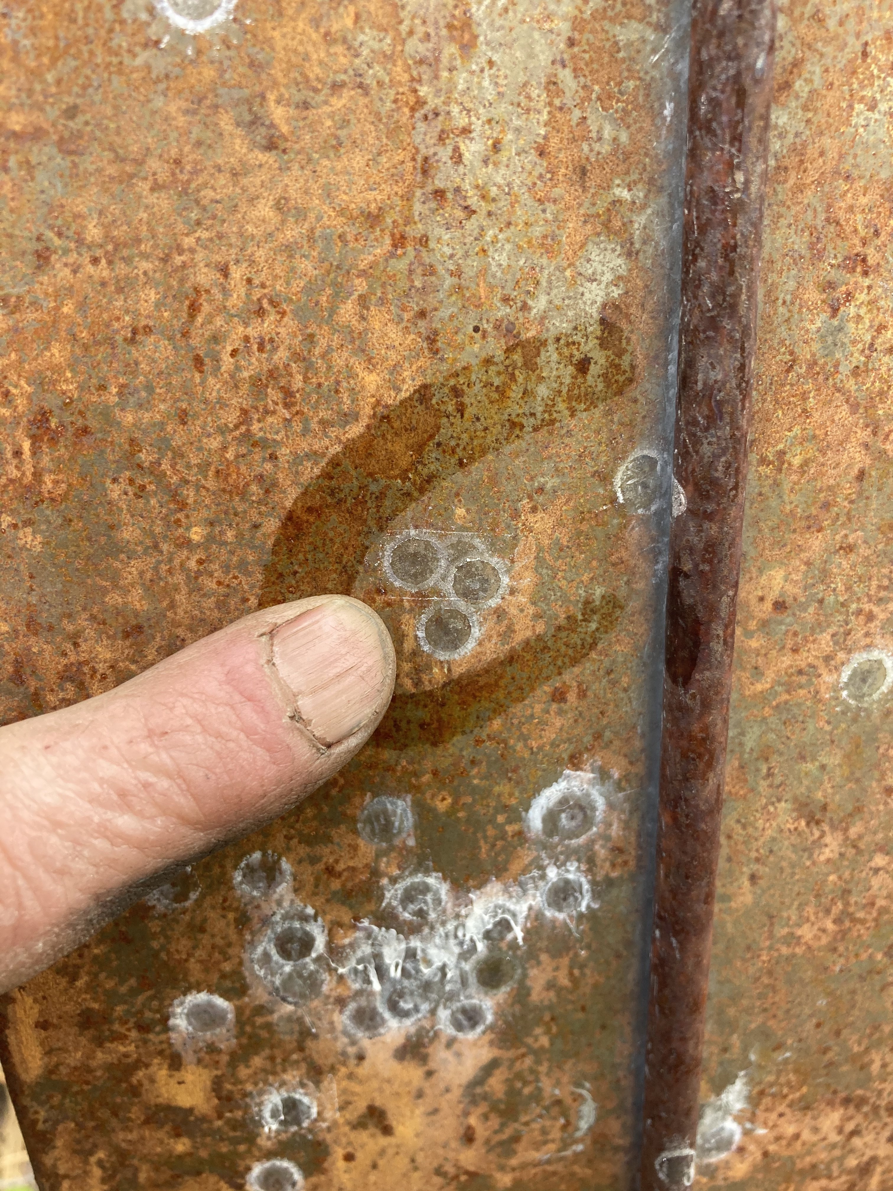

I have a sheet of steel at 130 yards and it’s a lot of fun shooting groups on it.
These are my two best groups I have ever shot with anything.

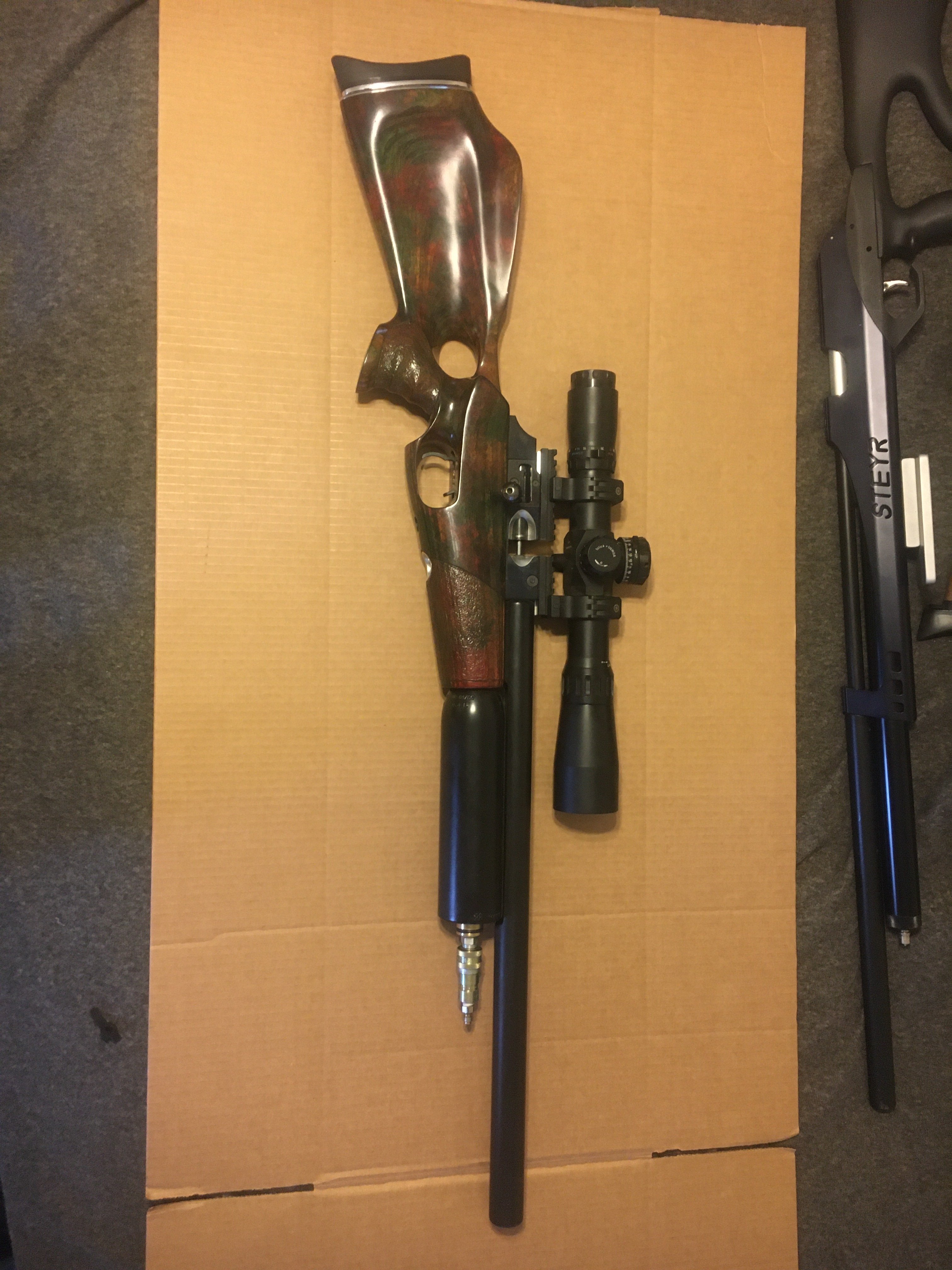

It’s a Rapid .20 caliber with a shroud made by Allen Zasadney.
He tuned it to shoot the 13.73 JSB at 860 and it is truly incredible.
It’s only possible in dead calm, if the flags are moving at all the groups are 3 or 4 inches or bigger.
I tried shooting the heavies and they were good but not as good as the light pellet.
I’m definitely not going to change the tune on this rifle lol.
