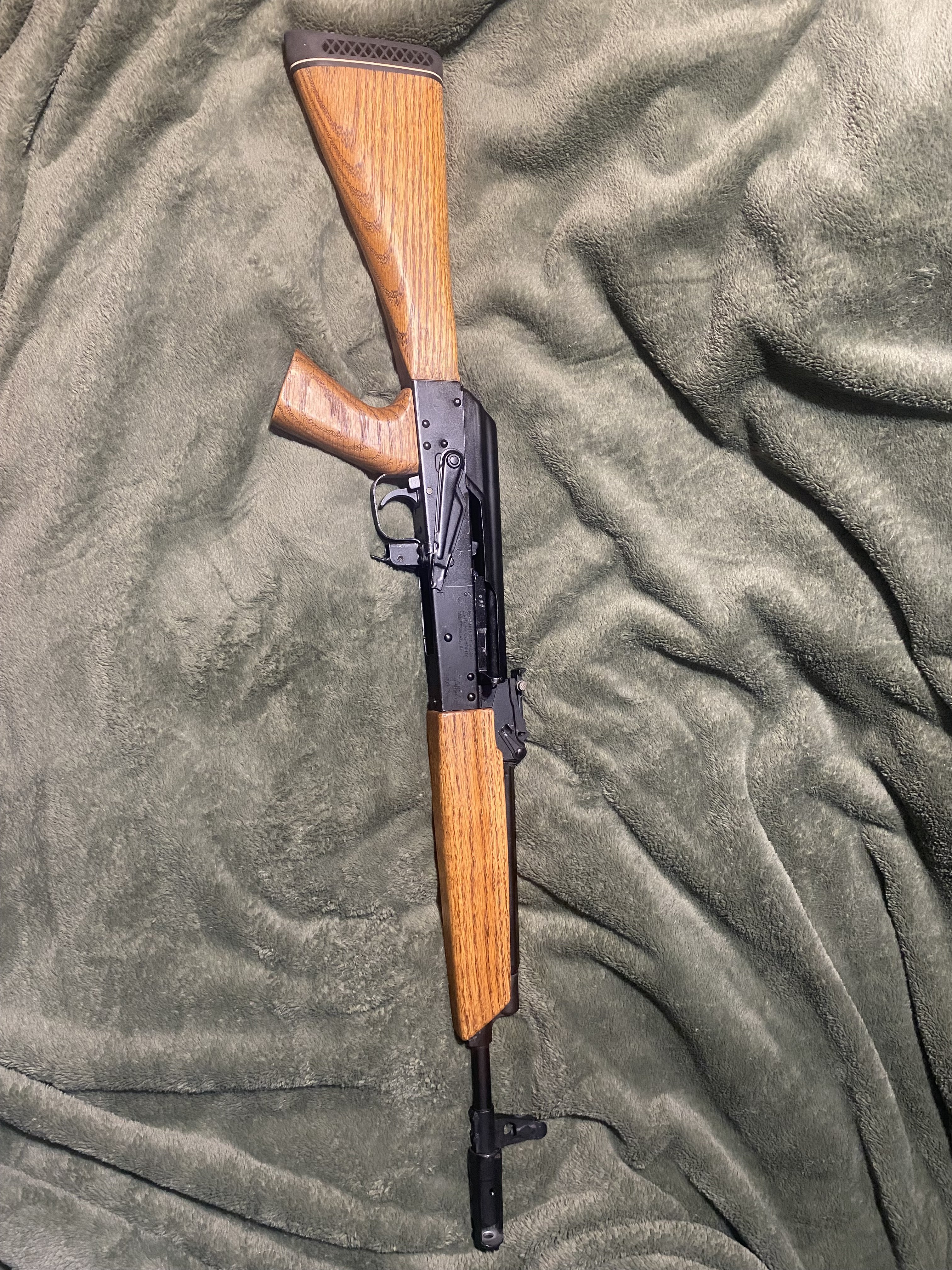

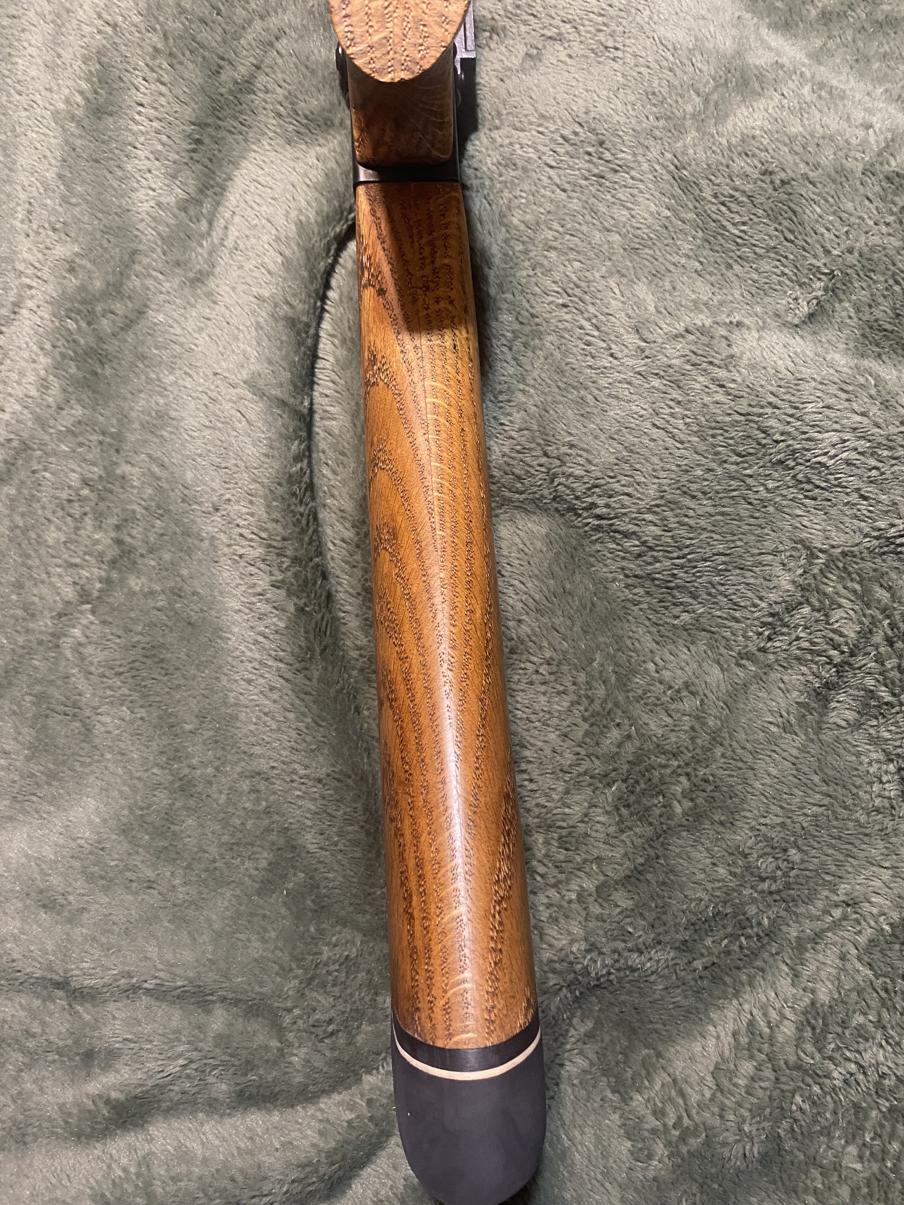

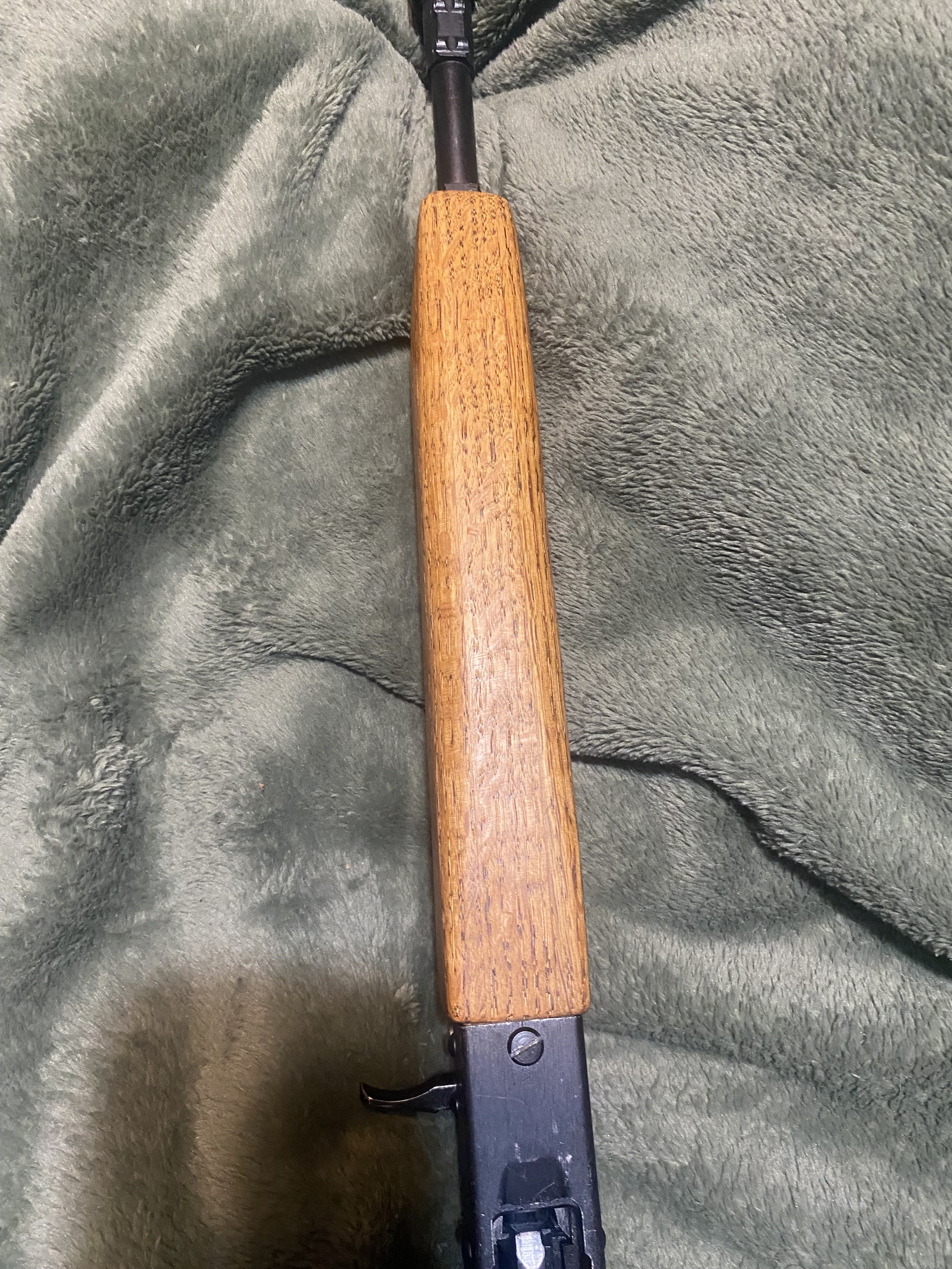

Wow, I'd buy this one for my Saiga!This is one I made out of oak scraps I had lying around. I think it may have been my first. At the time I was flat broke and couldn’t afford a furniture kit for a Saiga I was converting, so I made my own. The forearm is actually 3 pieces of 1” oak glued together and the buttstock is 2 pieces. If you look closely you can see where the grain doesn’t line up on the buttstock, but on the forearm it’s pretty much invisible.
View attachment 508514View attachment 508515View attachment 508512View attachment 508513

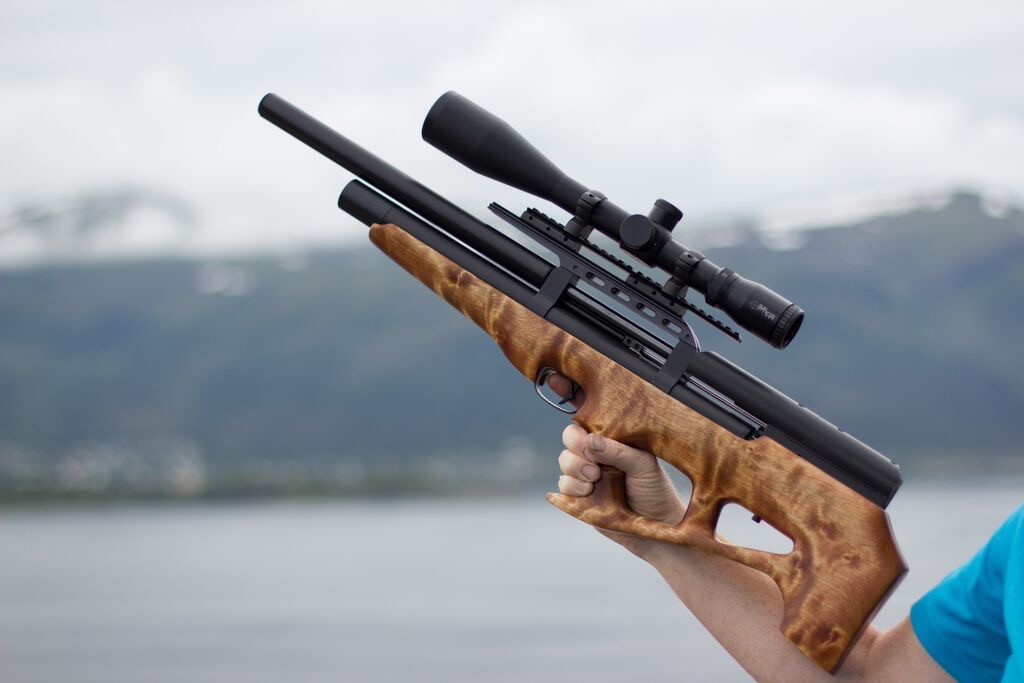

ImpressiveThis was my first FX Wildcat stock, made out of Flame Birch some years ago. I used a coffee mix in the sanding process to lift the grains. Tools was what I had on hand at the moment, and mostly the same I use today. The most time consuming part is the in-letting for barrel/cylinder/action, and my advise is to start with that after cutting the outer profile.
Here are a couple of pics - and yes....... there is ours between those two, but you will never regret the effort you put into it.
This is very important. It's tempting to do want to do the easy and visible part first and shape your stock, but the inletting is the hard part and you're going to want to have nice square outside edges on your blank so that you can clamp it securely and measure accurately when you're doing the inletting.The most time consuming part is the in-letting for barrel/cylinder/action, and my advise is to start with that after cutting the outer profile.
