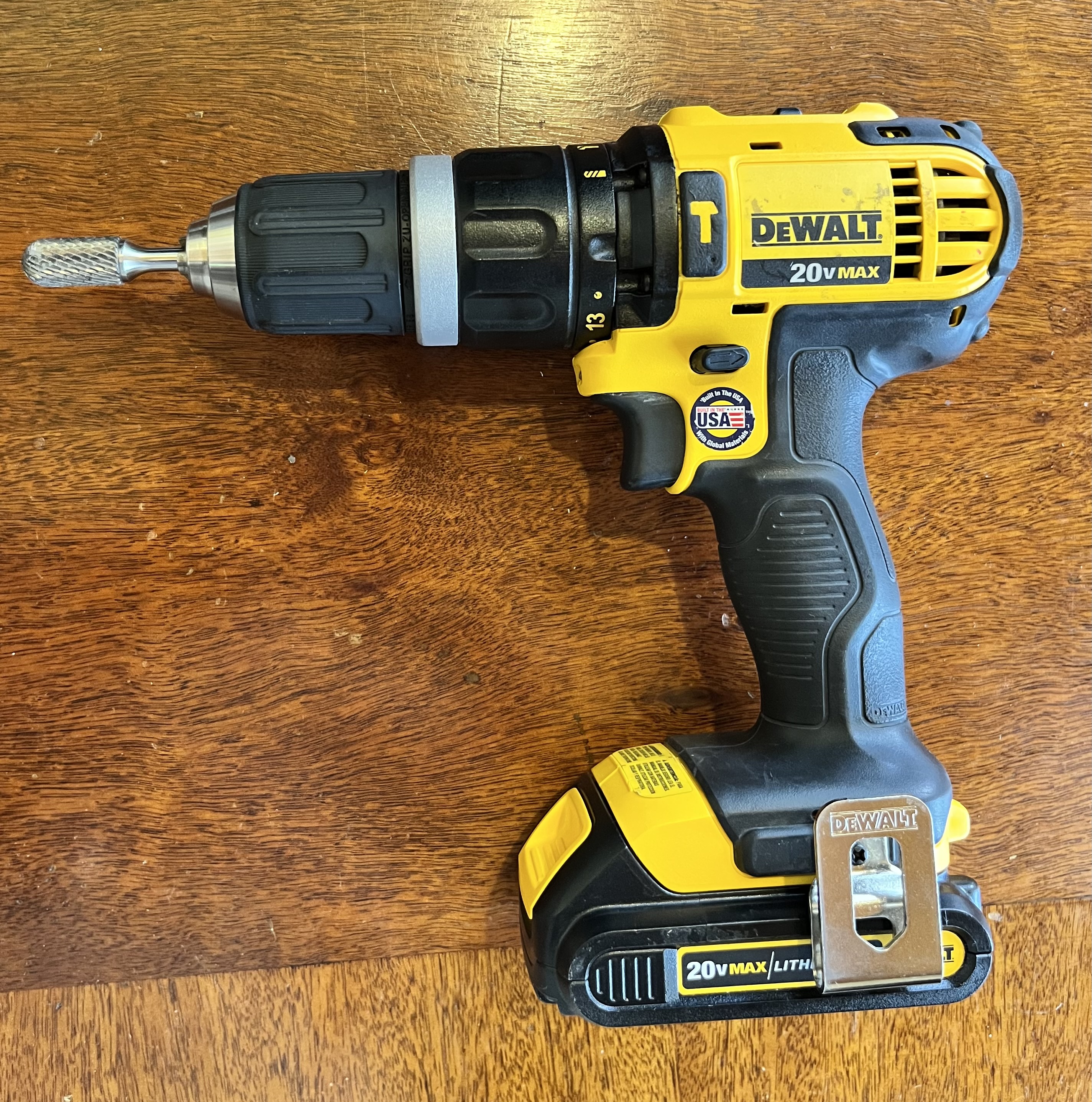

Two very easy and quick things:
- Recrown the barrel; and
- Made the exit of the shroud a little bit wider:

Wow! That is some great improvement, I am just now starting to work on tuning my new Panthera and haven‘t done and groups on paper yet. How did you re-crown the liner? What method did you use to modify the “ exit of the shroud” to make it bigger? Thanks for sharing your results.
Kenny
Some years ago I bought an strange drill tip. Later on after watching on YouTube how to recrown a barrel, I decide to use my strange drill tip to do so.
The result is amazing in 100% of the cases I have used it (that are many!).
