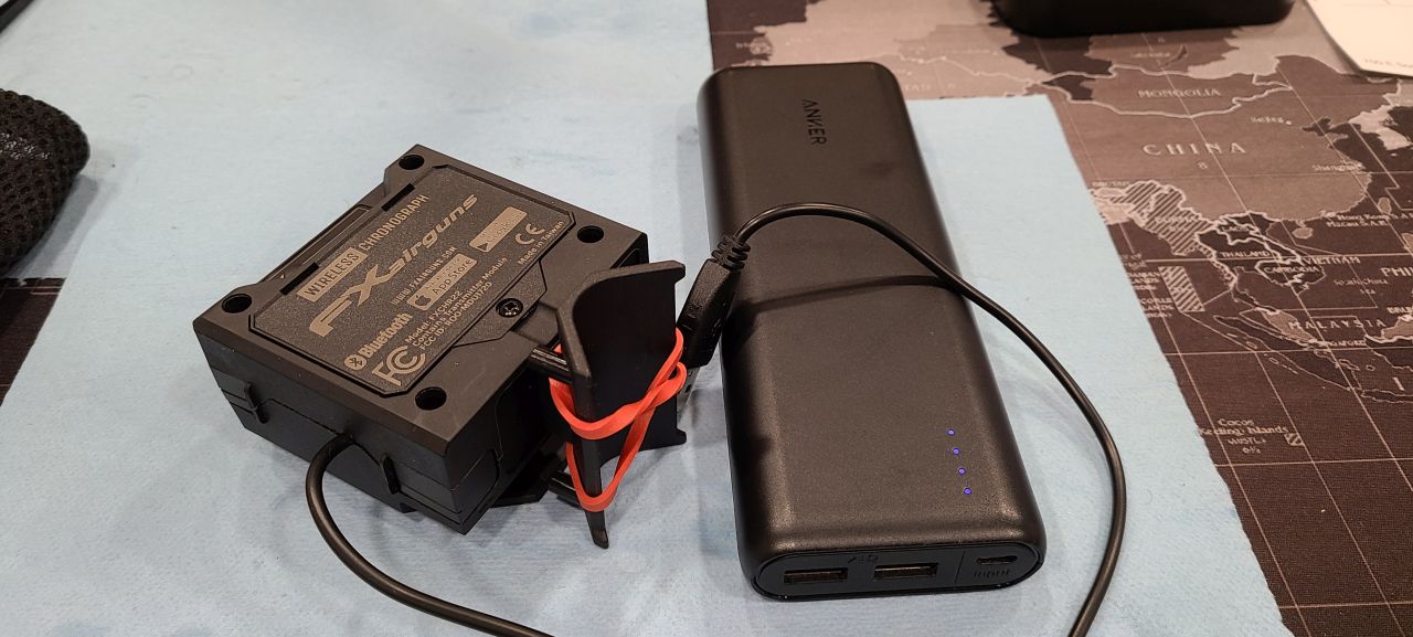

And for all you guys with the two complaints of batteries getting eaten up and the pain in the arse battery lid screw, just convert over to permanent batteries wired in series, and providing you with a usb plug. At home I plug into power via a usb ported plug, and while remote I plug into a battery power pack that lasts a long time!
What I have taped to the chrono is just the extra cord tape that comes with the batteries. Wound up the extra and taped it. I never worry about swapping batteries or charging up rechargeables.

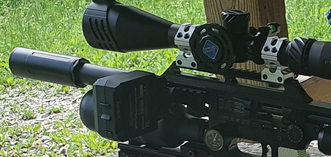

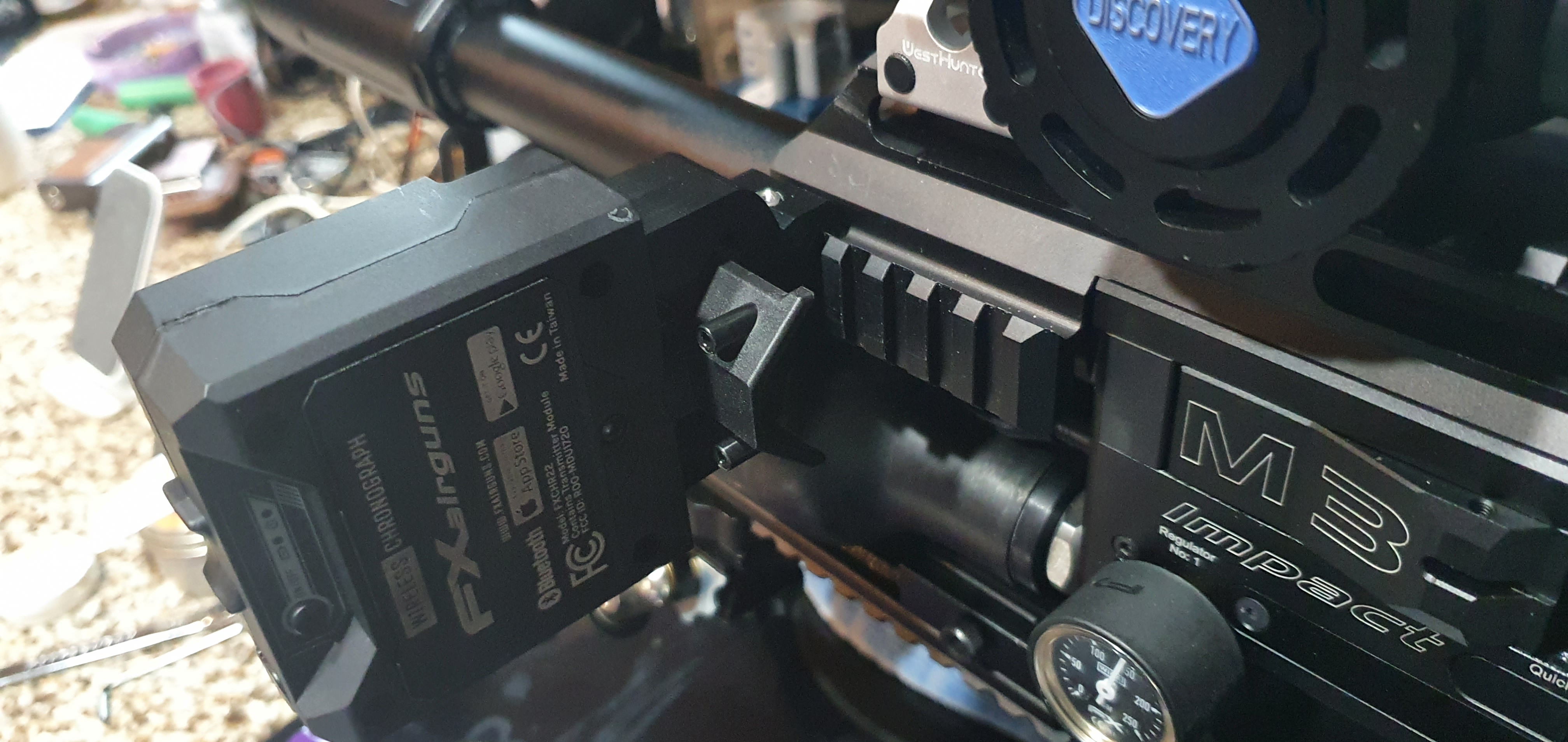

i see alot of guys bashing the fx chrono,
i have one,
and to me its literally the best thing ever.
being able to go out on the porch at night and run some strings,yes please lol
of course i understand stuff happens, defect/damage/etc...
placement seemed to play a big part in it functioning how it should,
with it vertical
(such as when banded to the muzzle)
i had a few hiccups.
when i mounted it horizontally on the front side rail on my impact it worked every time and has ever since.

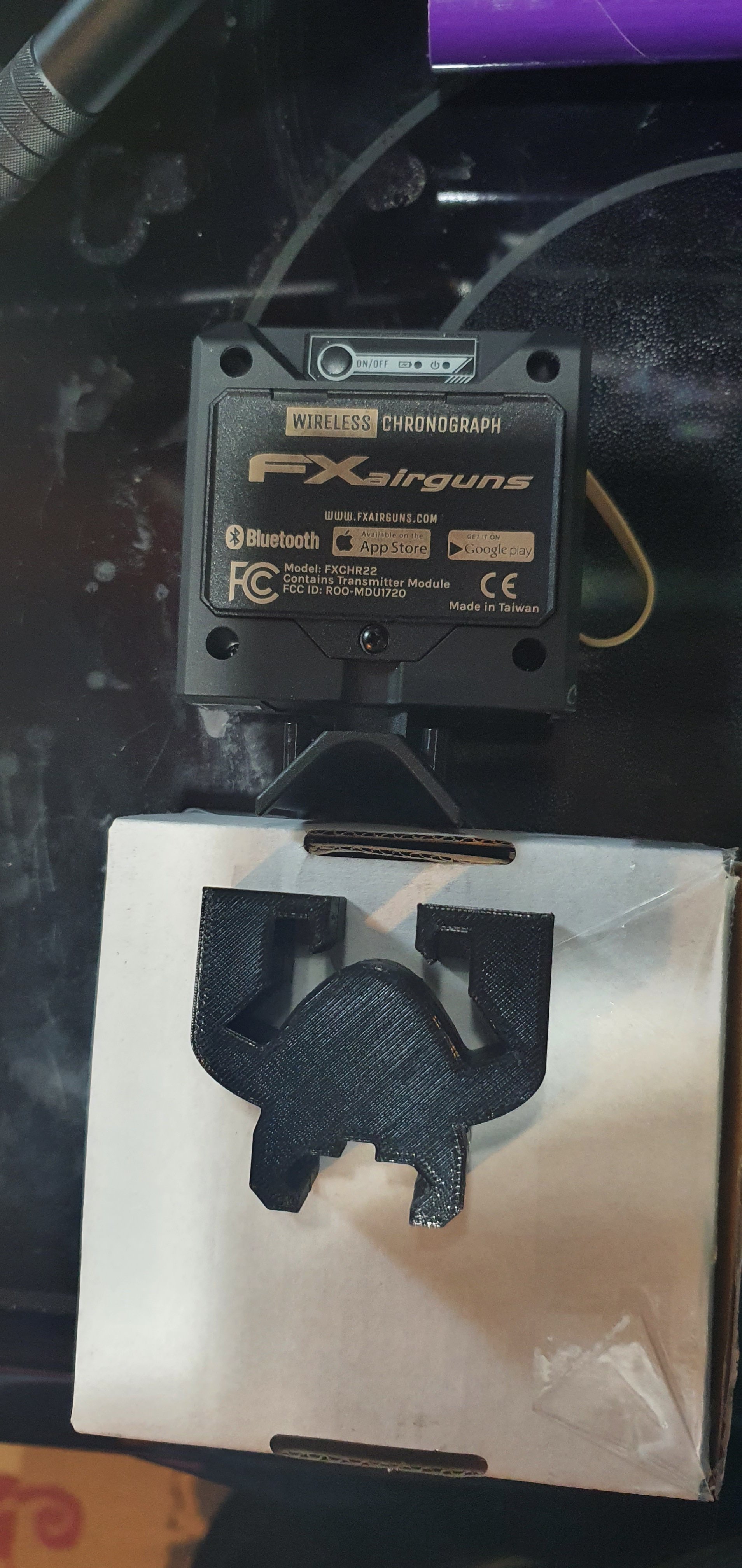

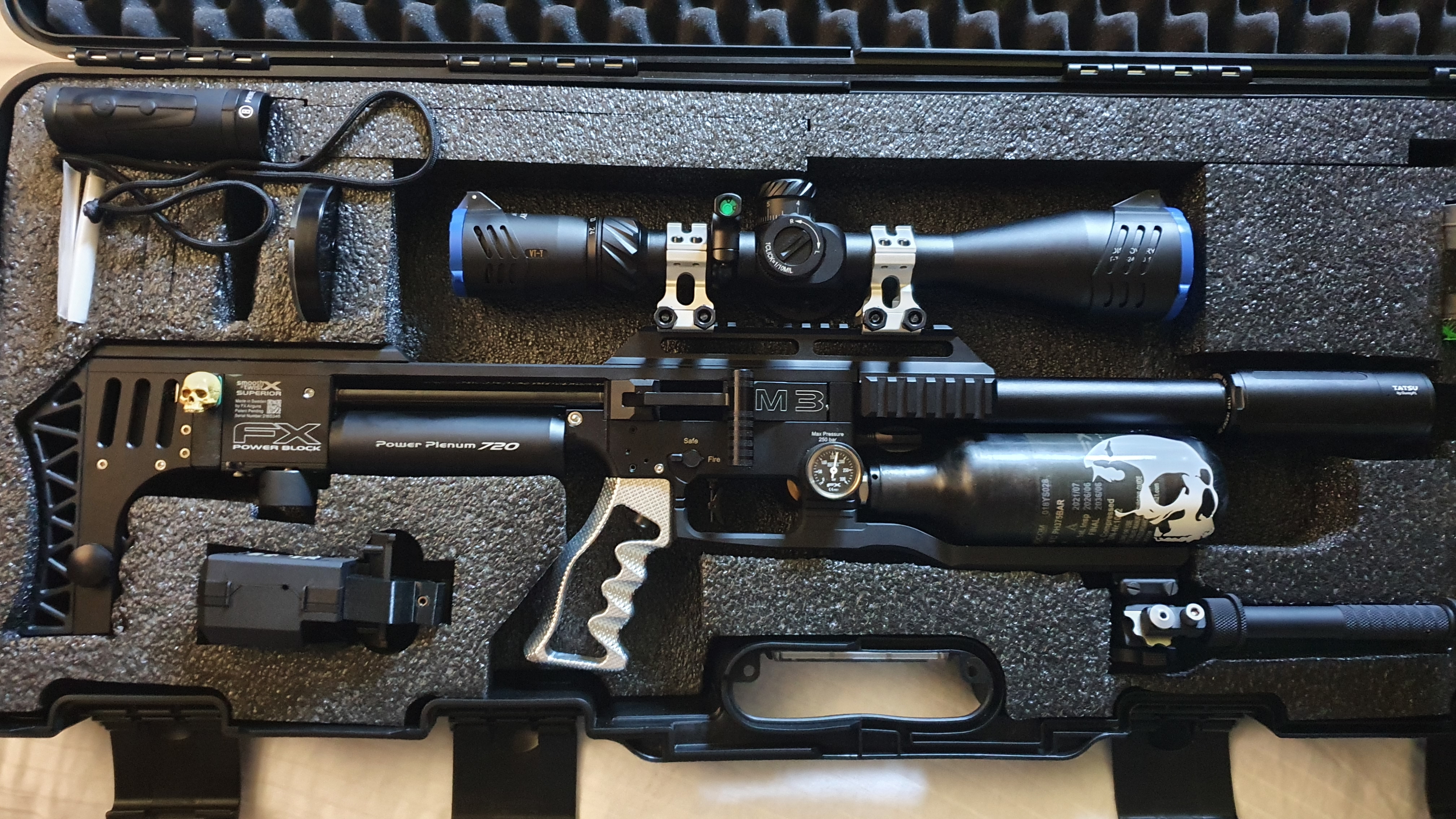

Can you post a picture of this mounting?
sure thing.
its from midwest elite airguns.
heres a few pics,and the link to it.
i leave it attached to the chrono,
it fits into my impact case perfectly so bonus there too.
