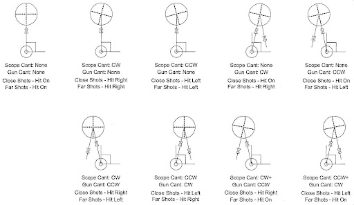

Cant does affect shots a lot more than most understand. I attached a guide that is pretty radical but you get the point.
