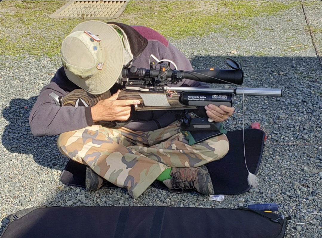

This is @Motorhead, using the "dead man" position for field target.
For certain classes of field target, this position is utilized by many of the top contenders. Sure doesn't look like anything resembling rifle shooting "form" as anyone outside of field target would define it. But they practice it and use it to good effect during matches.
To bring it back on topic, if my ear was on my knee during shooting, and my optical sense of up and down was all out of whack because of that crooked neck, I could maybe see the benefit of utilizing a bubble level.
