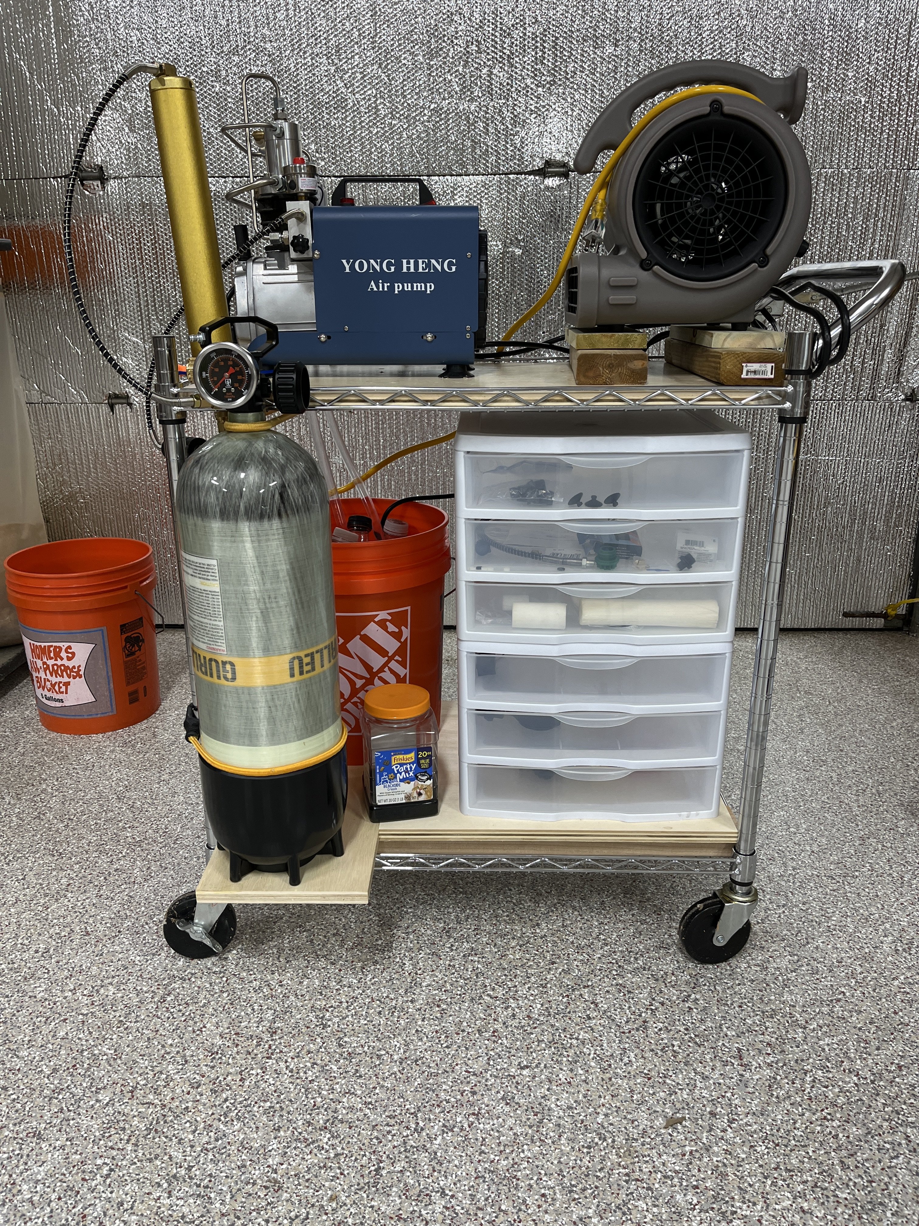

How Long Can I Run My Yong Heng?
I've had mine running for about 2.5 years now. Has about 112 hours total time on it filling to 310 bar each fill. Burst disk "Pop" pretty much anything over 4500 psi. Some before, some after.
Average temp is about 58°C for until I hit 3500psi on a fresh fill for either 6.8l or 9l tank. After that point, she steadily climbs.
I purge about every 7-10 mins. (My basement environment is pretty dry due to the running of 2, 50 pt dehumidifiers.
I run the YH sitting on a 3/4" thick rubber pad. Really knocked down quite a bit of transferable vibration to my work bench.
In summer months when the temp is higher, I'll drop a frozen 2ltr coke bottle in the 5gal bucket of cooling water. During the winter months, my basement is cold. No extra help needed then.
In the beginning, I would take every precaution and shut it down after 10 mins, let it cool for 20 mins, rinse and repeat. 😊
Now, I'll let her run for about 25 mins keeping an eye on the temp gauge. Purging the separator filter still every 7-10 mins. When I let it cool, I let it drop to 38°-40°C.
I figure I've gotten my 200 bucks worth of use out of it so.... If it dies, I've got another sitting in waiting on the shelf.
Running Royal Purple oil, changing it every 10 hrs of use. (Yes, I keep a written log with time stamps.)
From my data logs, I can see she's slowing down a bit. I'm honestly surprised its lasted this long. 😊
This is my setup in my work room.
