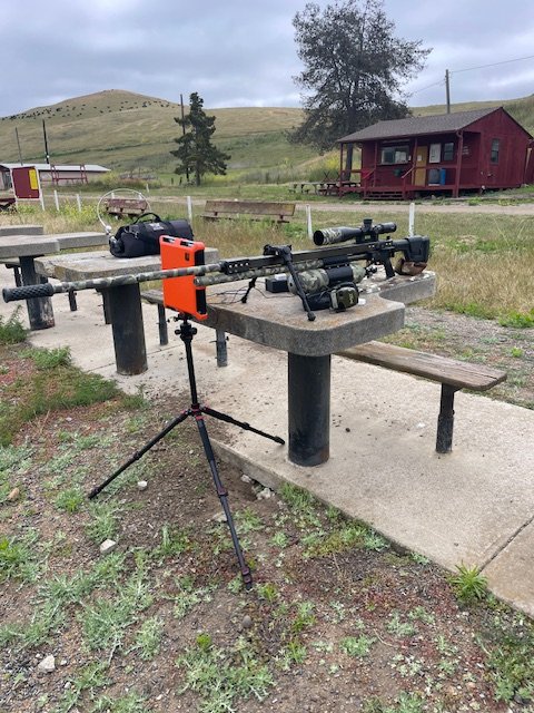

It's not 700mm. 1050fps with CPHP 14.39gr, 938fps with 18.1gr pellets.

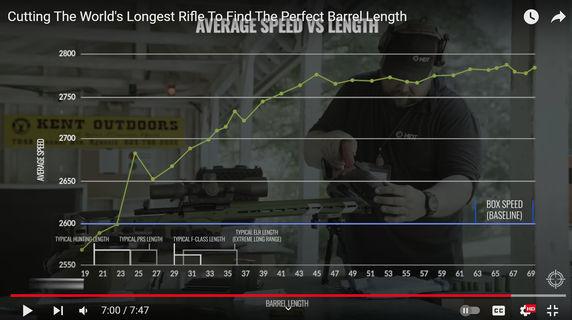

There is a point of diminishing returns for barrel length relative to pressure, friction, etc. I've seen tests done on PBs where they plotted the results at different lengths and there is a clear plateau and then a drop off eventually. For those PBs it wasn't crazy lengths, either. Pressure dependent, but they were seeing the plateaus at fairly reasonable lengths of 24-28" if I recall. Even less for some setups. So there is a reason the manufacturers choose their barrel lengths for full length rifles. Some of their testing was on YT, so you could probably find it with a search. It would be interesting to see similar tests done on the airgun side.
Spartan,
The image grab below may be from the video you mentioned. It is on the MDT Sporting Goods channel. They started with a 6 foot long .308 Win barrel, and shot 175 grain factory loads to capture the velocity as they cut the barrel shorter incrementally. The results may be different from what you remember:

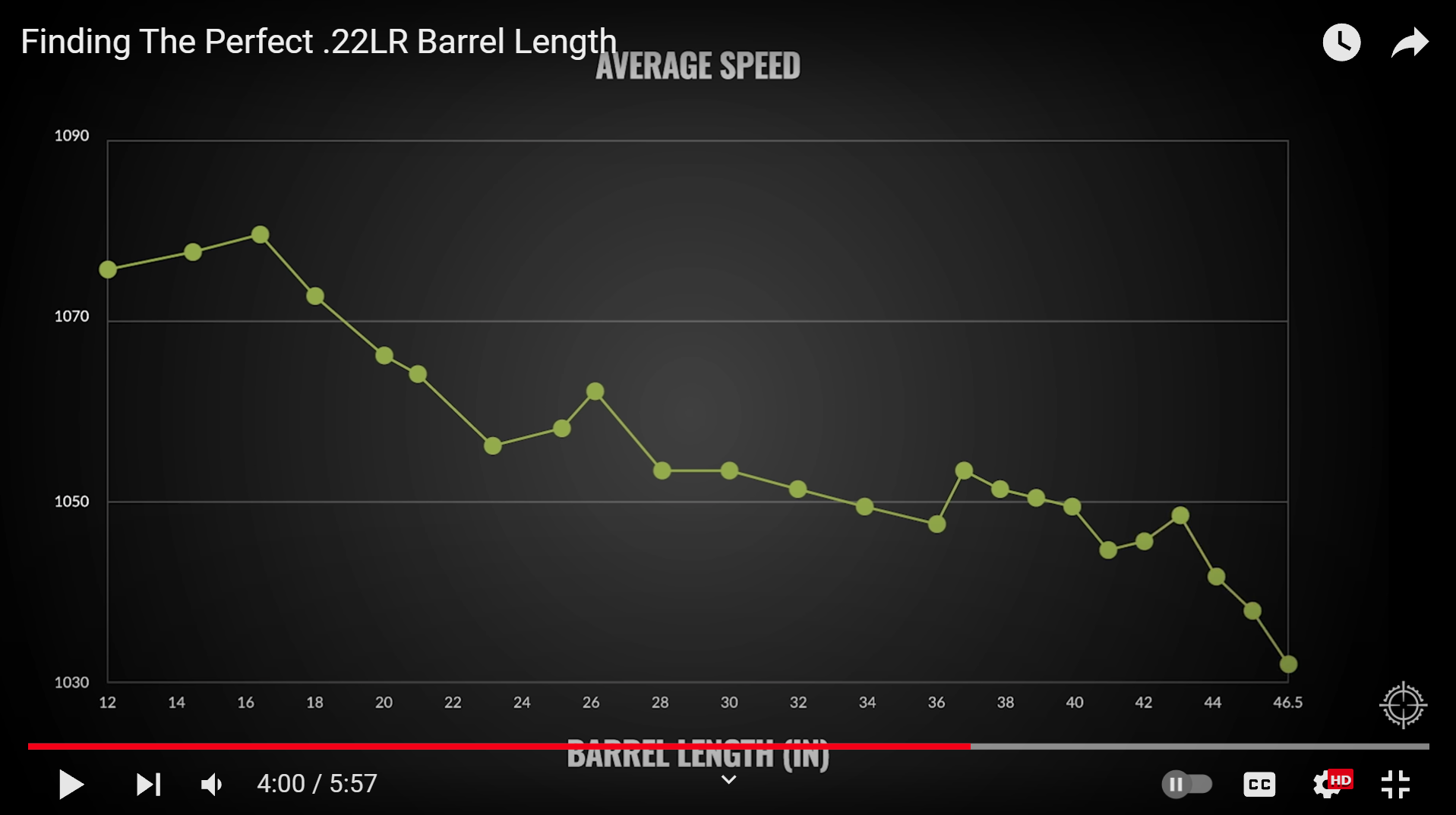

They also did a similar test for .22 LR:
I am not posting active video links because I do not want to violate the firearm discussion forum rule. If you are interested in watching the videos, copy and paste these partial links into YT, or do a google search on them:
watch?v=XCqa2umL8ME
watch?v=xB6izQ8bkq8

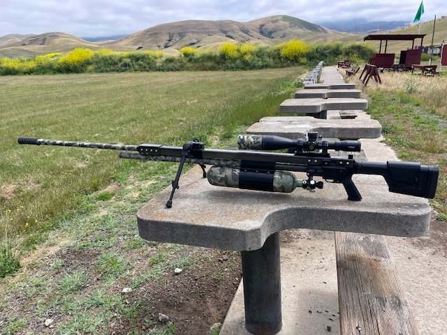

Unwieldy is in the eye of the beholder, and depends on the main purpose for that airgun. Scotchmo's .308 shown above is not unwieldy as a long range bench rifle. It would probably be unwieldy to shoot offhand or walking around a hunting field. There a 600 mm barrel sounds much better.
