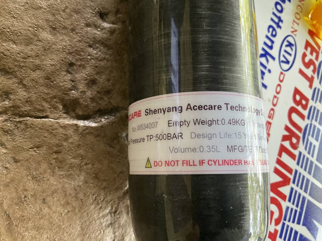

How many cu ft is my .35L tank
How many cu ft Is my tank?>
If my math is right a .35L tank should be about 3.1 Cubic Feet.
