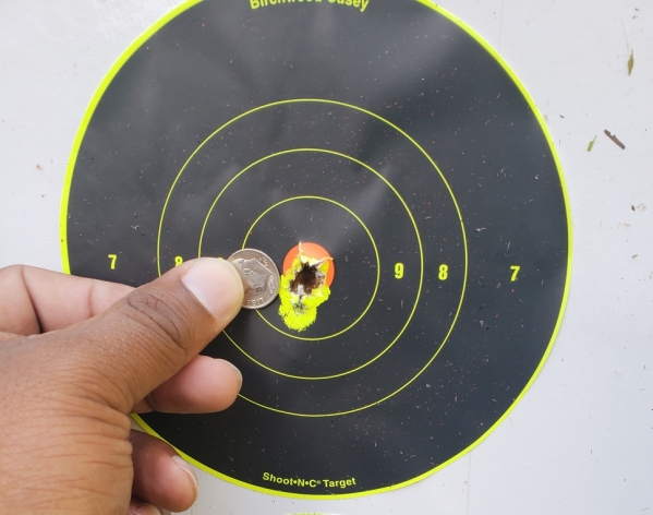

At the end of testing the other day I tried some out of my Gauntlet and they grouped well at 25. Was finishing up for the day so That one 25 yard group was all I shot of them.
