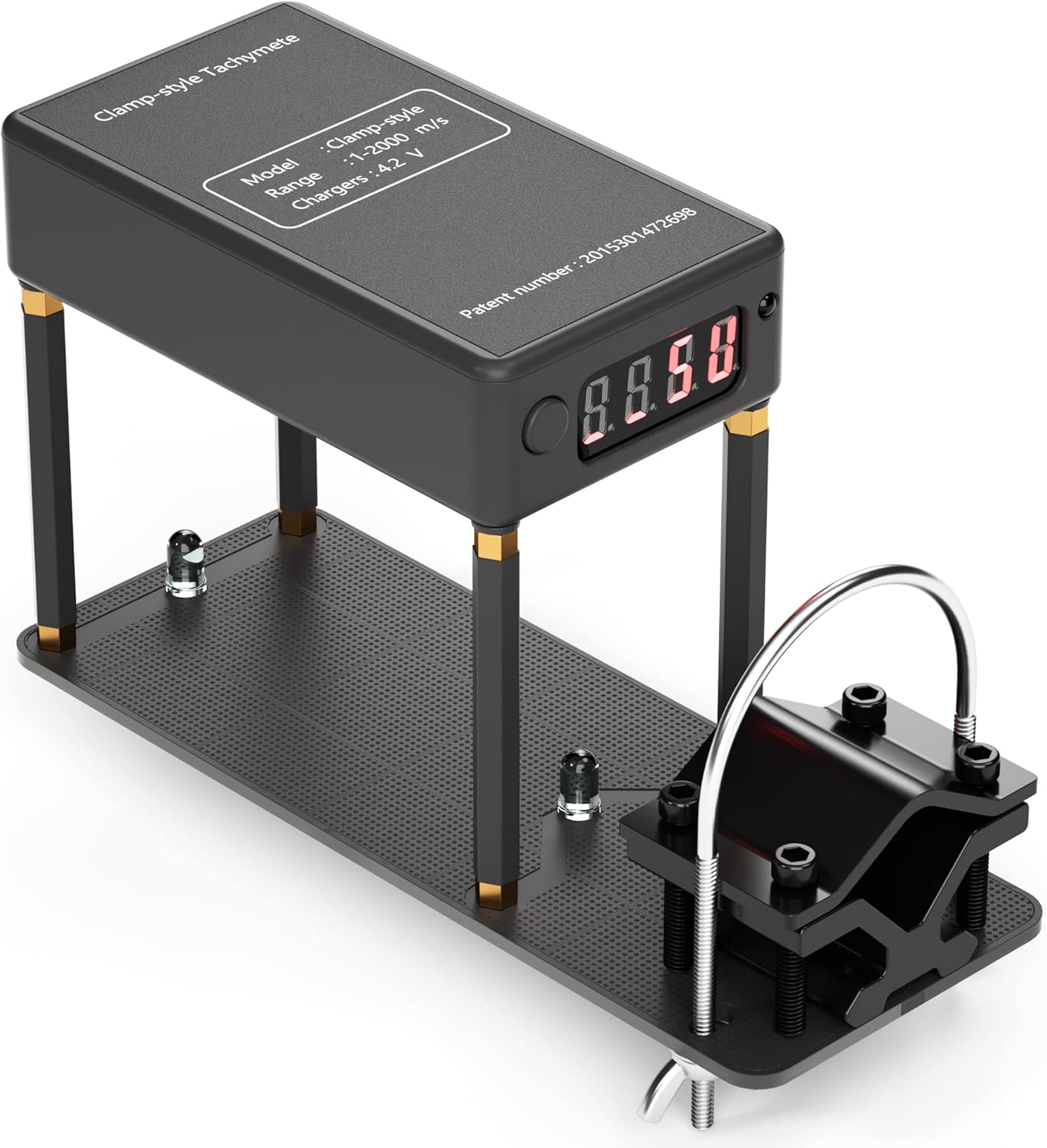

Is there a budget friendly chronograph that works?
I have this one and an earlier version that only measures in MPS (meters per second) with 3 digits and that really wasn't a problem.
I simply multiplied the reading by 3.28084 and I had my fps reading.
The one I listed works quite well for me, as does the older model, and all you really need to tune an airgun. It has 4 digit readout and capable of either MPS or FPS readings.
For about $30, you really can't go wrong. Or you can spend a fortune and not be any better. (smile)
