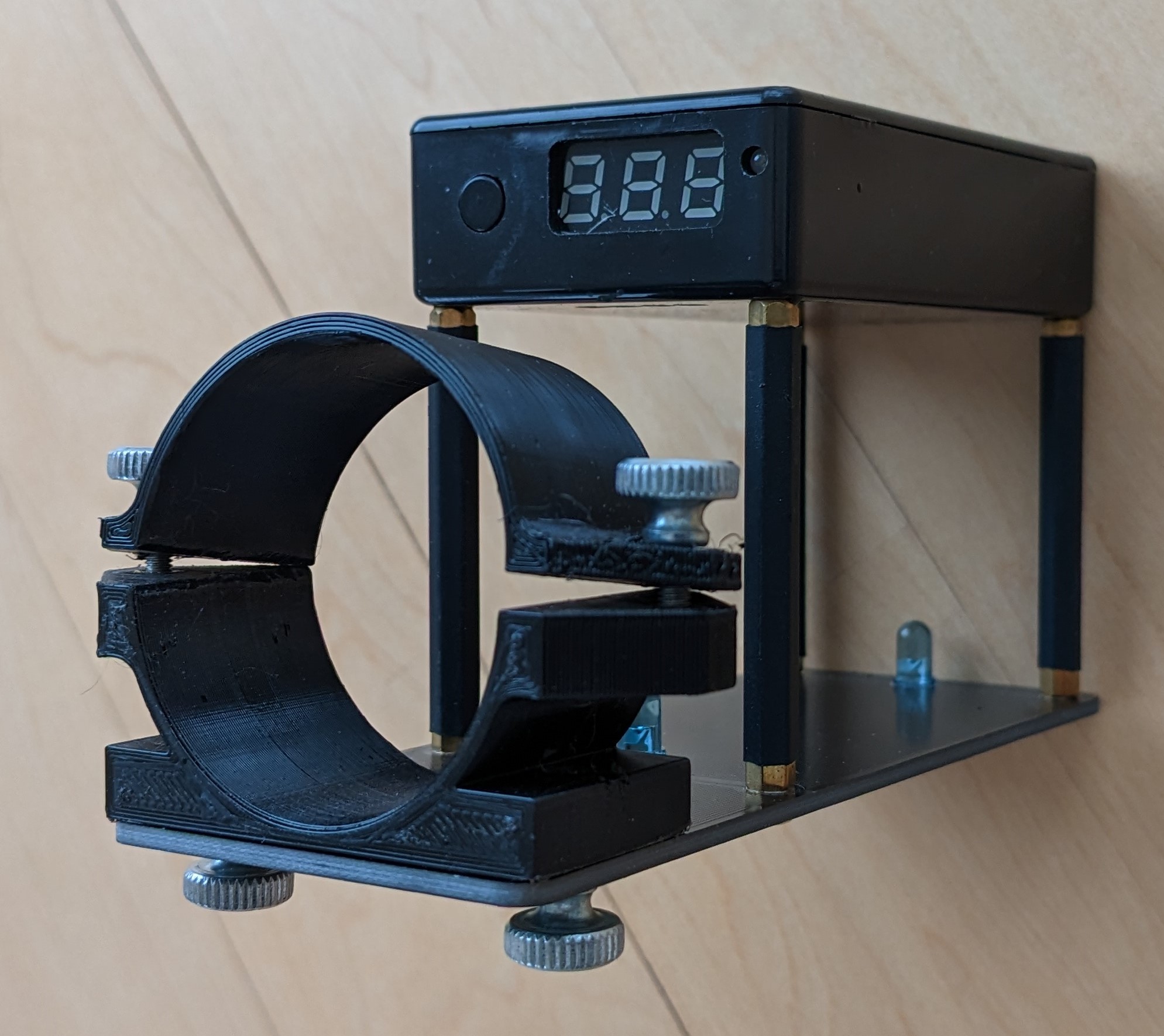

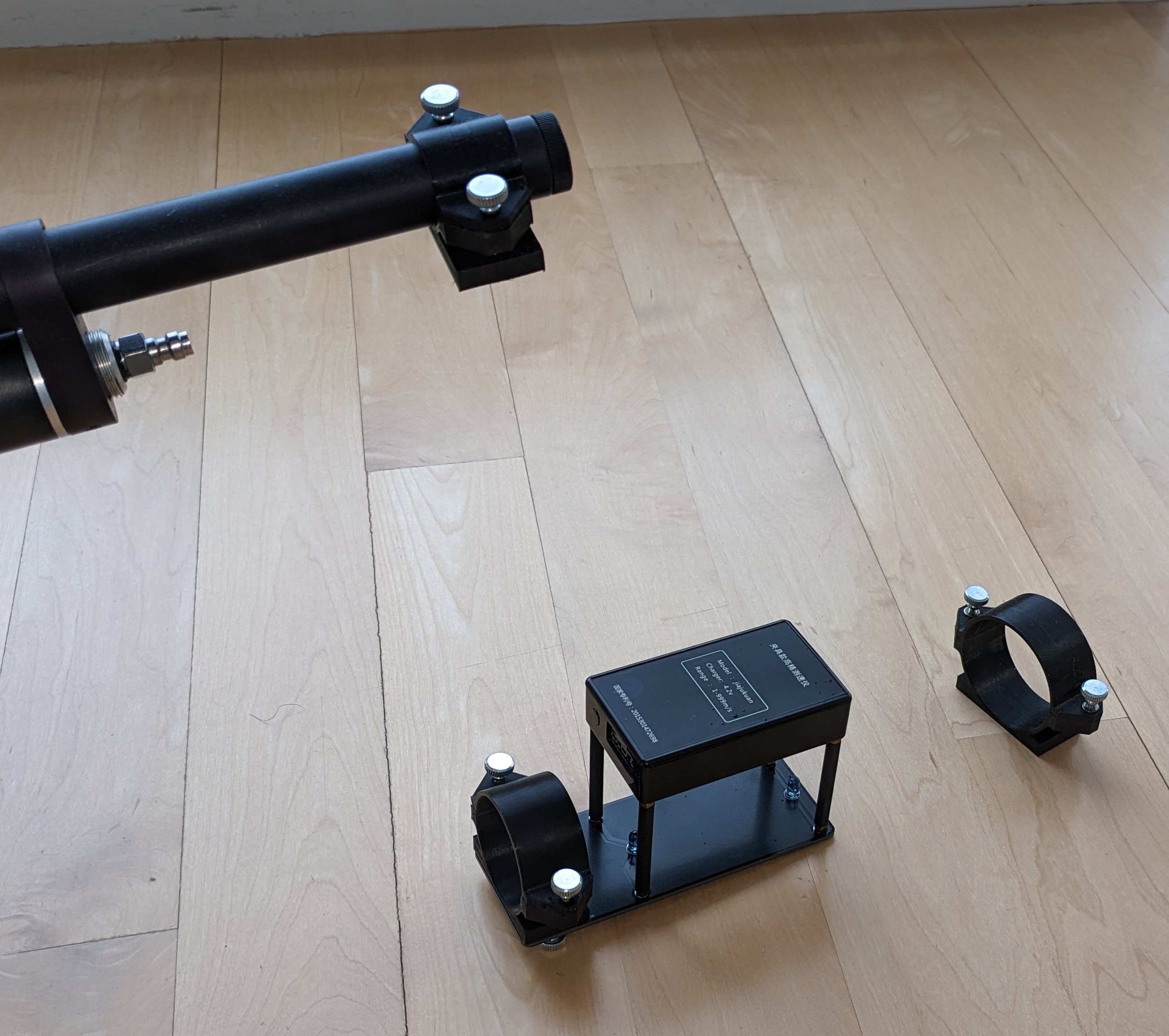

Cheapest one from China, easiest to use 40 shot memory, results matches my Labradar within a few FPS. The barrel mount is poorly designed, so I 3d printing custom mounts for each of my air guns. This is the one is use most often when tuning the hammer spring, because I can leave the stock off and pull the trigger pointing at my mulch box without aiming at a target which would be required if I used the Labradar. It has it faults as mine recently stop working. When I took a shot the LEDs would go blank and the unit seemed to turn off. I took it apart and the soldering is terrible. An average high school kid would do better. Resistors are mounted at all different heights and not flush to the PCB. Leads on the bottom sides not trimmed to a common length. Lead length on the bottom is used to provide the correct standoff height so the LEDs are at the right height. I figured since it powered down when shooting my 0.25 at 60 fpe probably because of the mild recoil it must of had a bad connection. Looking around I found one of the wires from the battery to the PCB had a cold solder joint which I repaired. That seemed to fix it. So seeing the poor construction I wouldn't buy one if you are expecting it to work all the time. Need to have great return policy, or willing to write the buy off as a total loss, or repair it yourself.

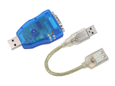

Hi..can this be used to generate chrony data on a pc.my alpha shooting chrony has a dead video display unit .also does it require some driver to be downloaded?i use a windows 11 pc

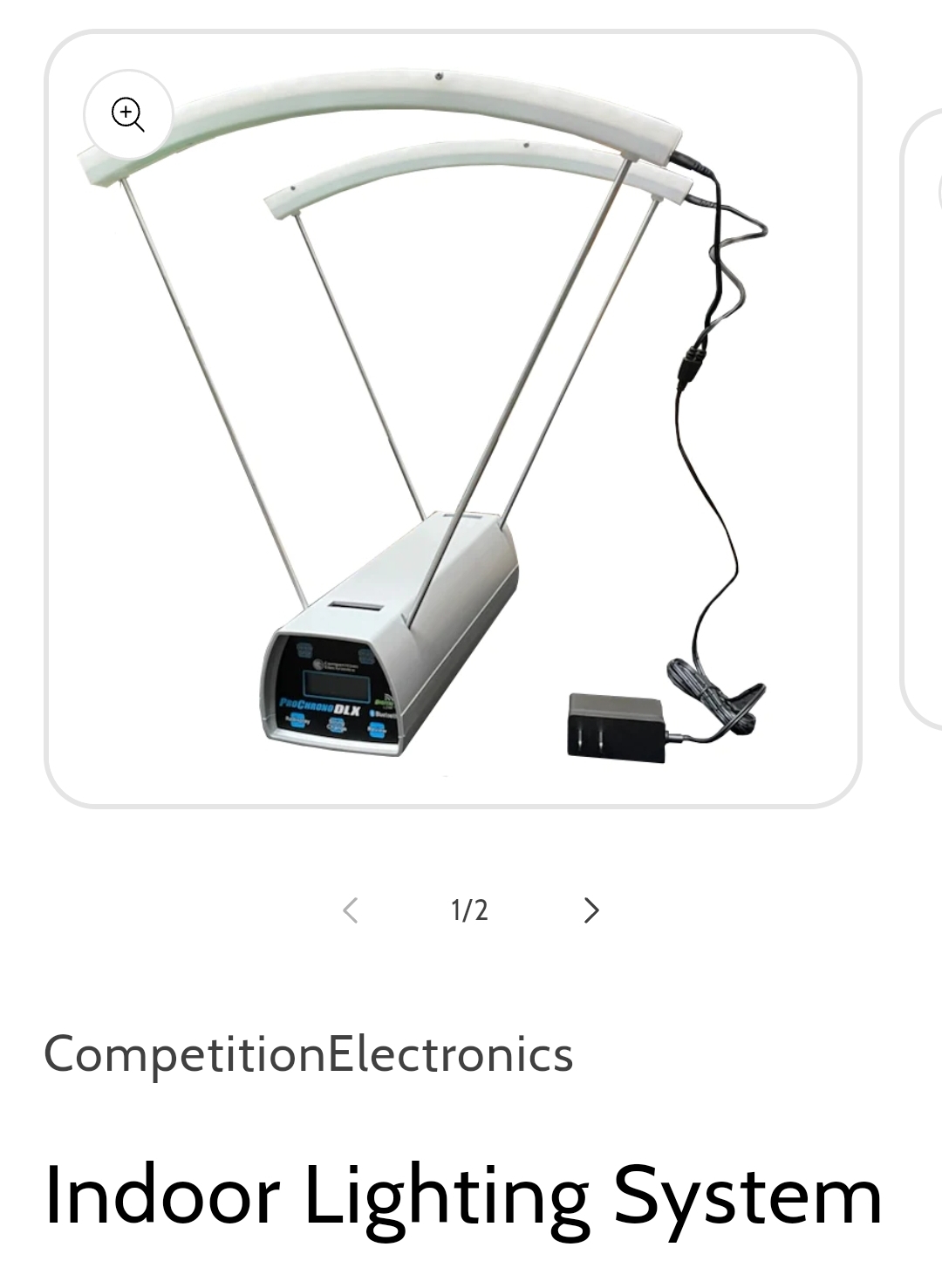

I have a caldwell that I have been using for the last 3 years. I noticed a year or so ago that the app stopped showing weather data. This spring when I connected it to my phone the app will not see the chronograph and record my shots, I need to try another headphone cable. I am now looking at the Competition Electronics ProChrono DLX Chronograph (bluetooth). I like to record my shooting sessions and it looks like I can download an app to my computer as well as my phone.

Competition Electronics ProChrono​
The infrared light kit [now discontinued???] was the BEST tool upgrade for tuning I made. No more wasted shots, super reliable results all conditions, indoors or out. I am happy with it.
Even if not a self-professed nerd like myself we all need actual speed numbers to calculate adjustments made or needed. Also gives an ethical hunter known power levels. A chrony of some kind is an absolute necessity.
They still show it as available on their own site. I can say I goobered up, shot a light bar out and for $18 they sent me a new one that week.
