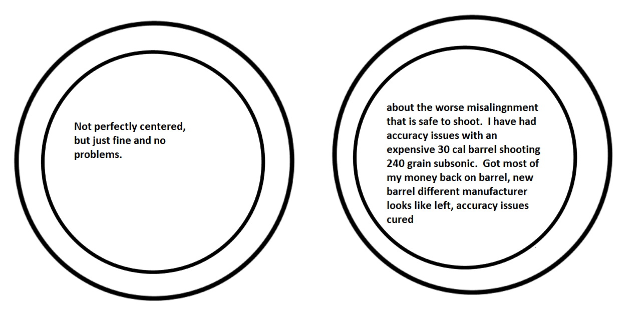

Awfully tight, I wouldn't do it. Commercial PB will not go below about 0.05 over bore size, and many/most not even that. Custom built for a single rifle never to be used on another where the machinist does both the rifle barrel and suppressor to assure close to perfection, they sometimes go tighter than that. But at least in PB land, going tighter essentially makes no difference, correct meters for impulse noise(thousands of dollars for a real meter) have shown that over and over again ad nauseum but people just won't listen. Case in point, my >1k 30 cal suppressor has an end cap of 0.380x" where x is at least .0005 (can't measure tighter than that with my tools, I just measured it after writing the previous sentences t,hat is greater than .07 over bore which is pretty much the norm for commercial suppressors.
You can have a safe to shoot alignment of suppressor/rifle bore but have accuracy/consistency issues if it is off enough but still safe. I had issues with an accurate 30 cal shooting 240 grain bullets subsonic, it was just fine without the suppressor attached, and the suppressor bore alignment was fine by manufacturer's drawings. I sent pictures with alignment rod to manufacturer (lawyers..) and they said it was fine and safe but refused to comment on any barrel manufacturer for the most part. Got on the phone with them, and they went so far as to say "we have not had any problems with that manufacturer" when I went through a list of pre-made barrels, but no other comment at all. My barrel they made no comment... Took a while but I got most of my money back and bought an actually slightly cheaper well known barrel that the supprossor manufacturer on the phone said they never had issues with them. Solved my problem, only wasted 100 dollars, give or take, in bullets/primers/powder chasing my tail before. Picture is roughly my alignment now, with a safe to shoot alignment that with my combination of equipment led to accuracy problems.

I was talking PB land, I don't know how much translates to air rifle land, but shouldn't be too much different. I actually had a machinist freind cut me an adapter for my big 30 cal suppressor mount so I could put it on the uragan barrel. I put it on my uragan compact with the shroud removed, it was as quiet or so close as it was irrelavent with the 30 cal endcap on, the alignment was good so I put the 22 end cap on and it was probably more quiet than the uragan with the baffled shroud, and as quiet with the baffled shroud + adding on the uragan suppressor on the end. Lower muzzle pressures in general with air rifles, and smaller volume of gas except in rare cases. The most quiet suppressed PB I ever didn't hear, was a friends 1920's winchester pump .22 short only gallery gun he inherited from his grandmother a few years after his grandfather died. Without the suppressor on the end of the barrel, it was more quiet than a standard 16" 22 rifle with a really good suppressor. Put on the 1920's tiny little suppressor, shorter than my little finger, and smaller in diameter than my little finger, with I think 5, maybe 6, small pressed spring steel baffles in it you could put your ear 2 feet from the muzzle and hear a very quite push of air that you could do way louder with your mouth blowing for 1/2 a second. There are always exceptions to the rule, the muzzle pressure on that 18" 22 short rifle was likely significantly less than a 10 meter olympic air rifle.
