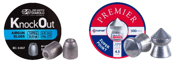

...Pellets traditionally have a rounded nose, or at least most of what is used for FT, while slugs tend to come to somewhat of a point. The slug is imparting a greater point load to the target due to its smaller nose diameter and residual energy.
