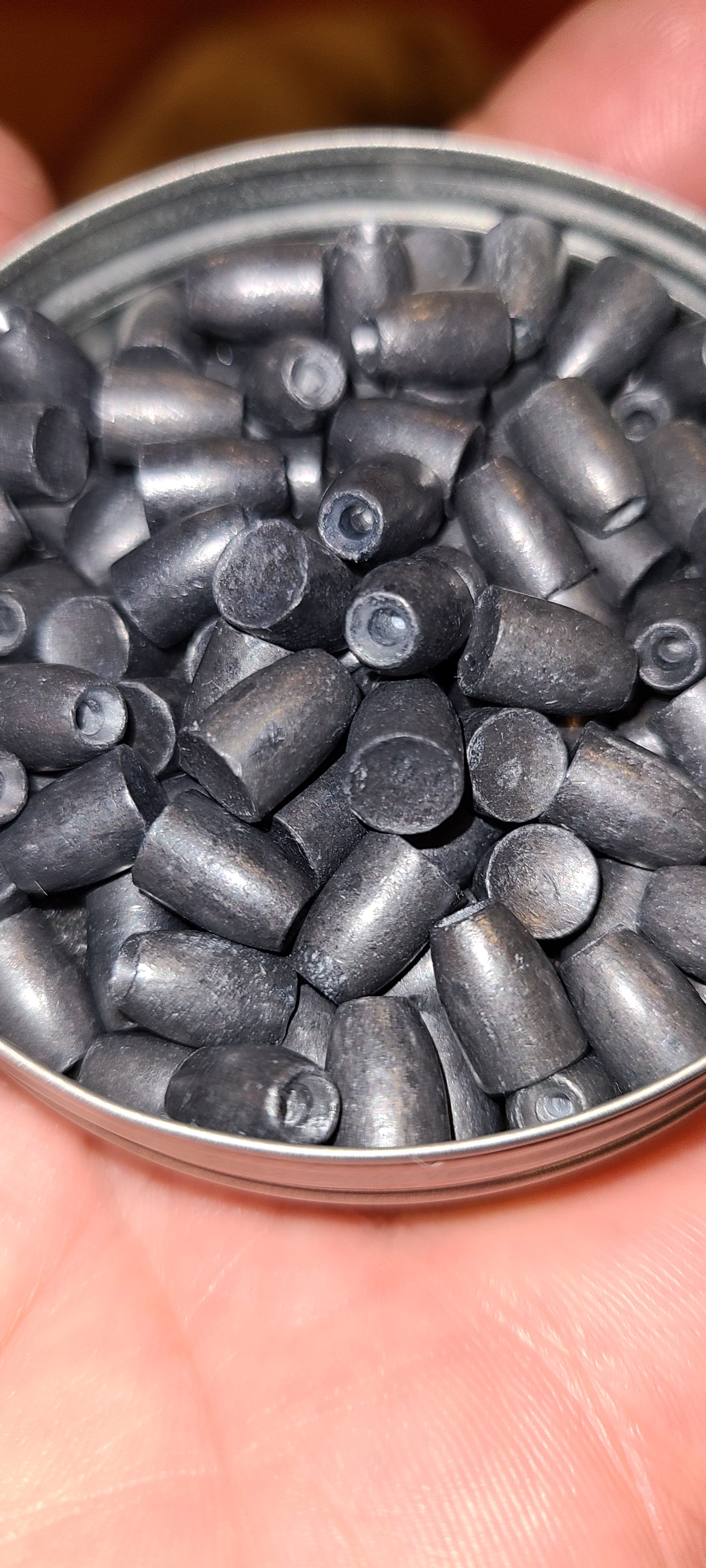

In this video is my .25 M3 shooting a H&N 40gr Heavy at a 8 inch cucumber at 28 yards, 77 ftlbs on impact.
This is why the 40gr heavy is my new favorite hollow point for pdogg'n !
