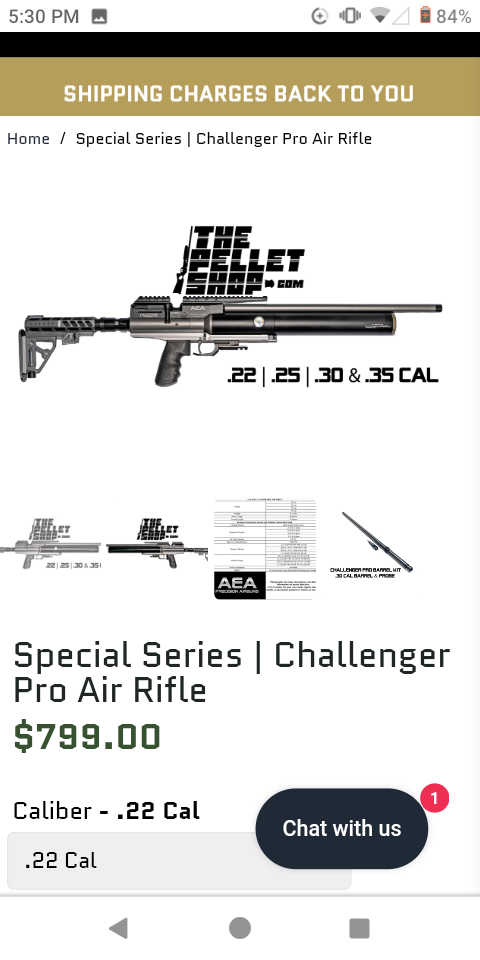

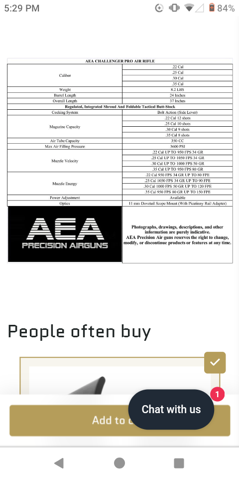

Aea challenger pro isn't quite there in 22 but in 30 and 35 cal is right there at the power level your looking for the only other option that I can think of in 22cal is the fx panthera or the impact but those cost quite a bit more but are absolutely worth every penny if you got the extra coin on hand another thing that you might want to consider with a high power setup is a compressor and for that the fx brand compressors on Amazon are cheap and very good I've had one for years and it's still running strong hope this helps
