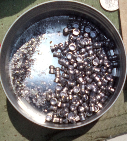

Skimming through pictures found this one and a tin like this its worth washing and lubing them up before use..lol
But to add to what i gave above i do it if i find extra dirty tins or if i open a new tin and they dont seem to shoot as good or i feel there off..? ? Not every tin just ones that seem like they need help..
As far as the lube i use i just use Alphabet org like type f or dextron. I also " shoe shine" buff them well in a lightly near to dry Alphabet org rag .. you can dang near see your reflection off them😉. This is just one of the things everyone has his way and you just find whats best for you
