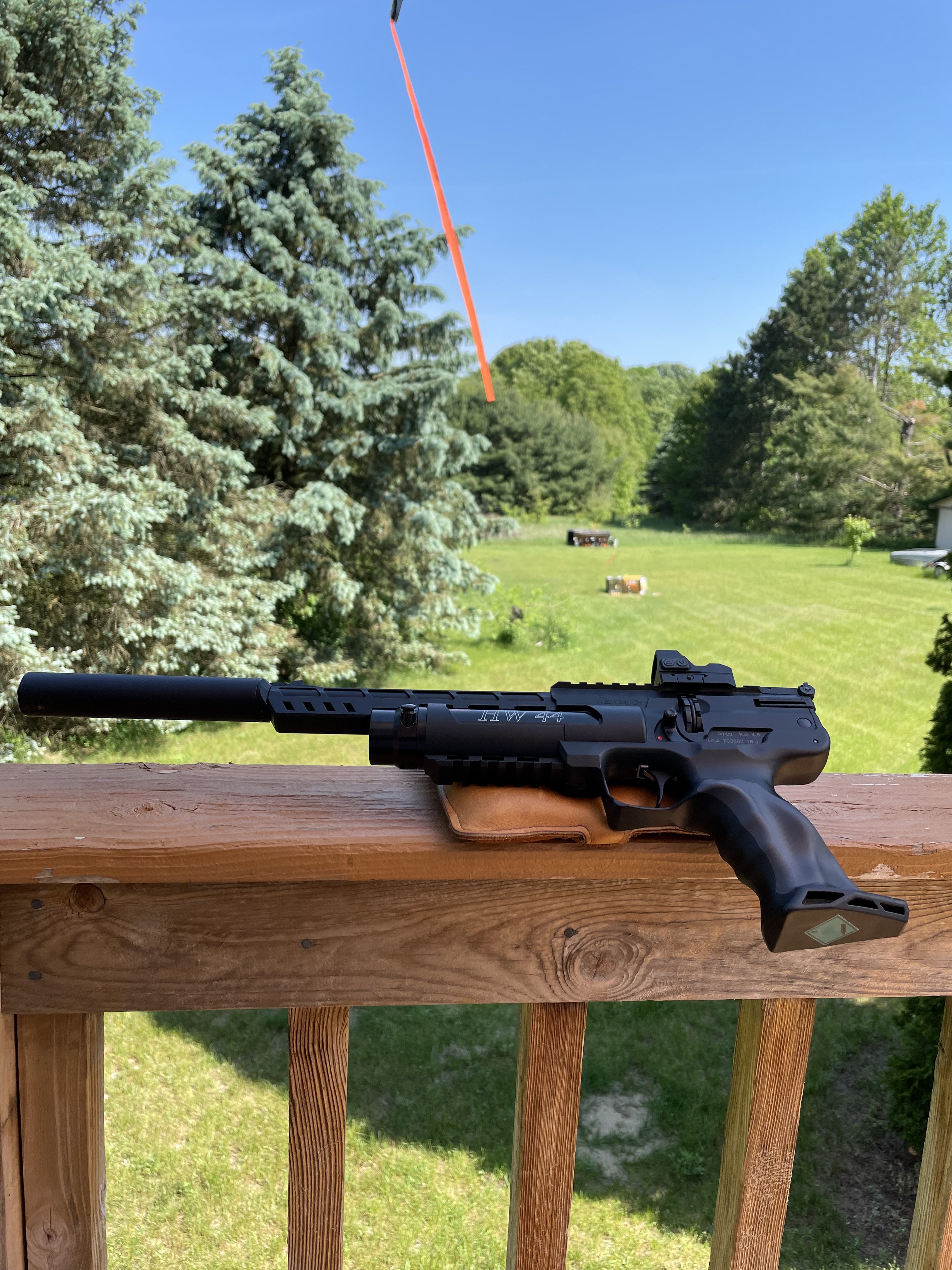

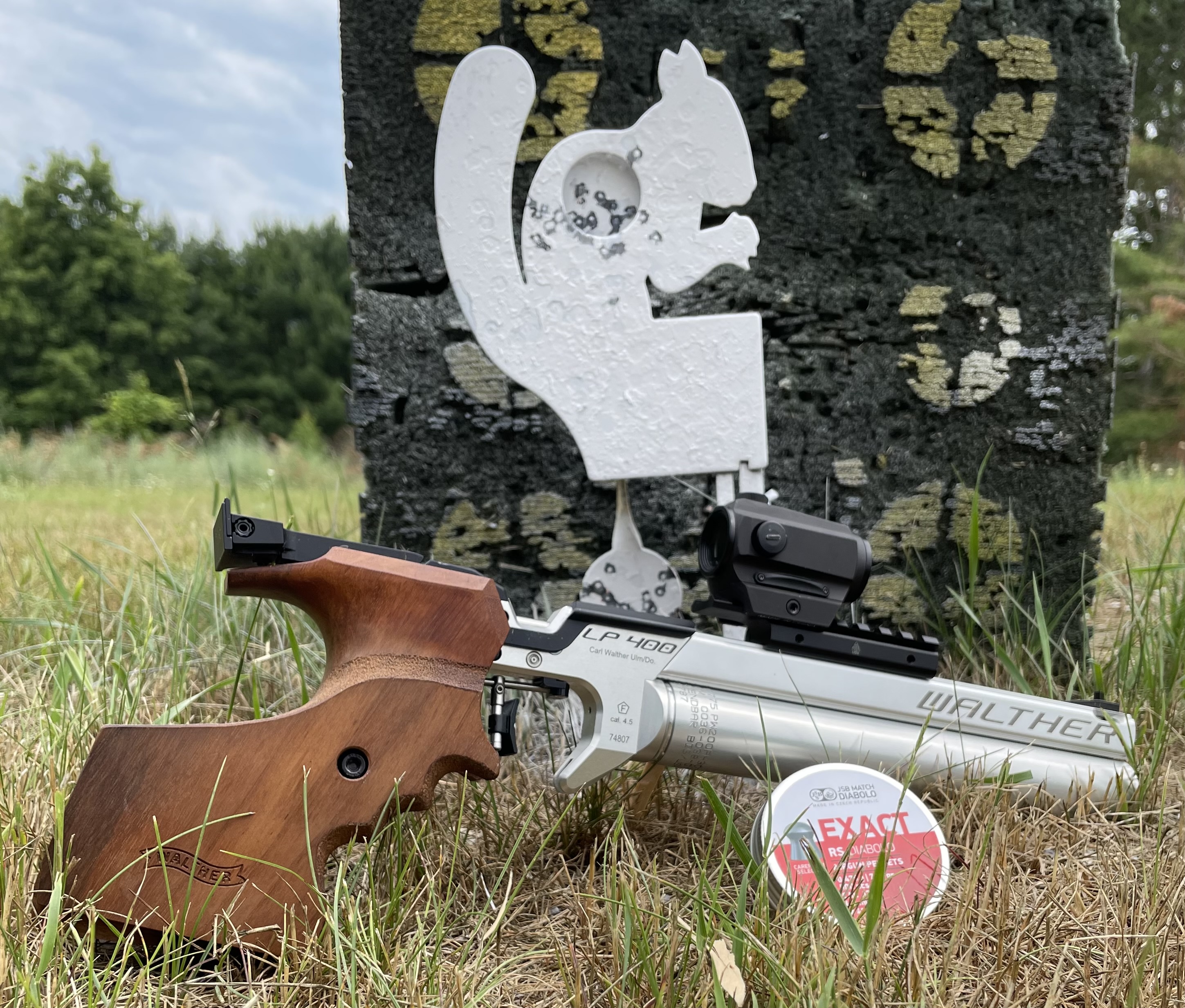

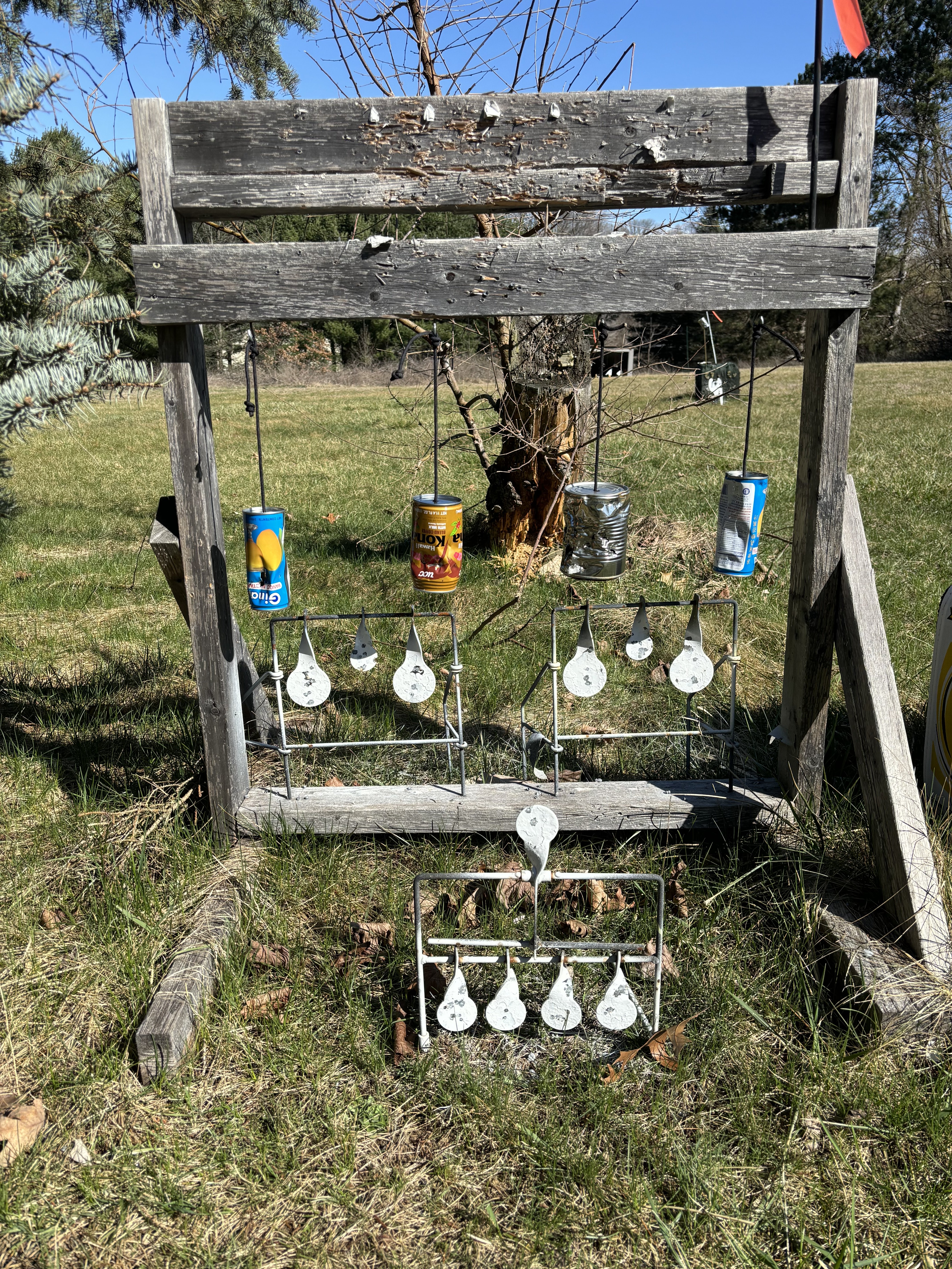

The dueling tree sounds like the main issue here. I suggest toning down your targets to the Crosman field target. I can trip this thing with a 3 fpe pistol at thirty yards.
The HW44 is quite awesome, I have mine set to left handed. Very accurate, can smack cans all day long at 55 yards with a red dot.
Look into the Crosman 1701p for a great backyard shooter. Can also be set to left handed. Bone stock it can reset the squirrels at 20 yards. Gets 50 shots per fill.
Pistol range at 20 yards;
The mighty HW44
The LP400 at 30 yards
Moral of the story, you don't need a lot of gun to have fun in your backyard.
