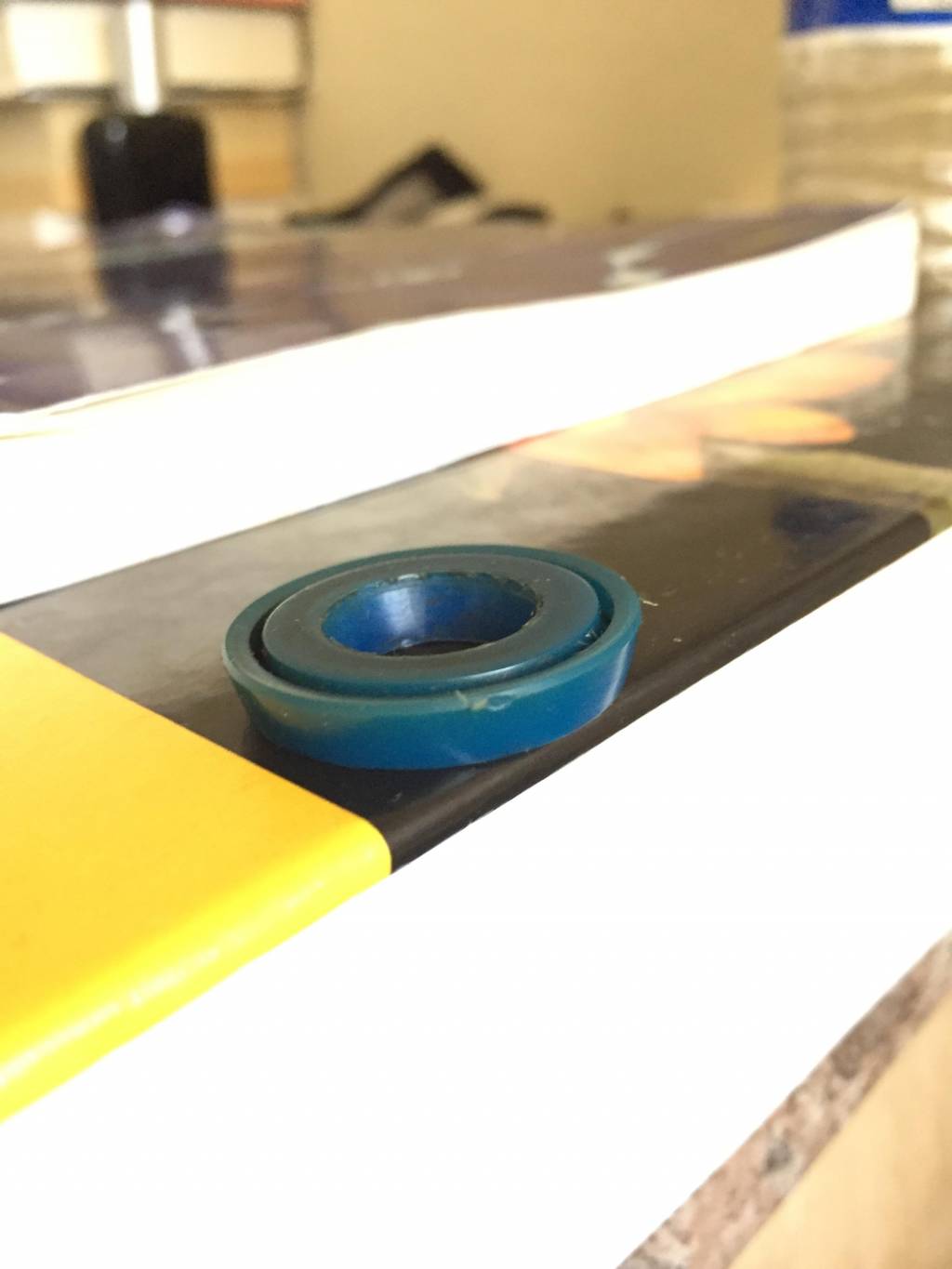

My HW95L .22 went from 625/635 FPS to average 716 FPS after replacing this seal with a Vortek one & installing an ARH kit with GPL-205, Krytox lube.

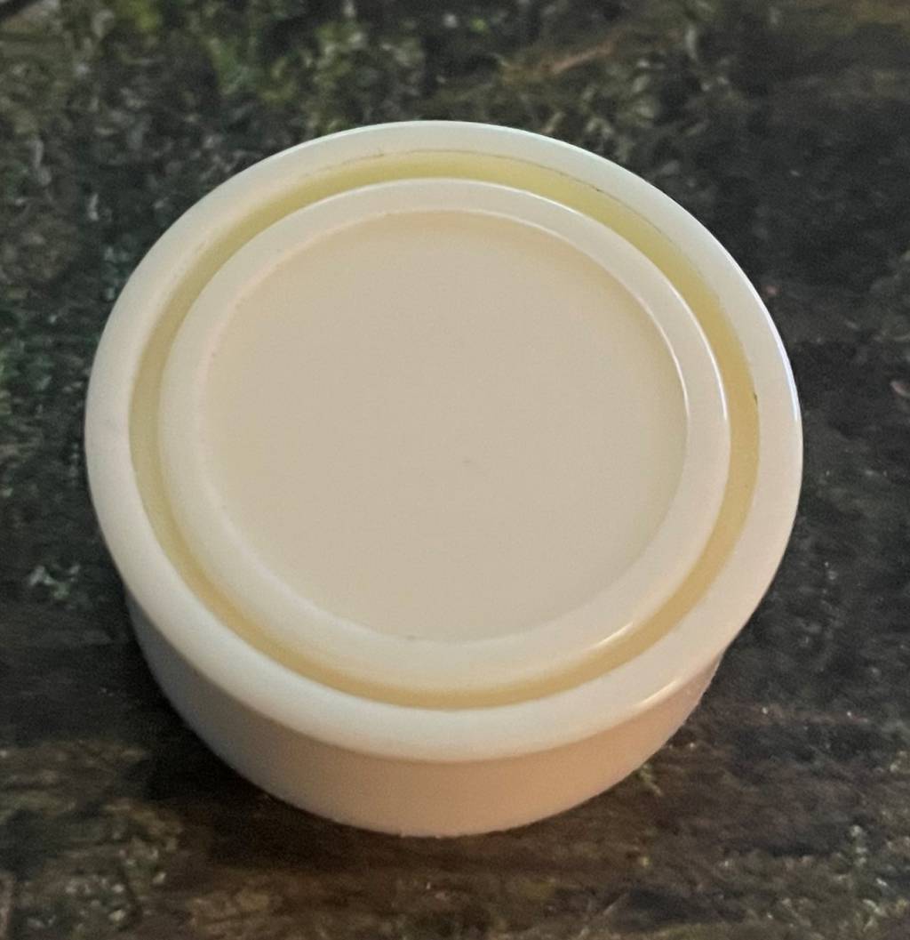

New Weihrauch factory seal.

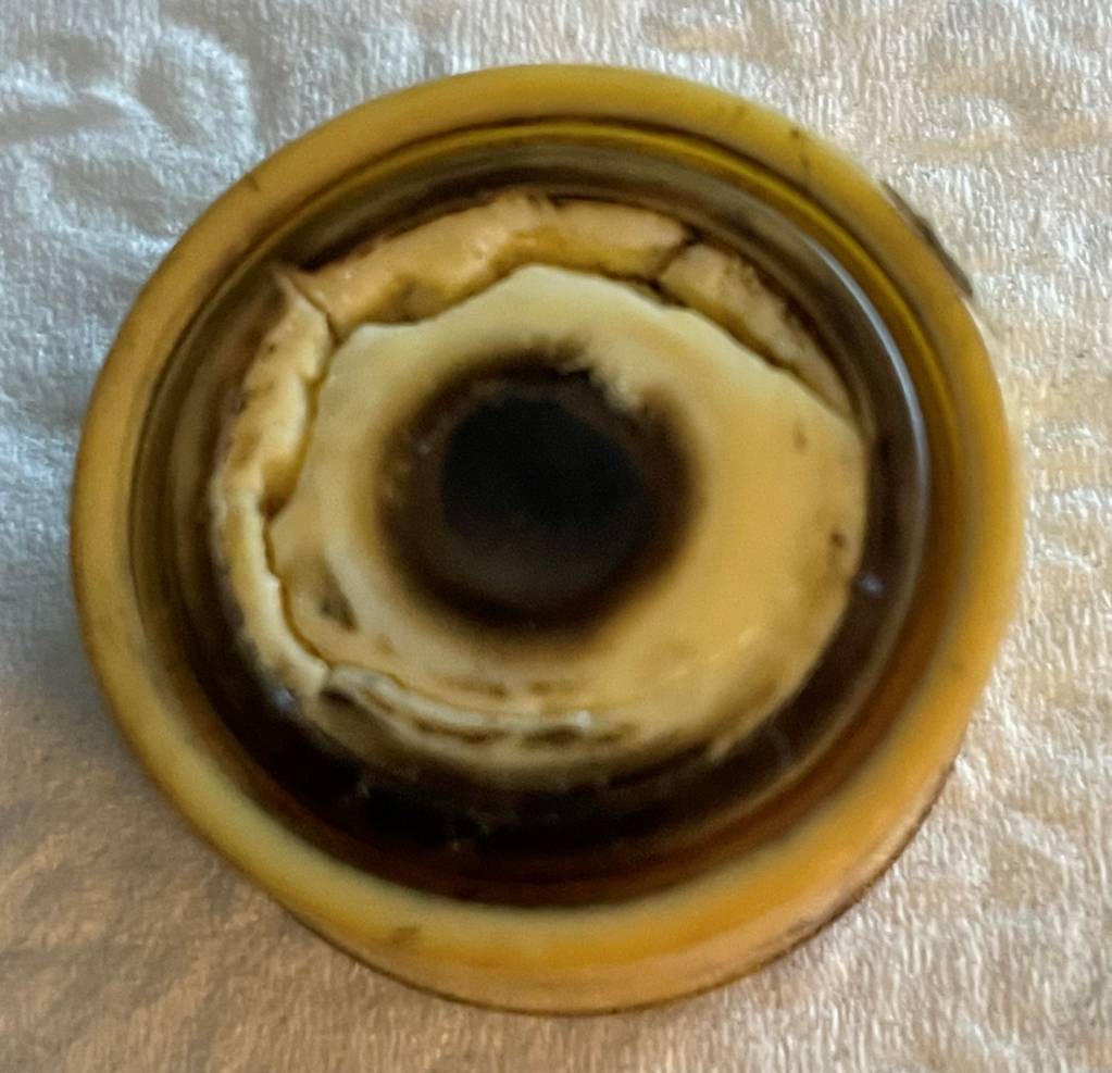

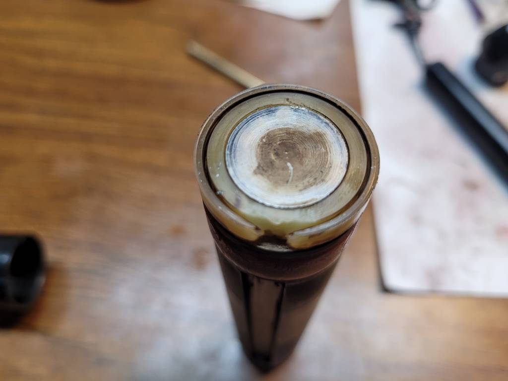

This was brought to me the other day. The customer told me the recoil was bad and his gun just wasn't shooting right. I was amazed that it even worked? This was bought new and the customer told me he never lubed it? This was a Crosman NP-2. The gas ram checked out good ordered parts and the gun is getting 760 fps plus with 14.3 gr Crosman pellets in 22 caliber.
