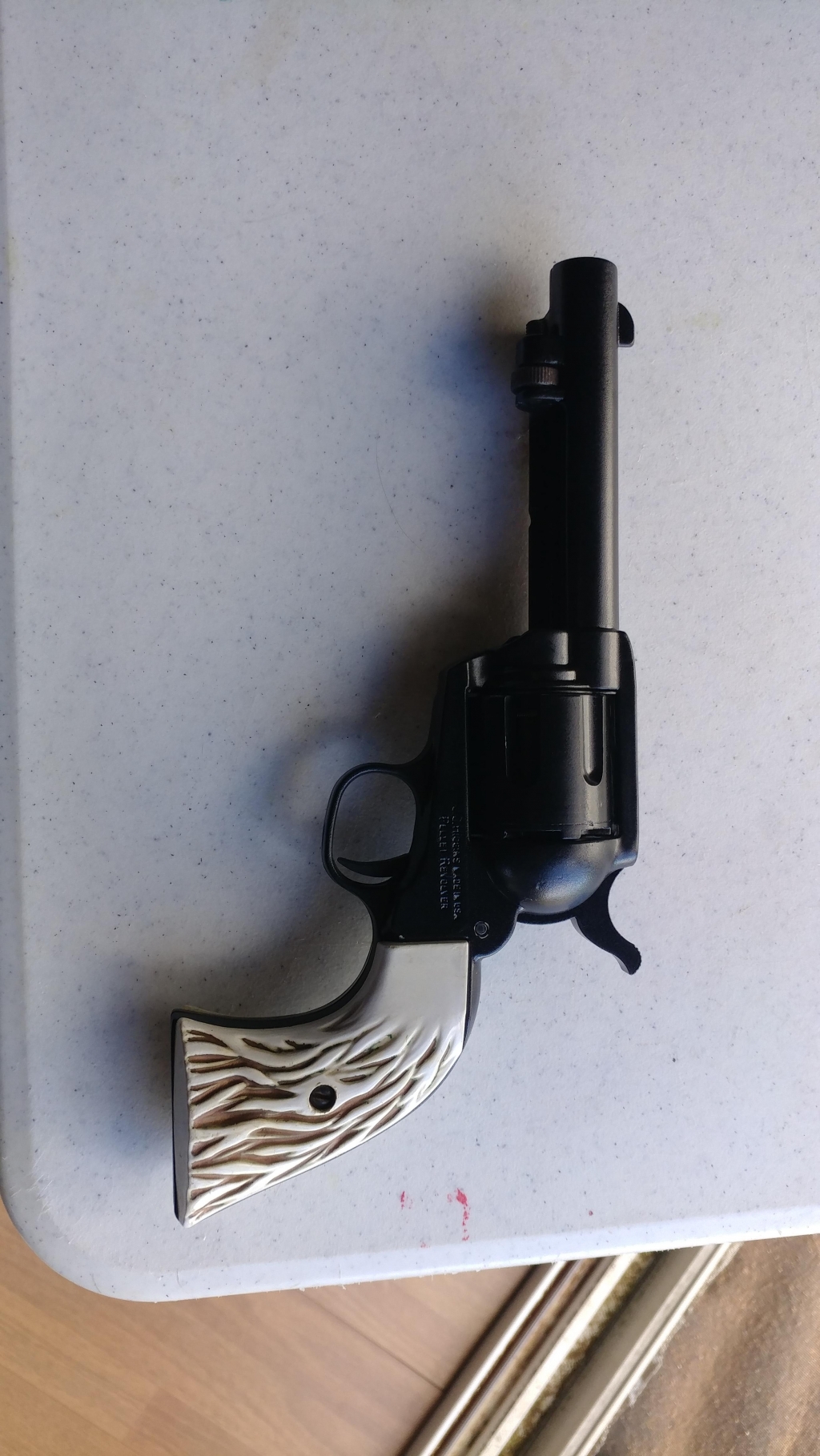

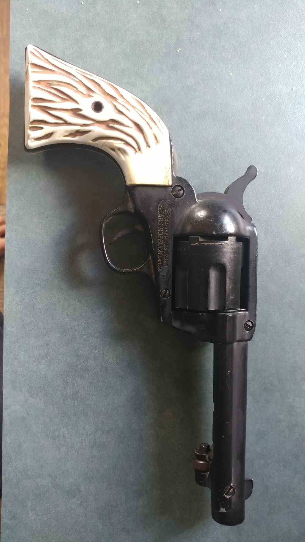

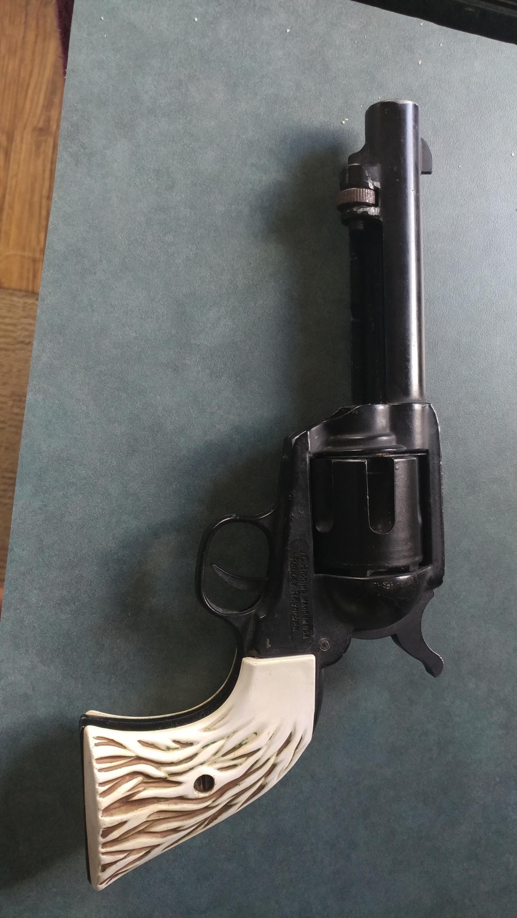

A JC Higgins .22 all metal co2 revolver. Sold by sears and made in the USA. Definitely not something you see everyday. Belongs to my dad and im positive its older than me. I had it working but its sat a while and leaks now so I'll have to fix it again but it will still shoot. How old is this thing and is there anywhere that sells parts for it or do I need to match seals from something else.

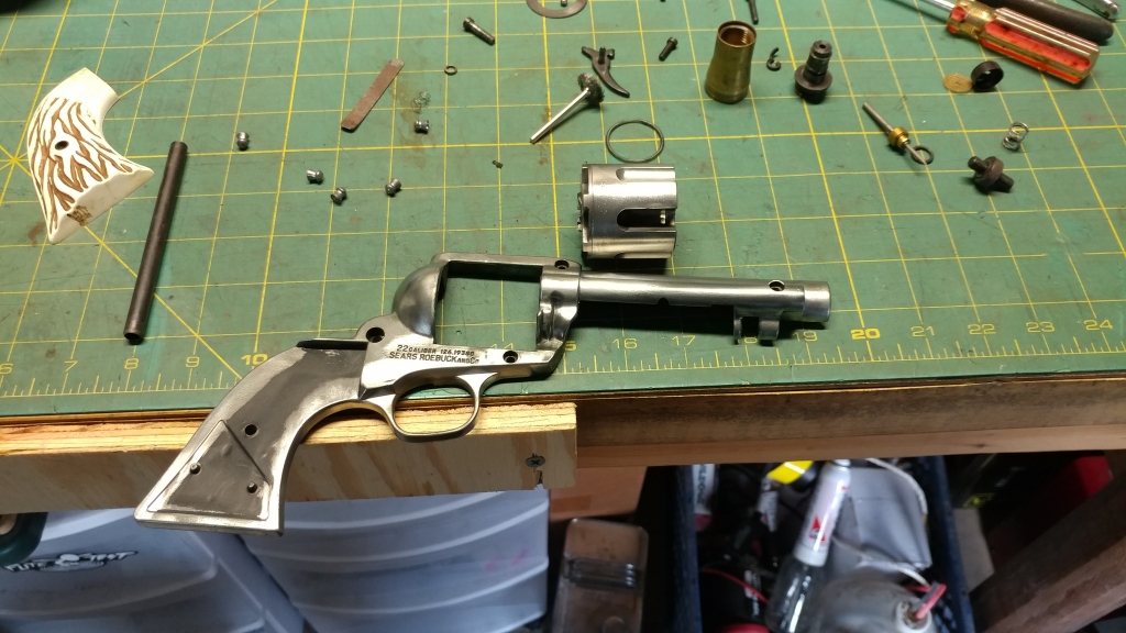

It was a simple project. The hardest part was getting the little detent ball and spring that hold the cylinder still to stay in place. I used caliper paint. Had some left from some auto projects and its pretty heavy duty stuff
the best way I found to do the detent... I noticed that the left side has a spot for the spring and ball, but the right side was more about holding it... so I set the spring and ball tilted up toward the cylinder... then use the right side to push it in & hold... I was getting the hang of it once I got plenty of practice chasing a leak... got mine all figured out, 3/4in groups at 20ft and about 270 over the chrono... I was impressed given the age...
