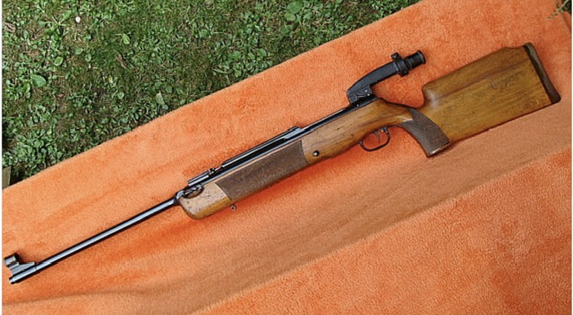

The Haenel 303 has evolved a lot since early post-war days. It never had a full-race match stock, but with a diopter sight early ones served as an entry-level target gun to some shooters. The Diana 35/b and 50/b, Anschutz 335S, BSA Airsporter Club, and others were also straight sporter actions with match sights (303 pic from "Another Airgun Blog"):

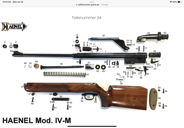

The old Haenel model IV-M I referred to is a rare beast seldom seen in the US. We may be thinking of different guns; the 1950's IV-M was a true match air rifle, about the ultimate that Haenel could conjure up in post-war East German days. Its combination of tap loading and top-lever cocking is unique as far as I know (pic from Danny Garvin's "Vintage Airguns Gallery"):

The old Haenel model IV M I referred to is a rare beast seldom seen in the US. We may be thinking of different guns; the 1950's IV M absolutely was a match air rifle, about the ultimate that Haenel could conjure up in post-war East German days. Its combination of tap loading and top-lever cocking is unique as far as I know (pic from Danny Garvin's "Vintage Airguns Gallery"):

The model IV-M has to be one of the wackiest designs ever. They are quite rare and bring eye-watering money when they pop up on German auction sites. I have wondered if the later 311 was a sort of simplified evolution of it, and possibly shared some parts.

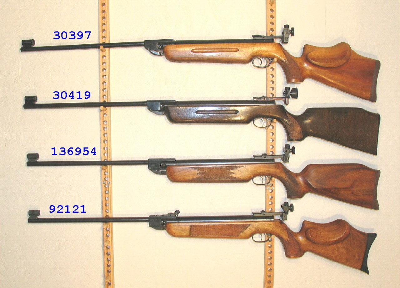

Top rifle in this pic may take the cake as the rarest sub-variant of a well-known model I've ever seen - the late Frank Korn's HW 55 TF DST: early finger-groove Tyro stock; no locking breech latch lever; double-set triggers! The serial dates from about 1955.
The others are also rare no-lever "F" variants, covering all three of classic HW 55 stock variants of the day - top to bottom an SF, MF, and another TF.
Top rifle in this pic may take the cake as the rarest sub-variant of a well-known model I've ever seen: the late Frank Korn's HW 55 TF with early finger-groove Tyro stock, no breech latch, and double-set triggers! The serial dates from about 1955.
The other three are also rare "F" variants.
That double set TF is simply amazing!

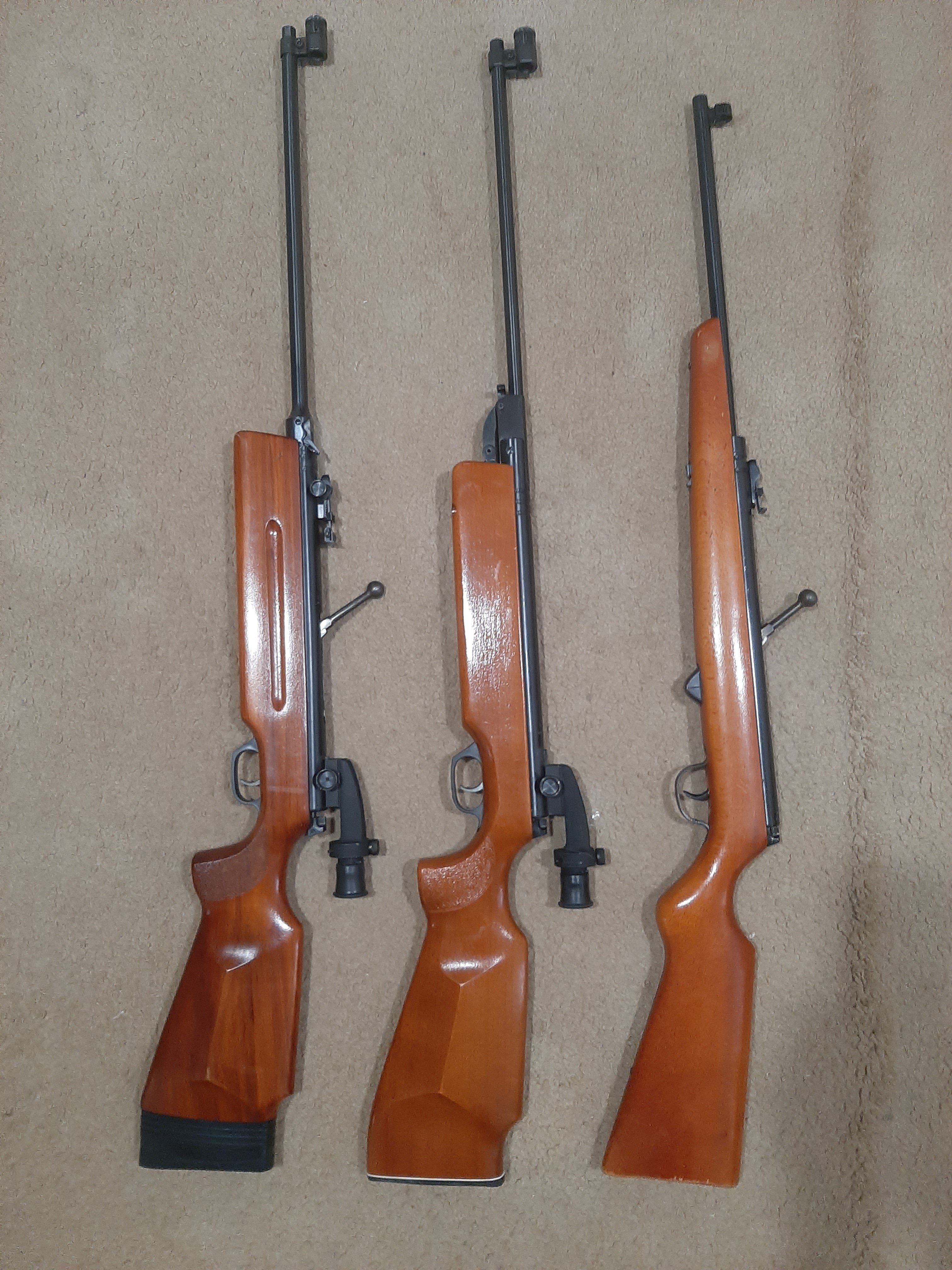

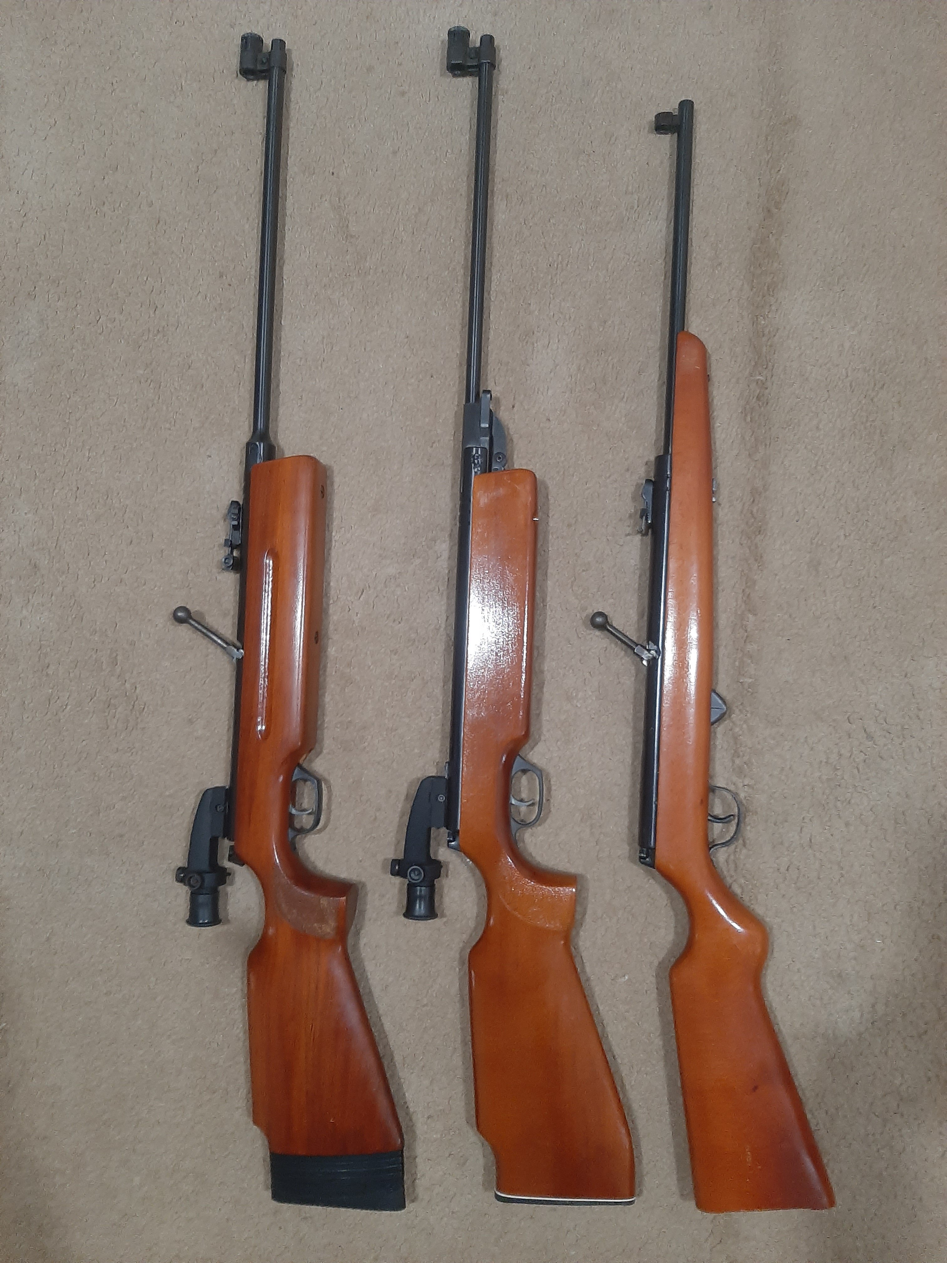

Lovely wood on the 311, and interesting how it and the 303 S share a lot of details, including a very similar shape to the butt.
Oh, this is a separate topic for condemnation, when I finish with this collection, which is dedicated to shooting sports in the Warsaw Pact countries, I will open a separate topic. In this photo, one of the rarest Haenel, 311-4 was produced only for one year, the last year of the company's existence and was supplied from the factory with two sights, diopter and micrometer, as well as with an adjustable match butt, in the older 311-2 this was not. Probably, Haenel 303S was also released during this period, so they have a lot in common. Both rifles have diopter sights of the old model, the new sights 311-4 have a lower base, but otherwise are identical.
Yeah, the 311-4 I had included all that stuff...kicking myself yet again! Geez I should have kept it for the cool double sight set alone.

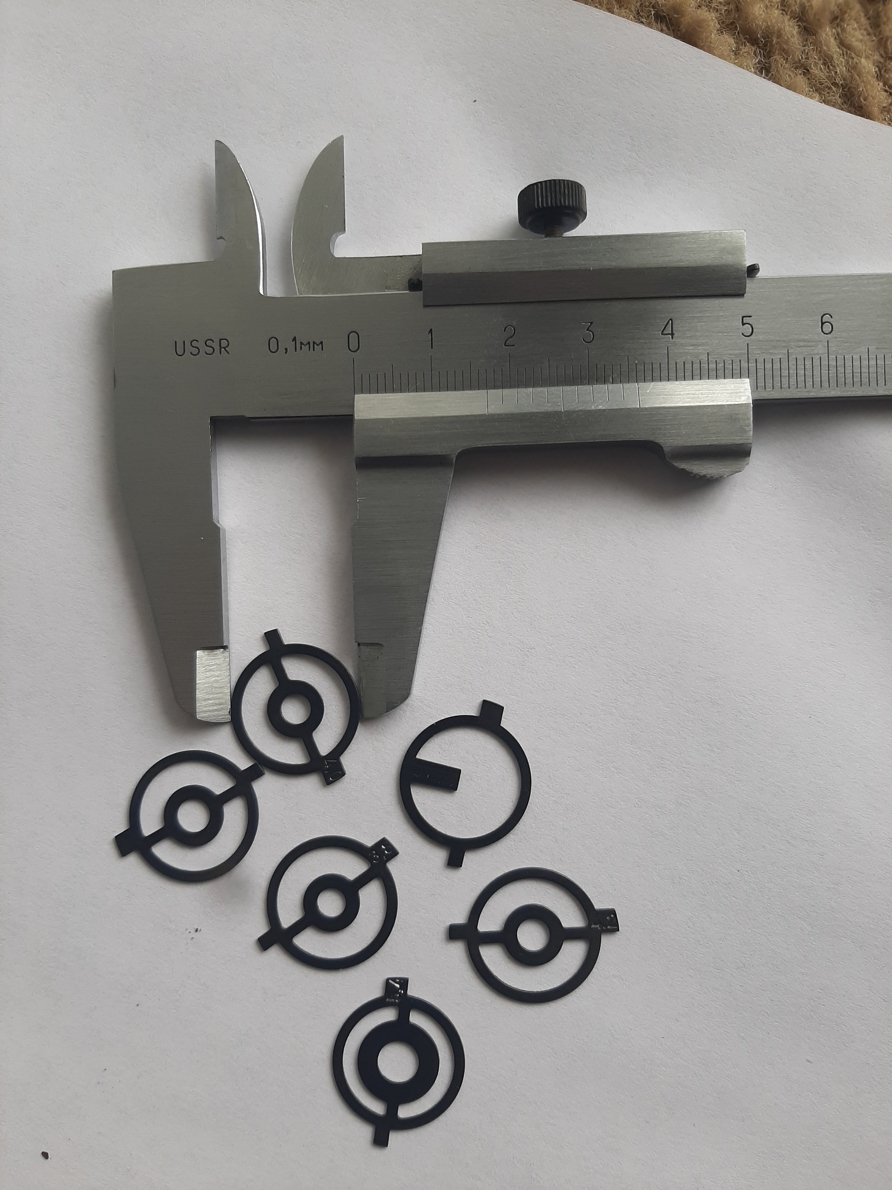

I remember that gun used Anschutz front sight inserts, which was interesting. The 311-2 I had years ago used much different, smaller inserts.
The inserts in the front sight are identical to the inserts in the Walther LG200/300.
