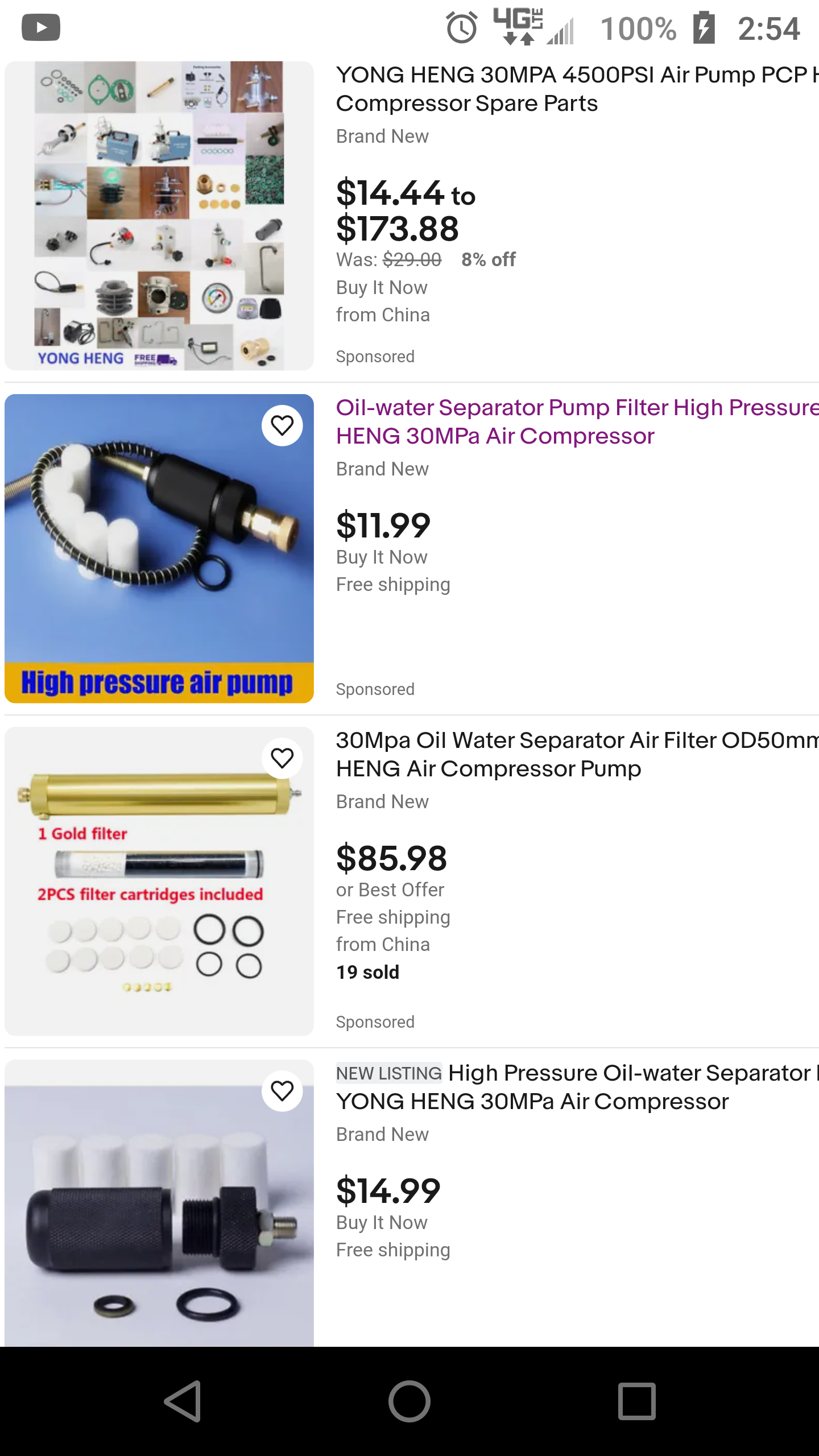

Too big for hand pump. Price point scares me. Keep in mind when pressurized its bomb. If the wall thickness or material grade is too weak. Get Tuxing or some other brand that people have experience with. Filter size should be proportional to what you are filling. For guns a small one should work. Ec3000 is pretty good at separating water for filling guns already, unless you are in a very humid area.

Hand pumping, I would just put two of the small cotton filter housings inline of each other. To keep it fresh and dry, remove the white cotton inserts out to dry at the end on the day, leaving the housings and lines open to the atmosphere too. The lines collect water droplets that will evaporate this way. The filter closest to the pump will be the one catching most of the moisture, and the second one is just for preventative measures. Then just put the dried filters back in their housings before pumping in next day's shooting session.
These black Yong Heng filters are about as small and heavy duty as you could get. Plus they come with everything that need to filter, hook up, and seal.

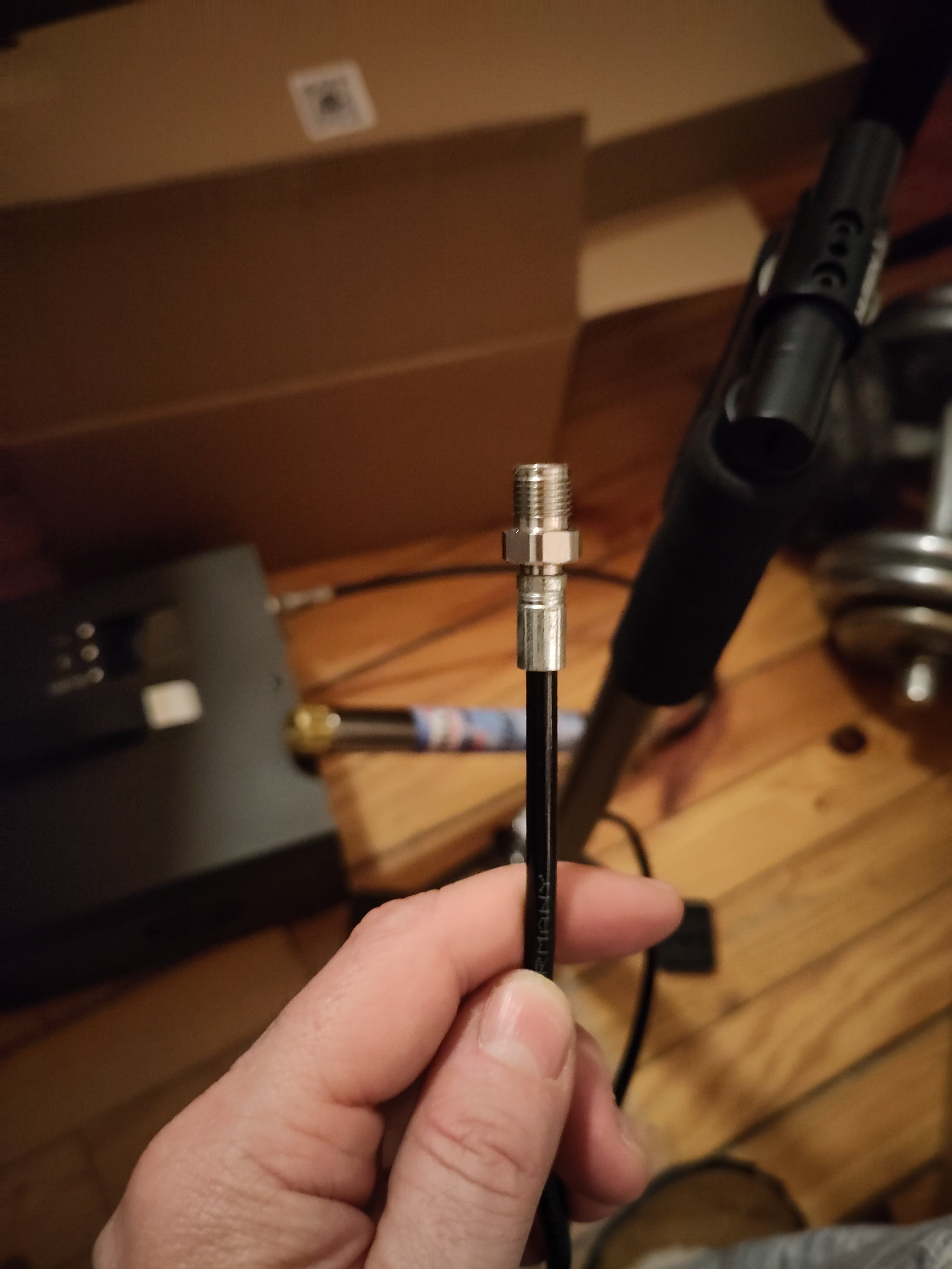

I have this pump, but I am having difficulties with attaching any kind of filter to it. I am relatively new and this crazy variety of working pressures, hoses, adapters, threads, sizes and seals makes me crazy! It seems like nothing is made to work with anything else!
The pump has this filling whip hose with the end you can see on the picture. It only has the Huben probe that you can screw on. I found a video where Gregor is talking about adding a quick disconnect so to make it compatible with more air guns, but there are no details (of course) to what he uses:
