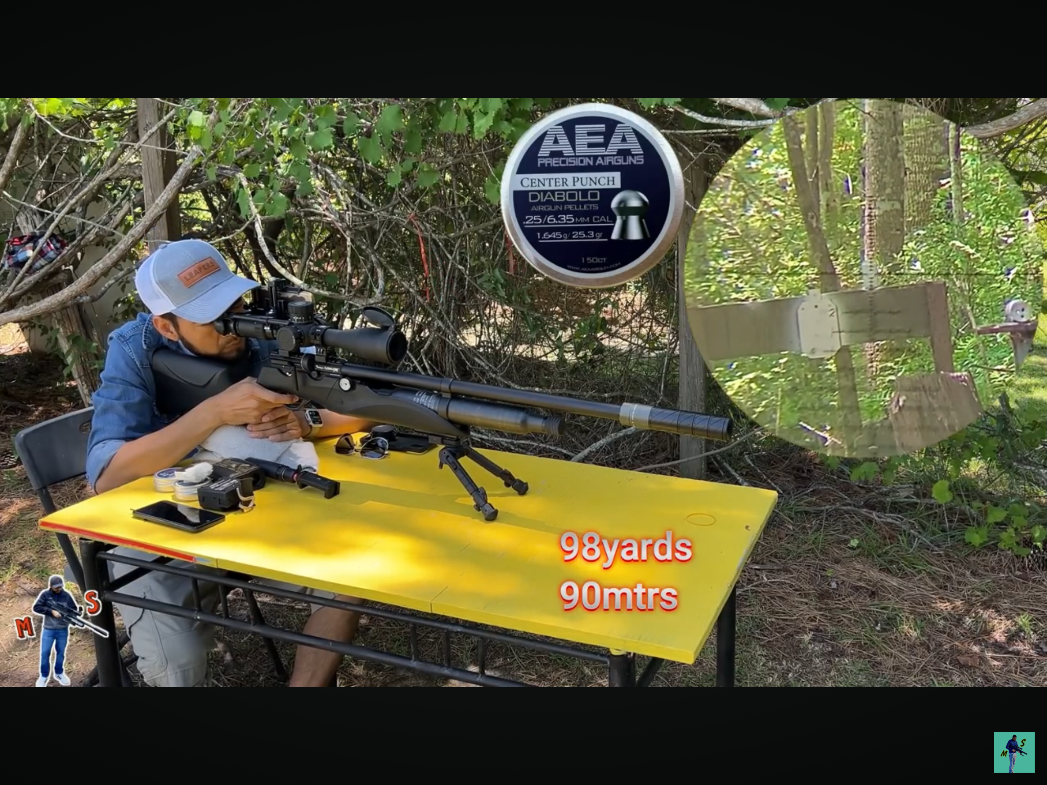

I strongly believe this is the ultimate goal of every airguner who is involved in this hobby, no matter how affordable or expensive could be the airgun we are using to try to achieve this. Well after doing some research I found this very interesting youtube video of this spanish speaking famous airguns reviewer with a Avenge-X classic synthetic stock achieving this with a .25 cal shooting the AEA center punch pellets 35 grains. I took some screenshots from the video along with the tune he was using to achieve this, to shared here for the benefits of all the airgunner who might be interested and don’t have a chronograph.
He was using the following tune, the reg was set @ 175 bar with the hammer spring 3 full turns in (clock wise) from all the way out with the 25 grains and 6 1/2 turns in with the same but heavier AEA 35 grains pellets. He was using a Discovery scope 4/20x50 wirh a DonnyFL Yokozuna moderator and a UGT bipod.
