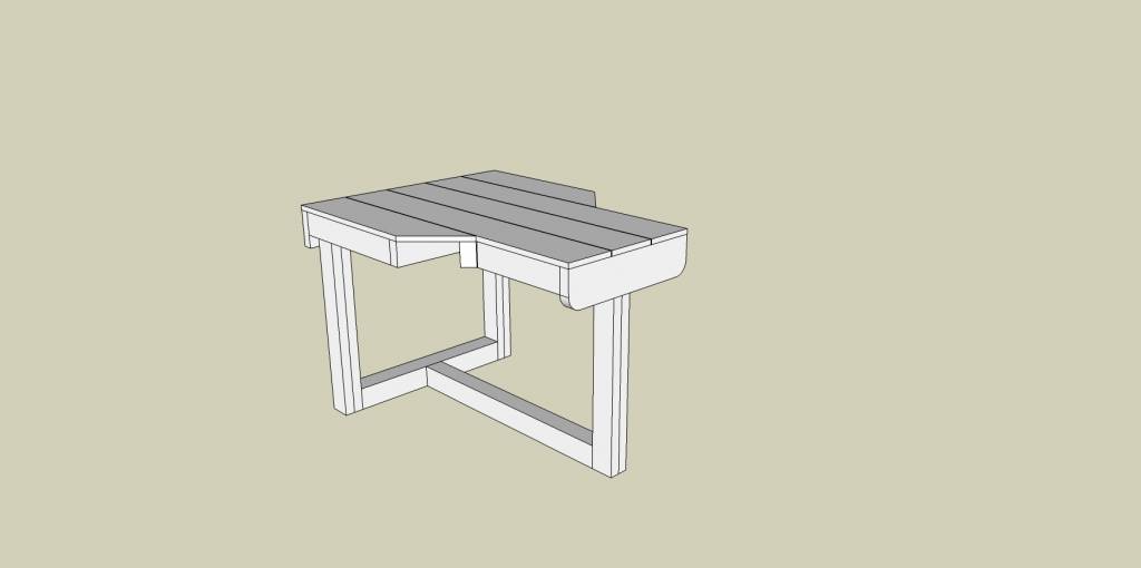

To start us off, here is the basic CAD of the bench:

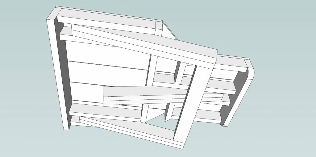

Here is the under side
Here is how the legs fold down

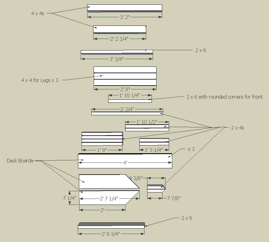

Here is the visual Bill Of Materials, and I am attaching the BOM in Excel
Bench_Assembly_Gen1_VisualBillOfMaterials_Dimensioned_ZoomedIn_22-05-13.1654313146.jpg
View attachment BenchAssembly_Gen1_BillOfMaterials_22-05-12.1654313152.xlsx

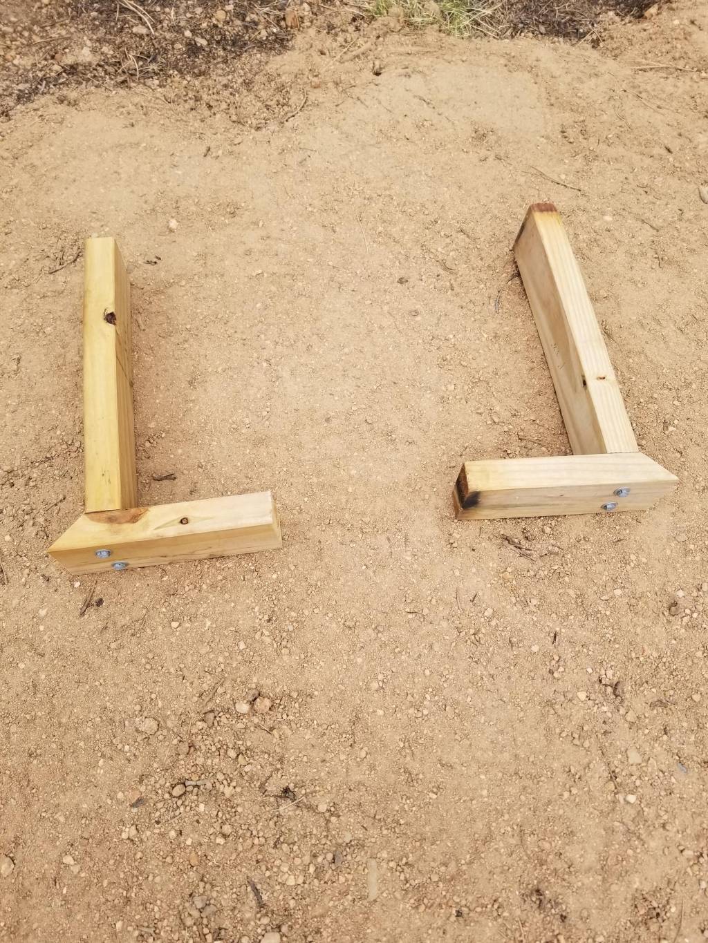

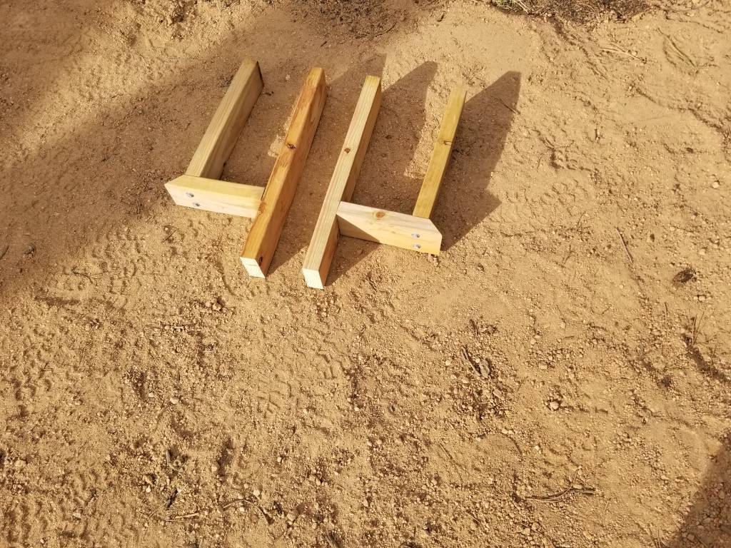

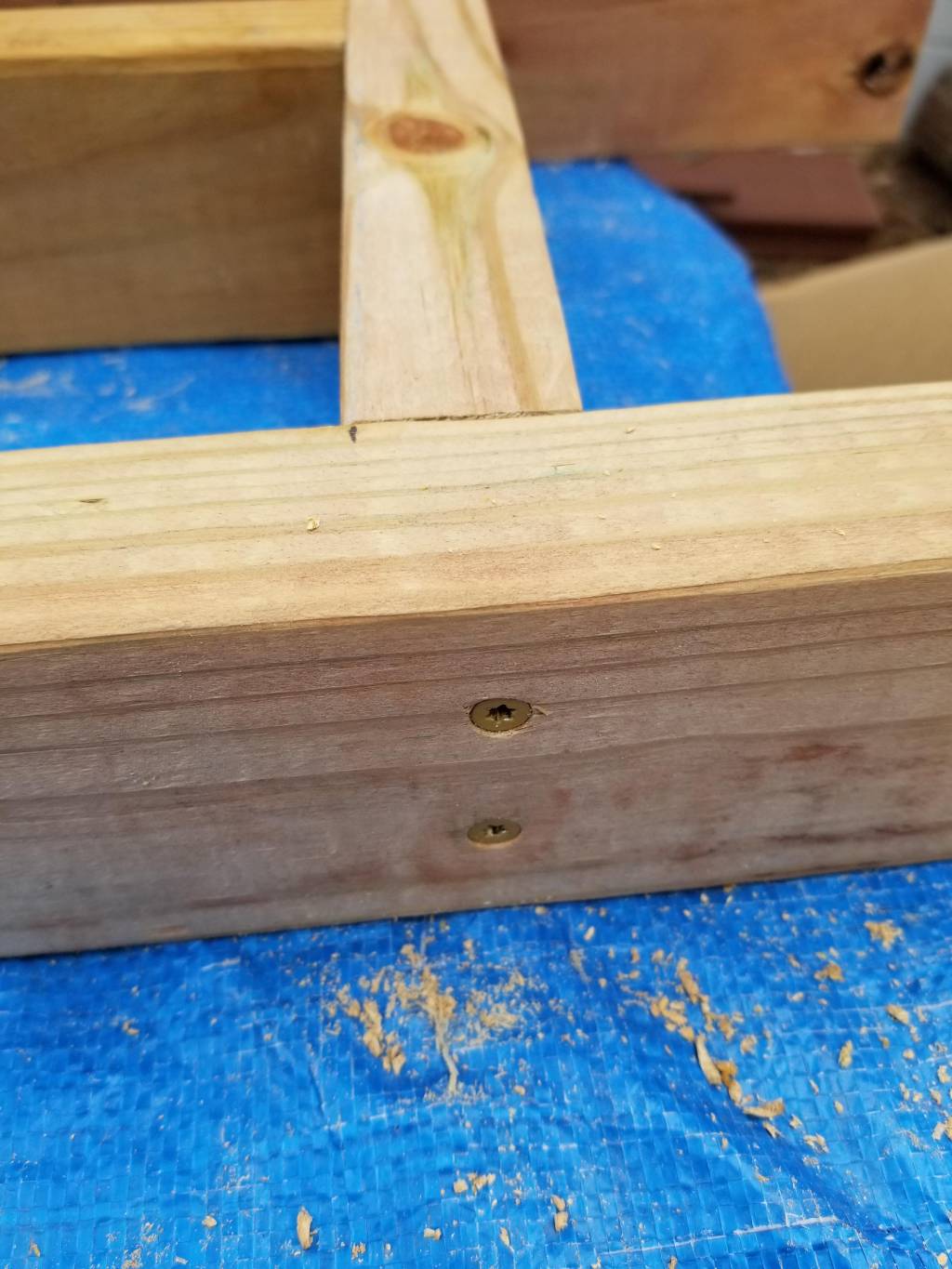

The first assembly step to attach the 9 3/8" angled pieces to the 1' 3.25" pieces as shown:
You are using 3" deck screws for the connection to the 1' 10.5" boards because the heads need to be flush with the wood. The majority of the rest of the connections are 6" lag bolts:
Here is where you are at now:

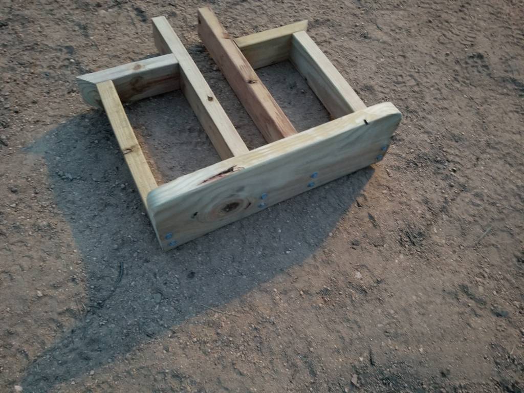

Now mount the shooter's end 2x6 with the rounded corners:

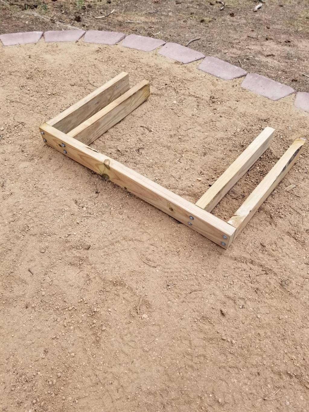

Now mount the four 1' 9" boards to the 3' 3/4" 2x4 as shown:

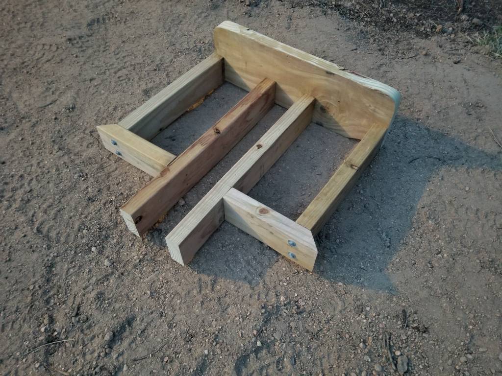

Mount the two assemblies together as shown:
Now put the target end 2x6 on there:

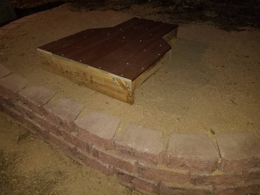

Now, put the decking on top:

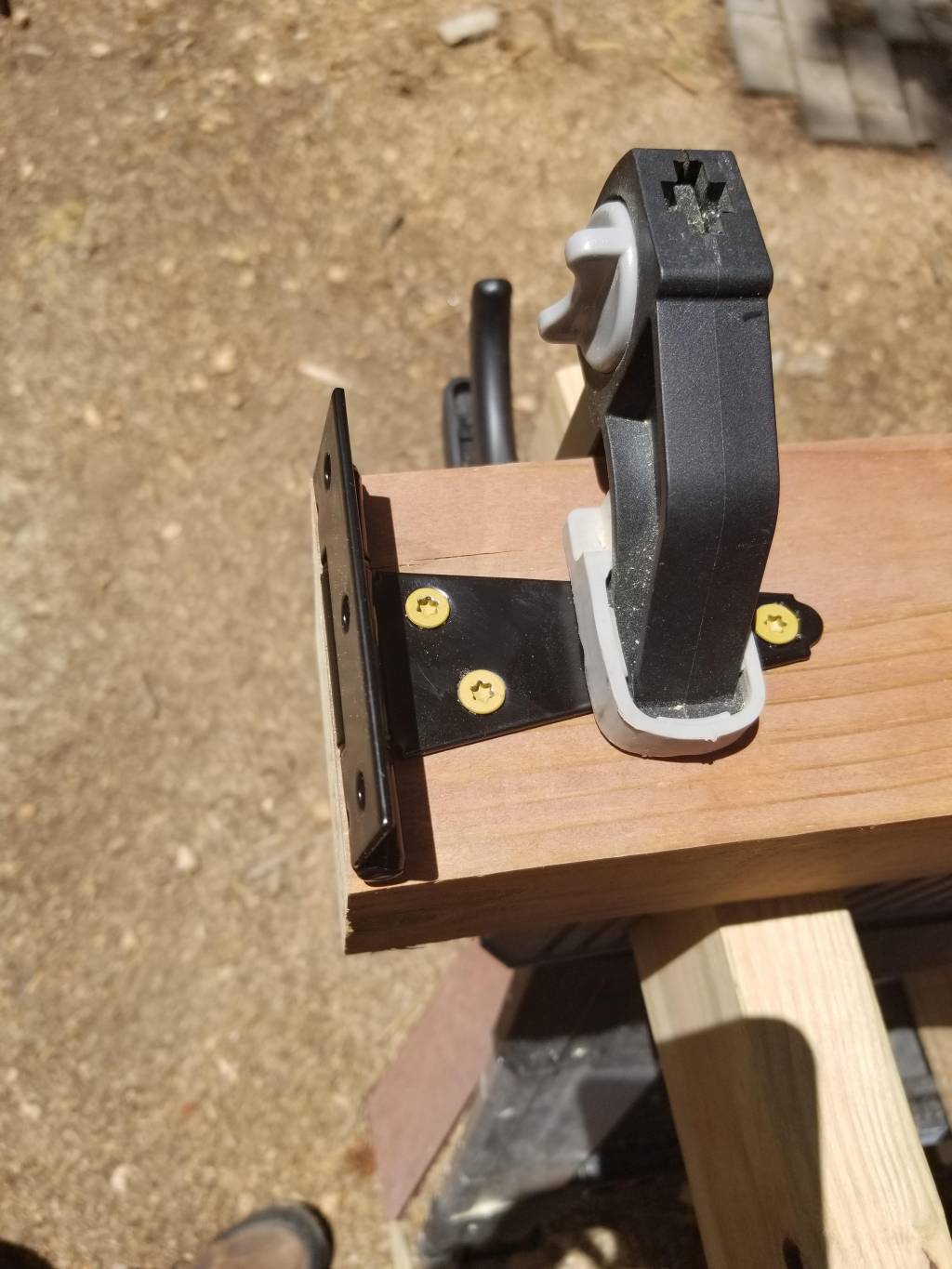

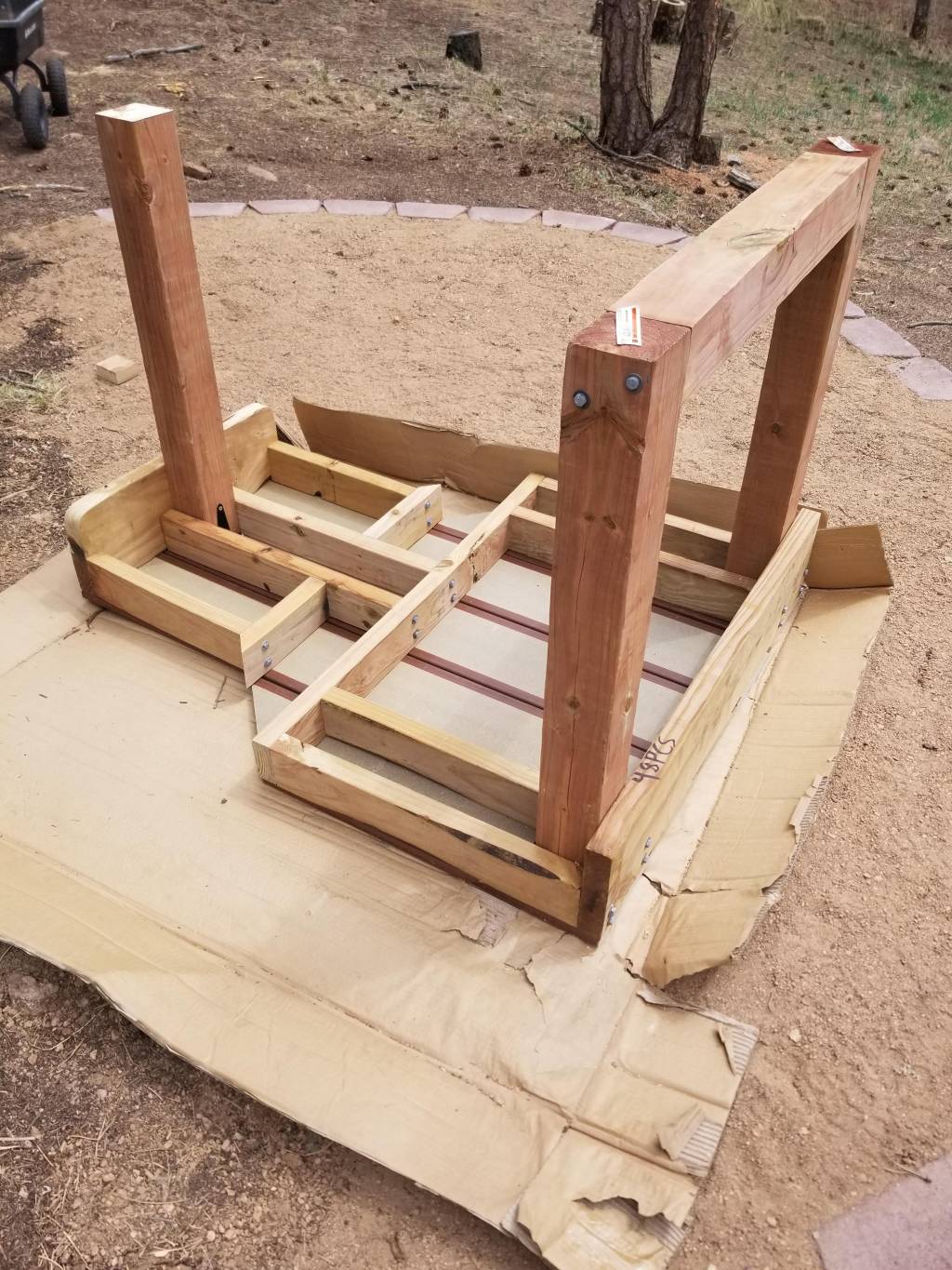

Mount the leg hinges to the legs and make sure that they are really square:

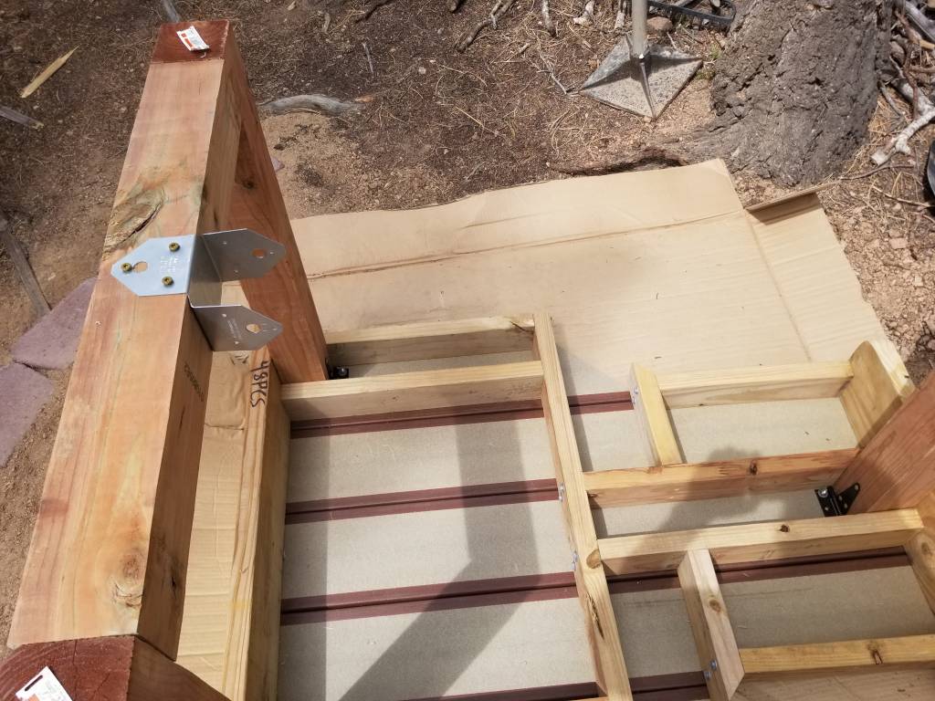

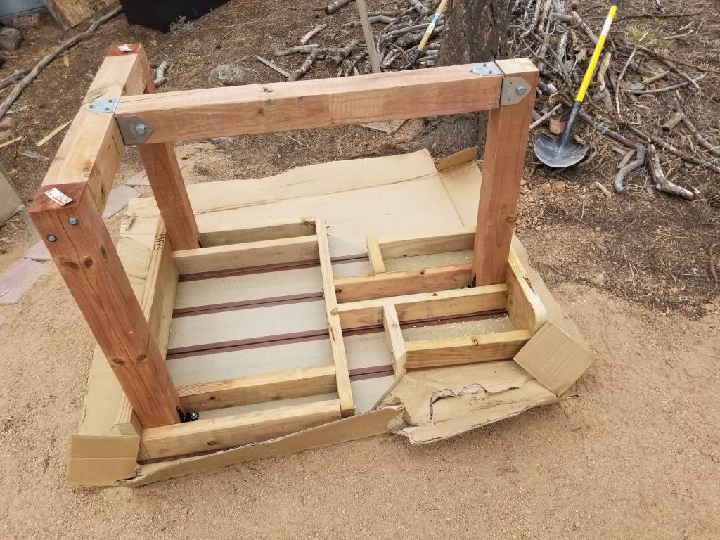

Use carriage bolts to mount the legs to the deck boards. Also, you can add in the cross support in the front:
Add the cross-beam support brackets:
Add the support:

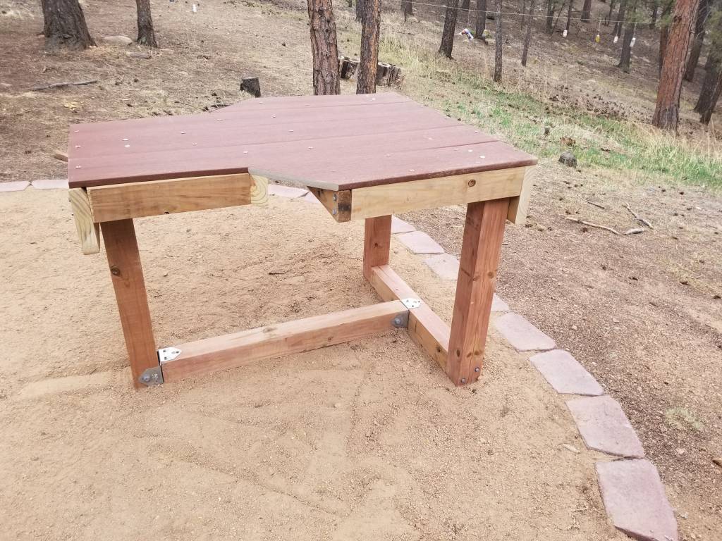

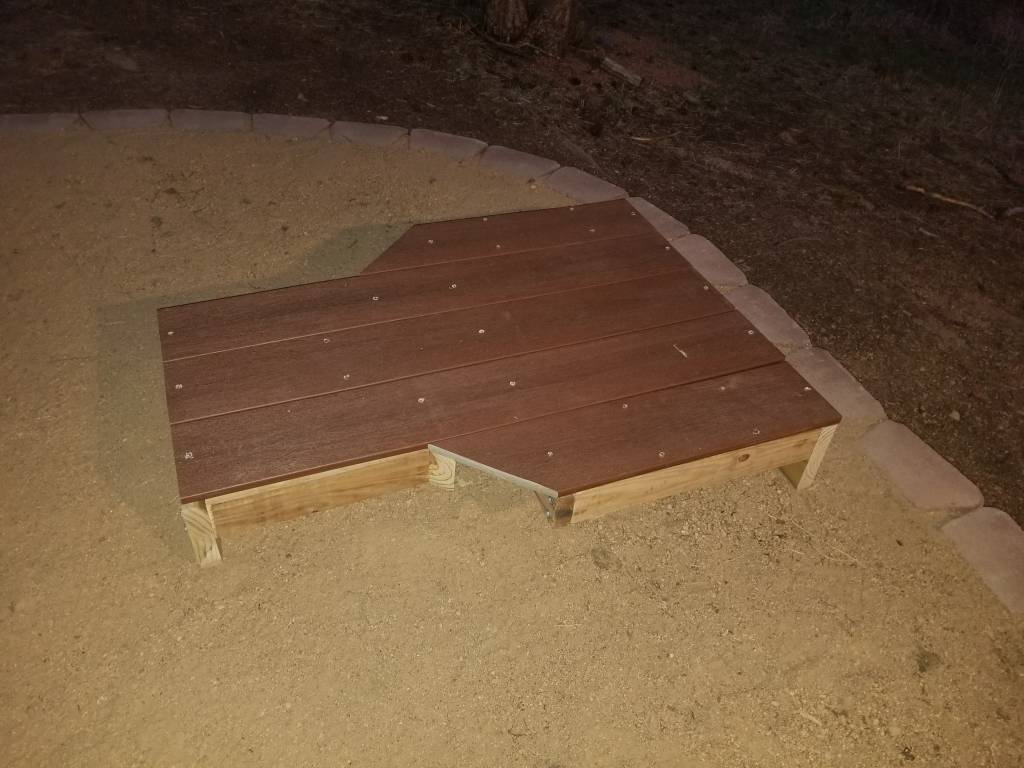

Flip it over and here is the basic bench:

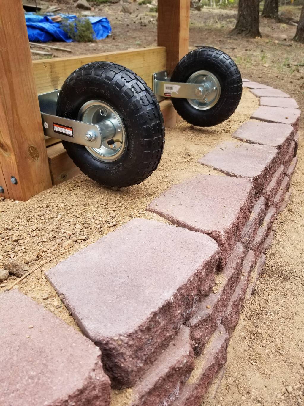

Add the front cross support, and install the wheels

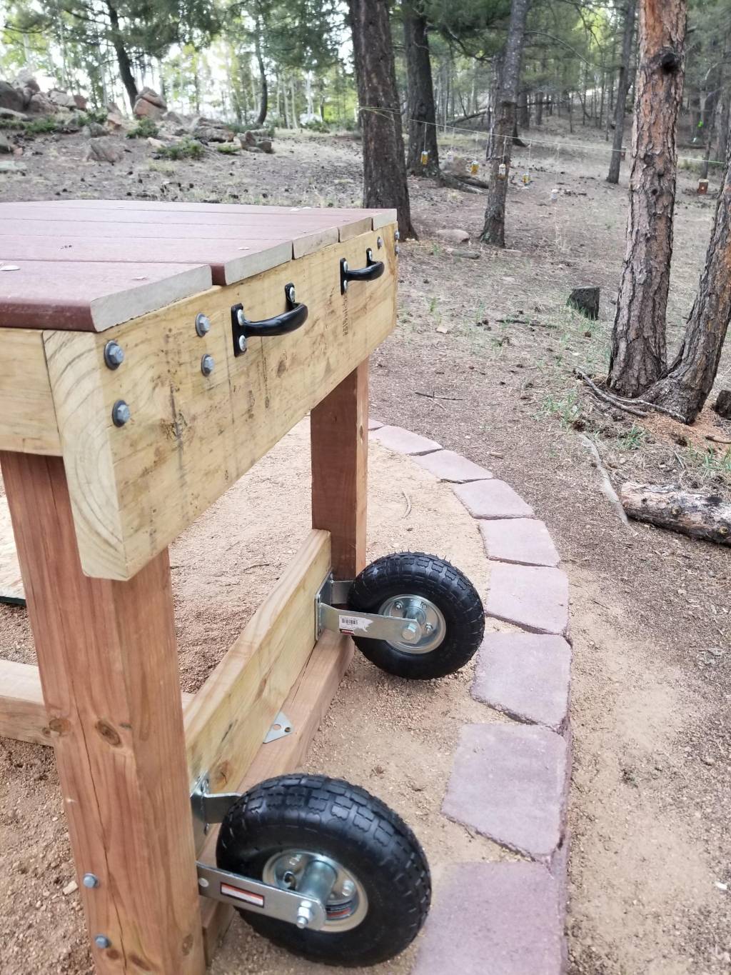

Now install the handles so that you can drag this beast around:
I will post pictures of the actual bench folded up and being moved around whenever the necessity arises that I need to move it, but it folds up just fine.

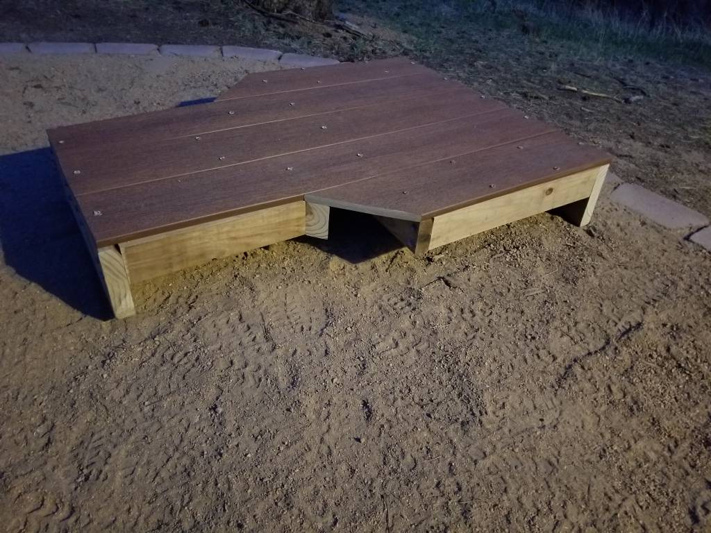

Nice table, nice work.
The only thing I might alter is raise the 4x4’s that connect all three legs together in the likely event the ground isn’t as flat as a pool table, otherwise you might be shoving wedges or something under a leg to stop rocking. Might only need to be raised two or three inches.
Randy
I meant to follow up on your comment as it was very pertinent. I agree that this bench is designed for a "softer" medium to sit on. I have mine sitting on crushed granite (sand), and I intend on using it on dirt as well. If I were to put this on concrete, the screws underneath the support would be really annoying, I'm sure, and would require shims as you mentioned.
If I was to use this regularly on a truly flat surface, I would have to reconsider the design...or shim the heck out of it. I had to build a retaining wall to give me some flat ground to put it on, but the sandy medium I have it sitting on makes this design work really well where it sits. That said, it is "pretty easily" portable, which adds more flexibility than you would get from a cinder block bench sitting solidly on concrete.
Anyway, I agree with your observation of the short-coming of this design being dependent on a forgiving medium to sit on. Raising the center support would make it more forgiving, for sure. You could do the same for the front cross-support and make it sit on three legs as JimD is doing. It's all up to the application, I guess.

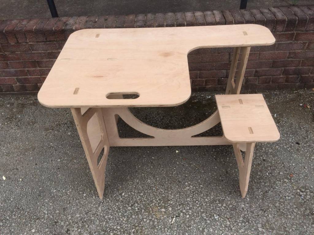

Another design that I was seriously considering was the "One sheet of plywood shooting bench", which is a really cool design. Here is a picture of the finished product:
I liked this design because it breaks down and ends up being pretty light, and probably a good bit lighter than your Caldwell when just considering the main piece. For anyone interested, here are the plans that I found online:

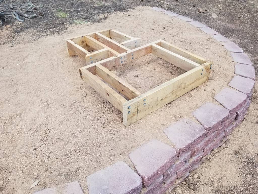

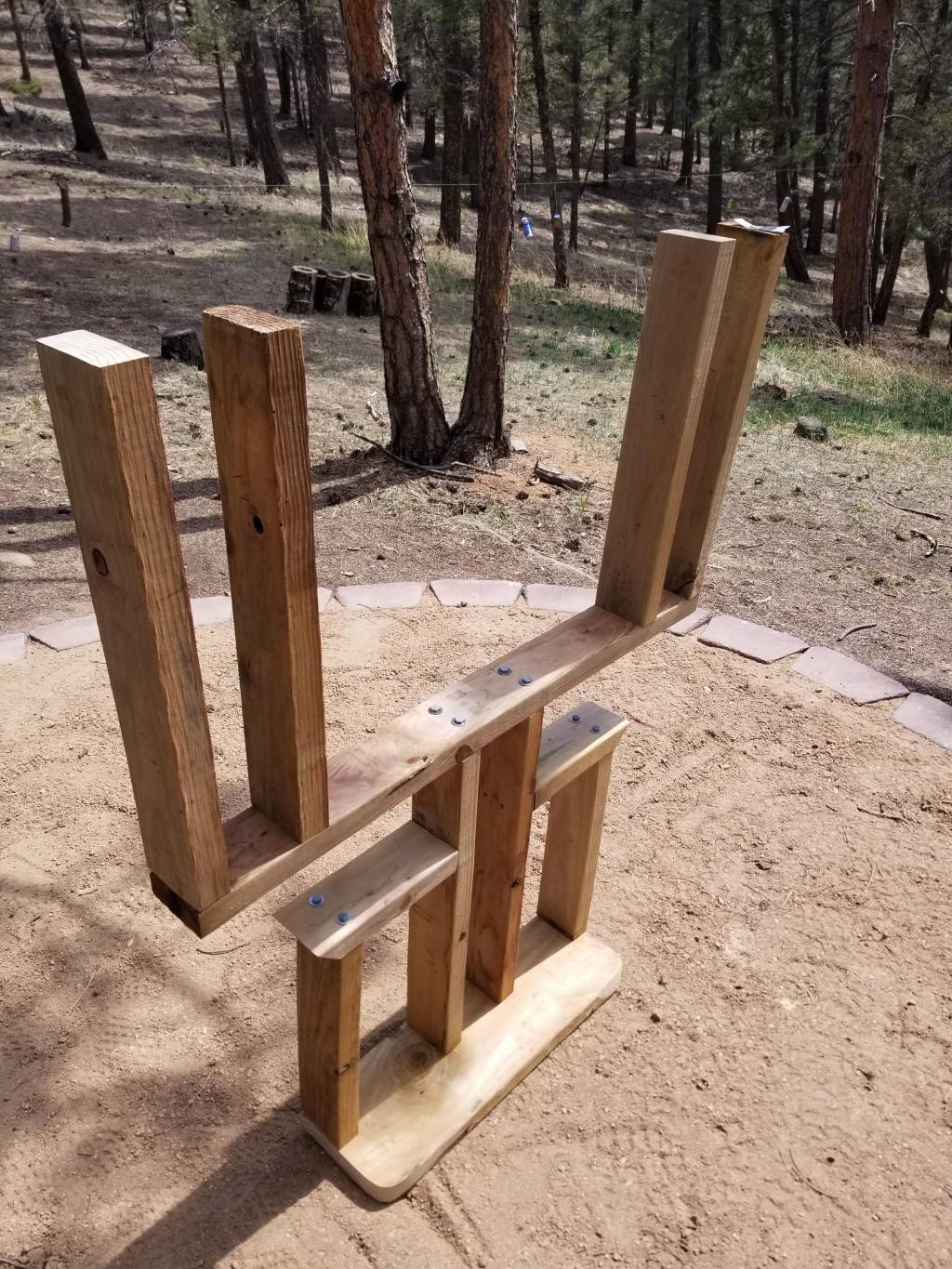

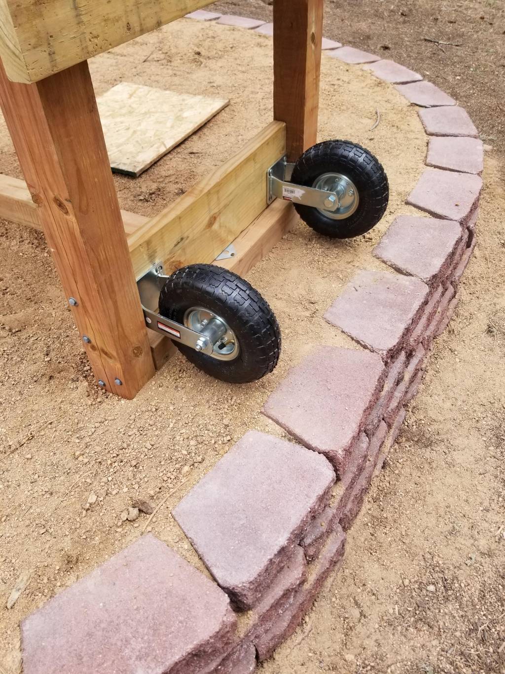

View attachment 215986View attachment 215999

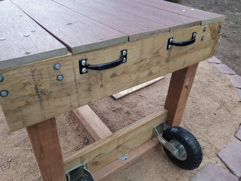

View attachment 216009View attachment 216023

I like the OP's table and was thinking of copying to some degree until I saw this idea. I can have this laser cut at work but how stable is it without it being glued or screwed? I think I would glue it and seal it real good so it could live outdoors. Maybe marine grade plywood.
