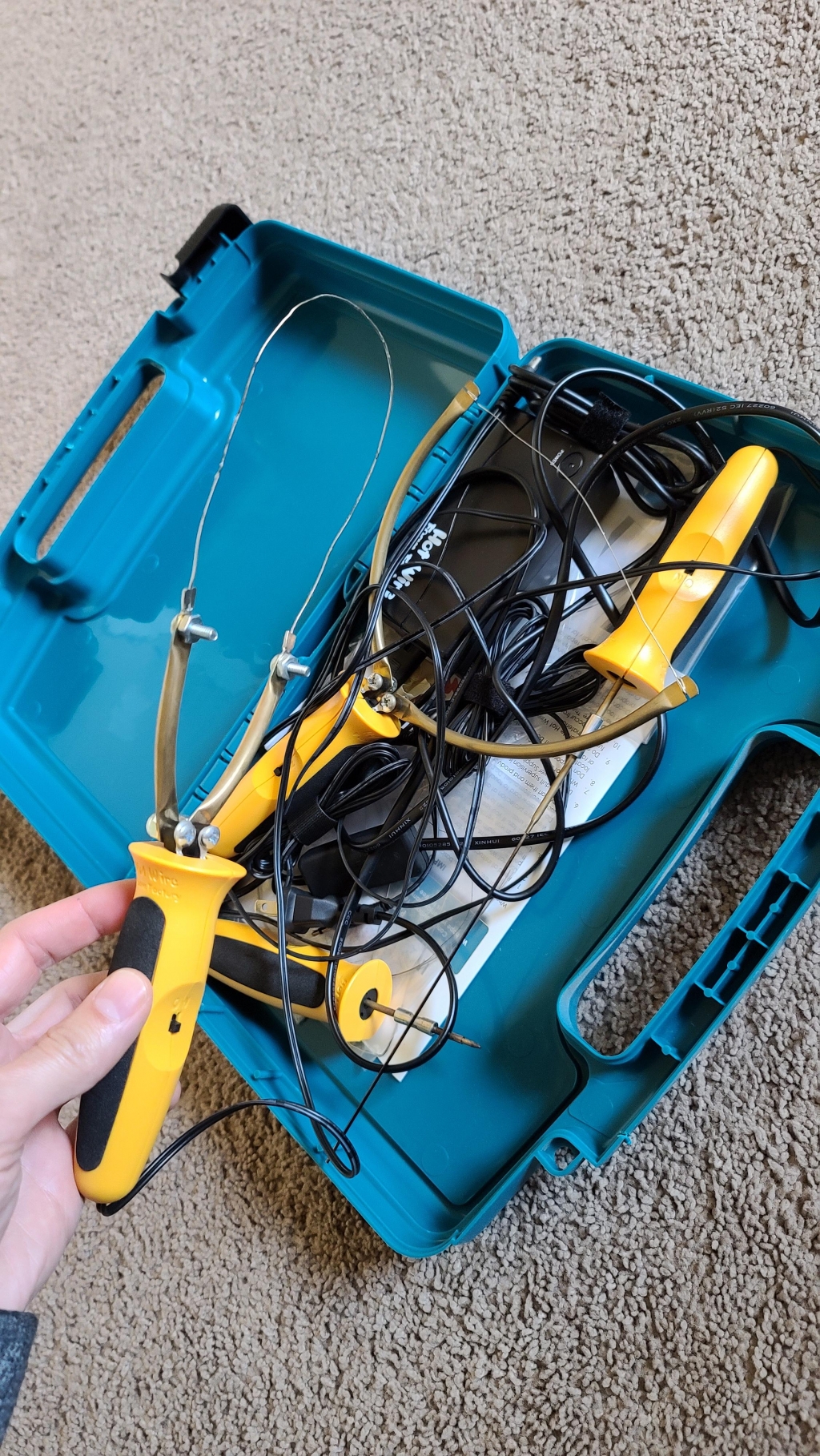

What you're asking will be a challenge. Though I may have a solution for you. I use this to cut and craft styrofoam. I'm sure it'll work for foam as well, just make sure you're in a well ventilated area. Not sure how much these kits cost in comparison to new gun case.

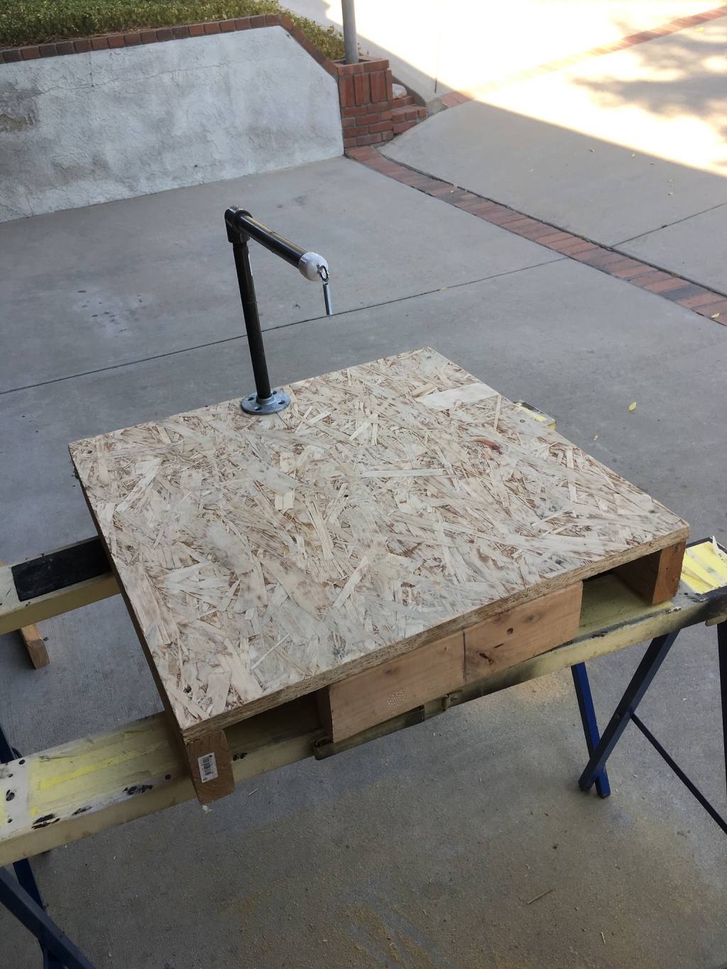

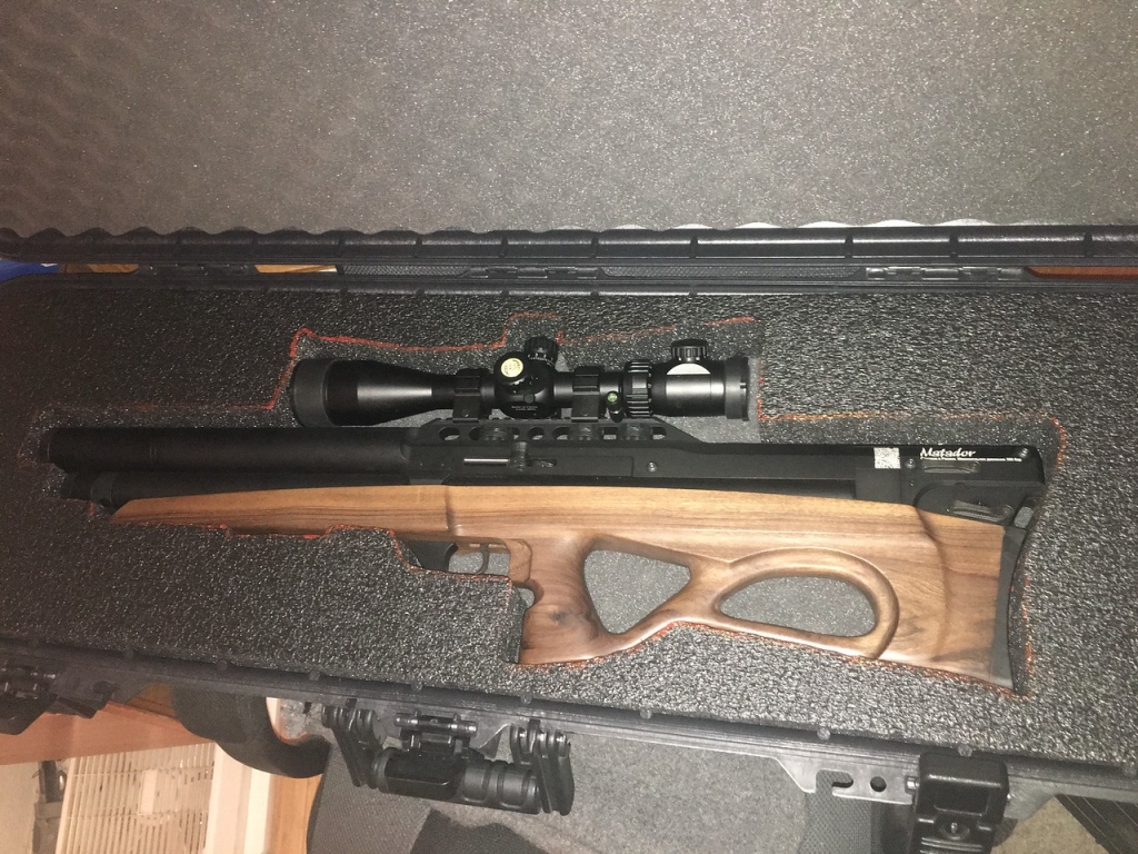

I made a hot wire foam cutter. I bought a 2.5amp USB charger as power source and a hacked up USB cable to apply the power to the wire. I used Nichrome wire as the "blade." A nice thing to add is some kind of foot switch to cut the power to the wire when making turns. I'm sure you could do it without a switch, but I found that the table had to be bigger to keep from hanging the foam up on the table edges. If the cutting gets stalled and the power is still on, you'll screw up the cut.

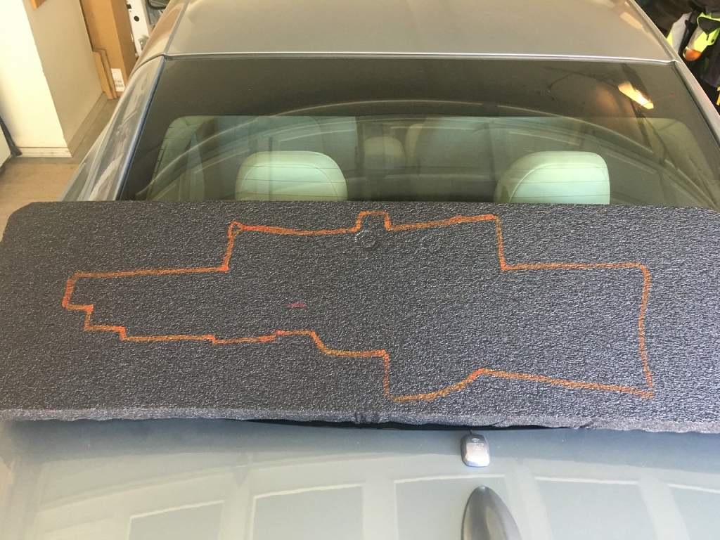

I bought a 2" thick polyurethane foam sheet and cut it to fit my case. I outlined the Matador using a dry erase marker. The lines will wash off with water.

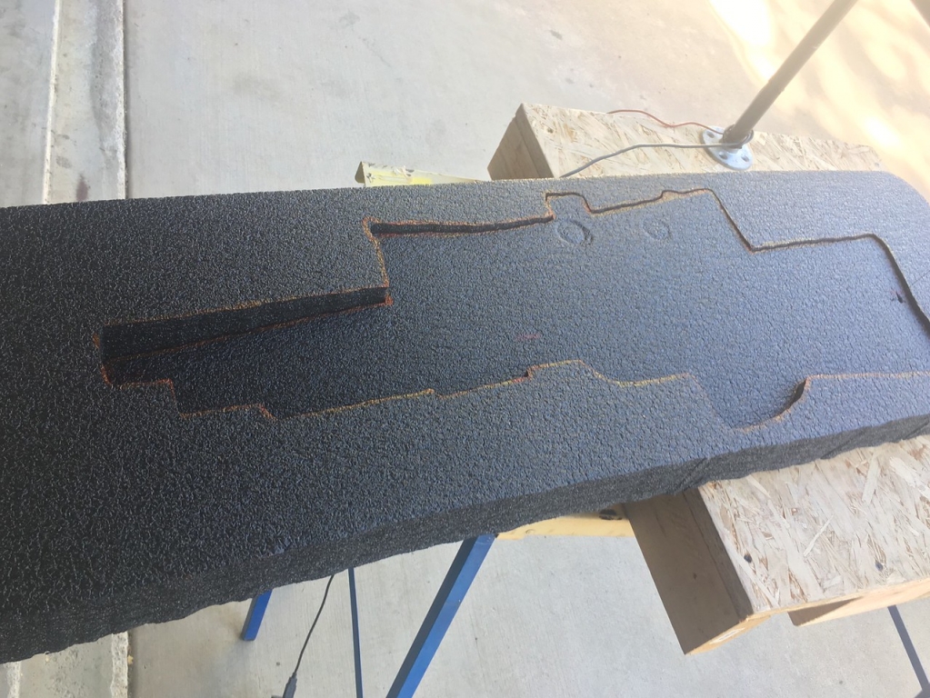

The cutting part was straightforward after a little practice. I cut as close to the inside edge of the line as I could.
The gun fits really well.
