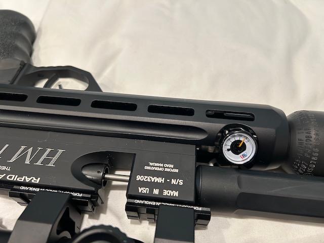

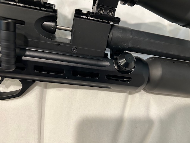

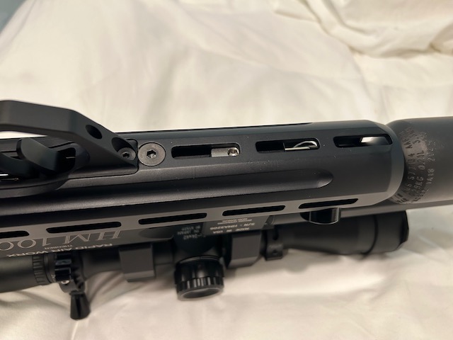

Typical .. is start unscrewing the blanking plug on bottom of receiver. Once o-ring unseats with a POP the tanks pressure is quickly diminished.
Is the blanking plug the silver screw I see under the rail? Not sure how one would get to that as the rail can be loosened but you cannot remove the rail completely without removing the air tank first.

This is the way I do it...First, unscrew the tank slowly until the oring pops and then unscrew and remove. There is a check valve in the tank, so it won't depressurize when detached. You can now remove the action from the stock. Second, point the rifle in a safe direction and cock and fire it once (or maybe twice) to release the air inside the action. You'll know its empty when air comes rushing out of the open end of the regulator where the bottle was attached. Or you can do as Scott mentioned above and slowly loosen the blanking plug on the bottom of the action and that oring will pop and release the air.
If you want to degass the tank and action say for flying or shipping this is my method. Unscrew tank and remove, pull the V Block that the gauge and fill port is attached to, it just slides off as it is oring sealed. When it comes off the spring and valve pin from the V block fill port should come out. Set the spring and pin aside, put V block back on, slowly screw bottle on and air will exit through the fill port releasing all tank pressure. Remove bottle put fill valve pin and spring back in V block and re assemble. Easy peasy, no tools needed. Dry fire just to make sure action is not pressurized...

So - is the blanking plug the silver screw under the rail in the pic above?

Yes, that large headed silver screw IS the blanking plug that was mentioned above.

Yep, the silver allen-head screw is the blanking plug, and yes the aluminum bottle has a one-way valve in it to retain air when disconnected. The male thread on the end of the aluminum tank is 1/4 BSPP. lt's close to 5/8" major diameter but not the same thread form. Some older paintball tanks for CO2 had the same size.

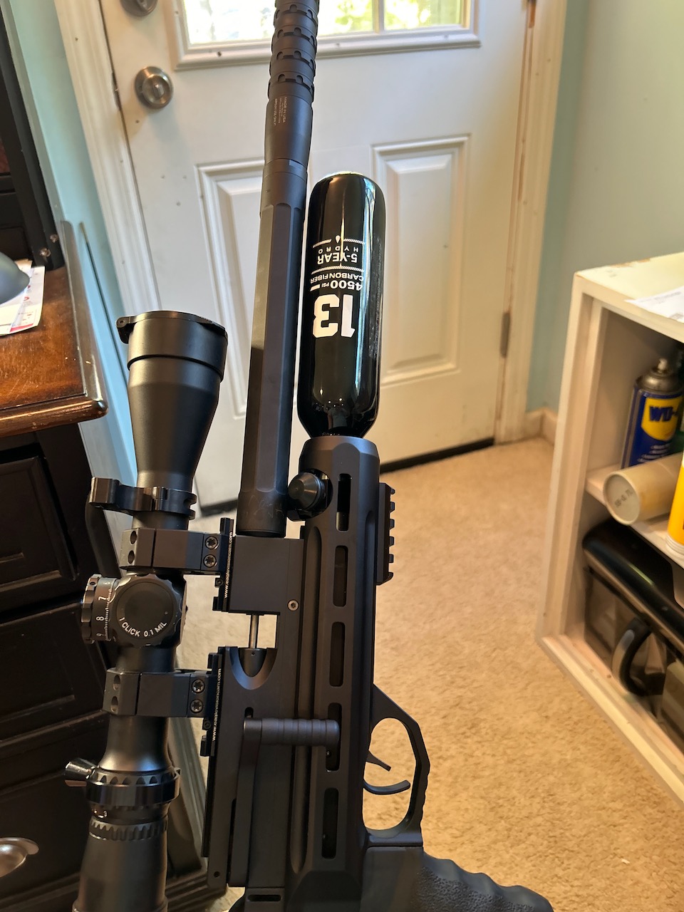

Not a problem any longer though:
Anyway - thank you for the help with degassing properly.
You are 100% correct I did so i could test if the reg would handle 250 bar, which it does just fine. I am 100% aware of the 207 bar working pressure and 310 bar test pressures of this Al bottle.
Love this! I was wondering the exact same thing. Update the improvement in shot count and anything else please. Weight difference? ANy negatives?
Well I've been using the tank since I first posted. Filling to 250 bar and seen no changes in fps or ES. Shot count is about doubled since the reg is still around 145bar.
